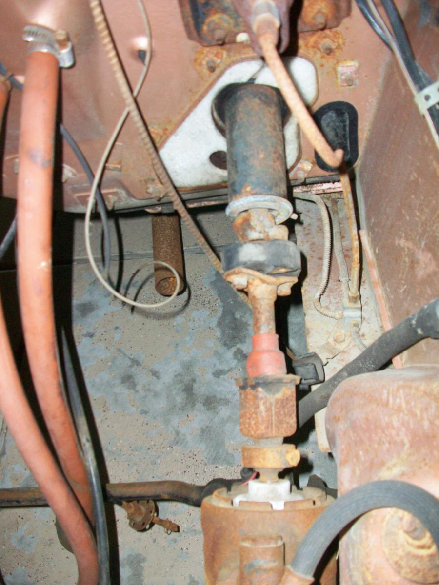

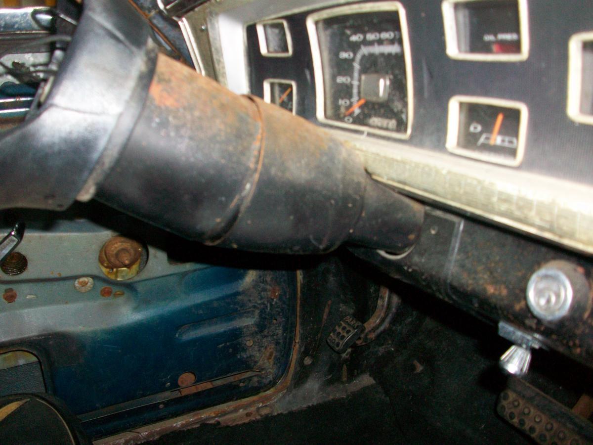

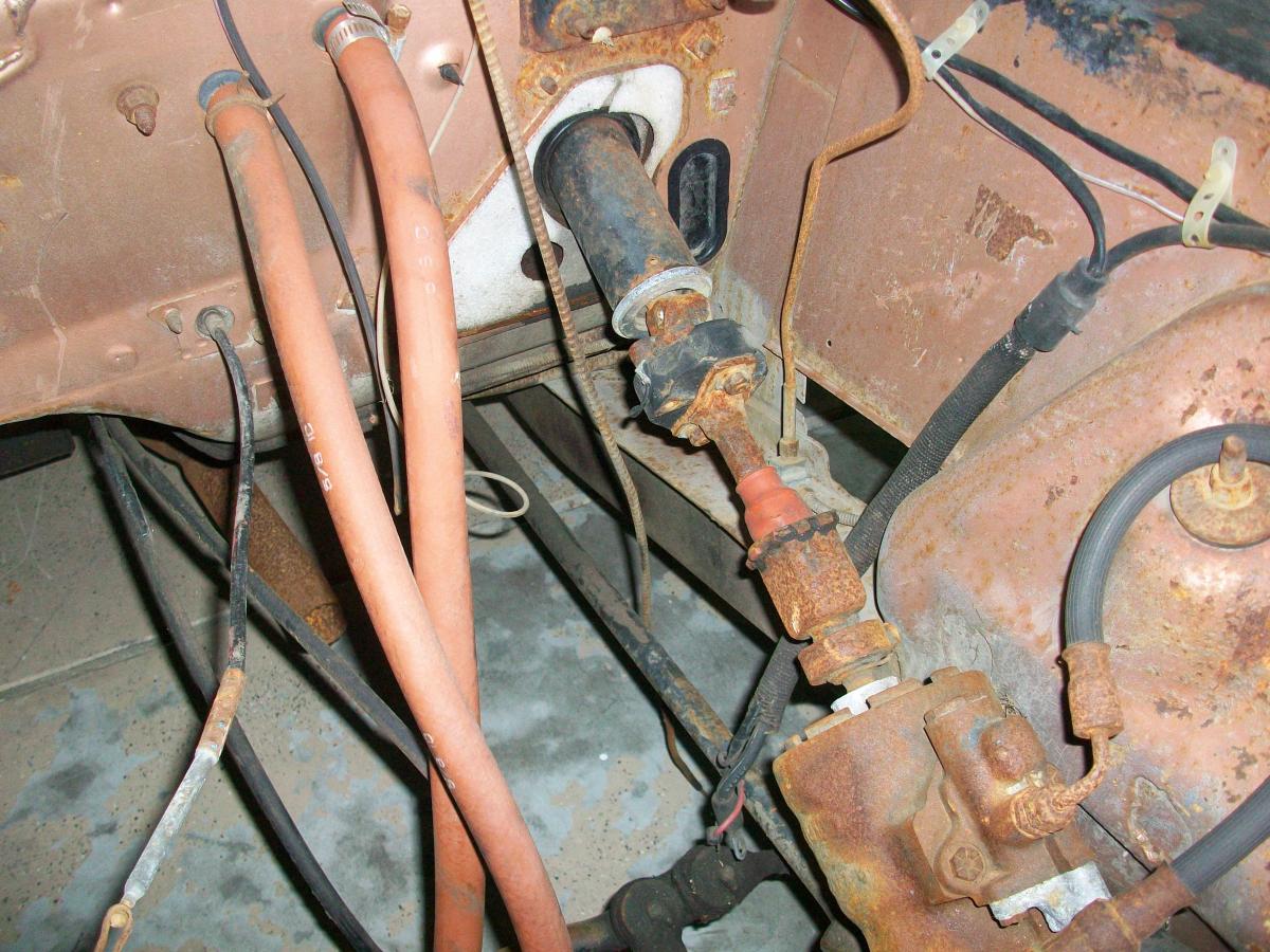

Here are a few shots....
Looks like I got a little close on a few of those pics...:)
Anyway, you guys be the judge. Like I said earlier, nothing on the fender tag indicates that it came with a tilt column but on the build sheet it reads:
STRG COL ASSY.
D Y
Anyone know what that means? Also what about the knob under the dash to the right of the column? It says "speaker" on it and it rotates like a volume knob. My other Satellite didn't have one....:confused:
Steering Column Assembly
DY?
Speaker knob might be for rear speaker volume?
If your steering is not original it was installed a long time ago. Looks right to me!
