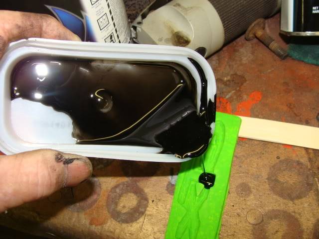

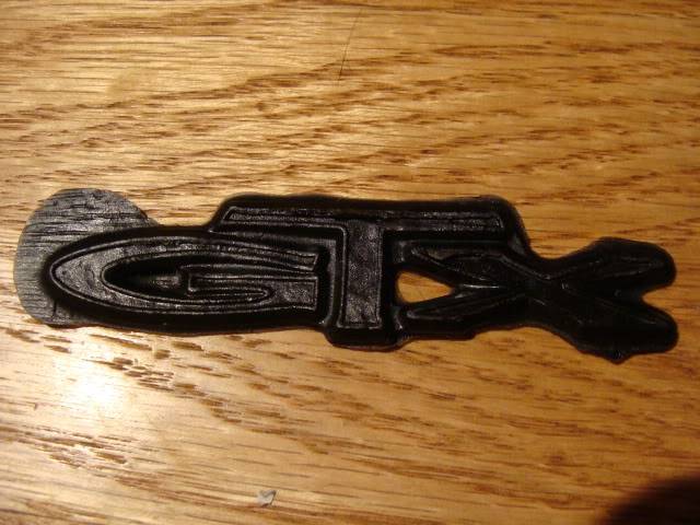

I had the same problem with the 71 GTX. My solution was to get someone to make a mold of an original with modeling clay, then I mixed some liquid fiberglass, tinted it with black model paint and filled the molds. Once dry, trim and sand to correct, then paint the red.
to get the molds, I just e-mailed people with 71's for sale on e-Bay till I got someone who would make the mold. I think it was the second person who agreed to do it once they understood the clay wasn't going to hurt thier car.
I still have the molds, and I think I've made about 20 castings so far.
