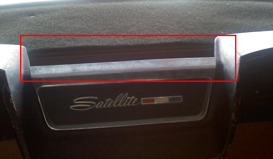

I have a 1966 Plymouth Belveder II, I am in the process of converting the upper portion of the back bench seat and addding the fiberglass surround. However when I purchased the fiberglass surround it does not fit quite as expected, so I am wondering if the 1966\67 rear dash is different or if I am missing a part as you can see from the JPG there is a large gap.
Also if anyone knows of site where I can have the 'Satellite' replaced with Belvedere, or perhaps a custom phrase feel free to comment as well.
Looks like you did not mount it far back enough...Did you mount the four studs in the fiberglass in the proper place?I mean did you have to drill holes or were they already there..The chrome satellite emblem should go over the rear package tray..Now 66 satellites did not come with this just the 67...66 satellites had different taillights than 67 too..You are not missing parts...Just needs to go back more...I,ll measure the holes on my 67 gtx so you,ll be in the ball park...The emblems came with GTX or Satellite only...Also the rear package tray has to go under the rear window rubber to be correct.

My Brothers relatively unmolested 66 Sat has this same rear set design.
IIRC, 67 GTX and both year Sat had this, Belvedere did not, so you won't find a factory "Belvedere" center section.
I suppose you could chisel off the word.and use a fender emblem.
I have not mounted yet... I will have to put in studs to connect it to, as my 66 did not have the fiberglass surround. I spoke to a buddy of mine who is a CAD guy and he thought he could design an insert that would say Belvedere.

I can sell a black fibreglass piece. (from a 67) There is two styles of top seat attachment brackets used on the Satellites. One is more 66 oriented, like a bench seat hook, but two are used. 67's are different, AND require a different seat frame
