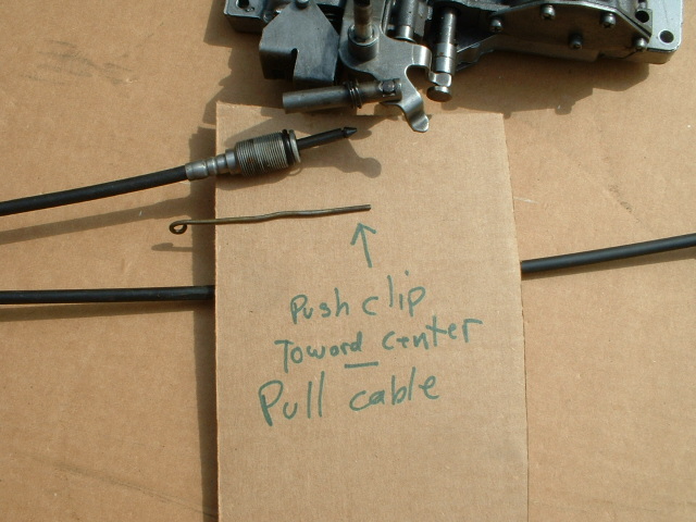

pictures worth a 1000 words
heer is what you ae looking at inside trans

This is the first cable shift 727 I've ever worked on, so the pics tell no clear story for me! In the pic below I see what looks like a, well.....something made from maybe a heavy paper clip? Then it says push clip (the paper clip?) toward center. Center of what? What is it pushing against or fitting into? Not clear from the pics since it's not actually being done.
The pics that followed made no sense to me. A socket that the cable gets pushed into maybe? Heck, I haven't even been able to get the cable end out of the case yet. Seems stuck!
I posted these photos to show you the exact INTERNAL parts you are having to 'unlatch'. I assumed it was clear that from the manual and the online hyperlink, what the big picture is. The 'paperclip' is a tool I made out of coat hanger to push on the release clip. I suggest unthreading the 2" diameter shift cable adjuster, to get a straight shot at pushing on the release clip from front of trans. The service manual SUCKs at actually showing what you need to aim at. I attempted to show what you need to aim at.
