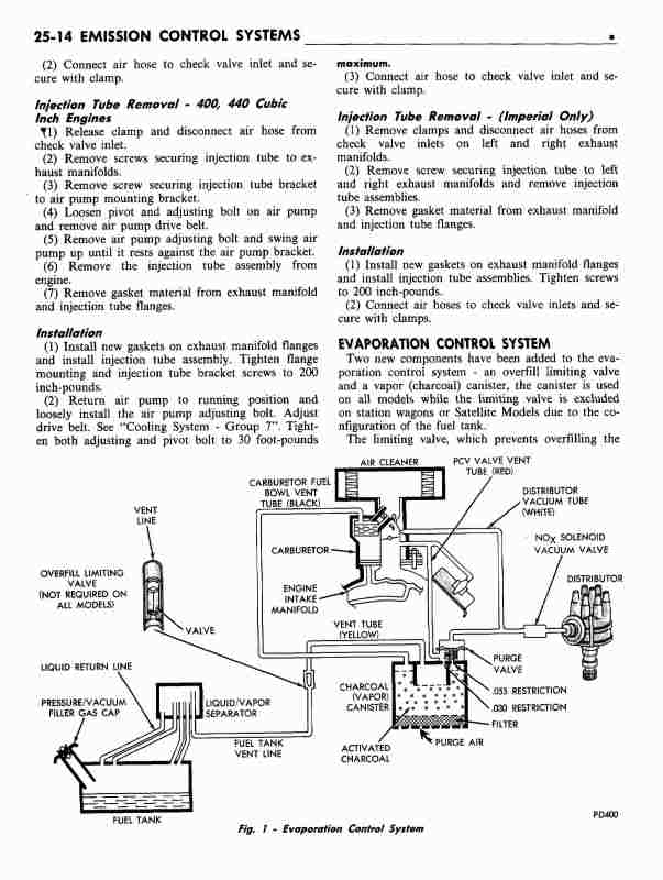

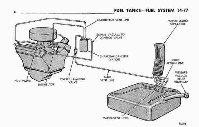

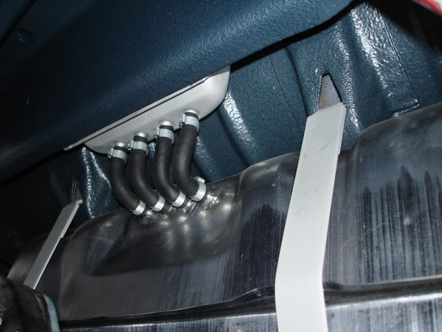

does anyone know the proper way to hook up the lines running from the driverside of the gas tank up into the fender/wheelwell? theres 4 total. 2 small ones and 2 larger ones if I recall. I believe they're emission control lines. pictures would be great! thanks
Pics of Fuel lines as requested sir :)
These may not be exact of what you wanted cause in these pics it doesnt even label the other side where the pickup is...
