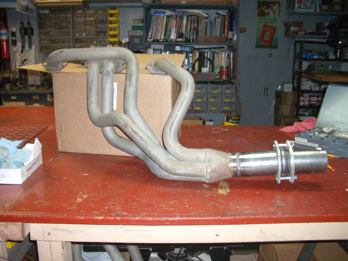

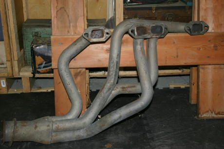

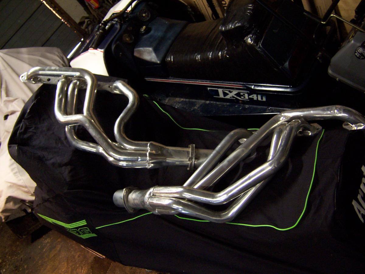

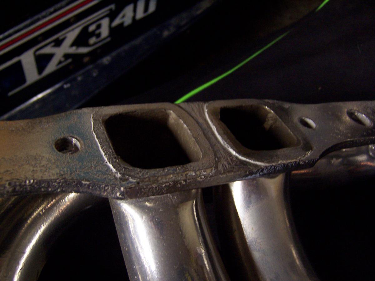

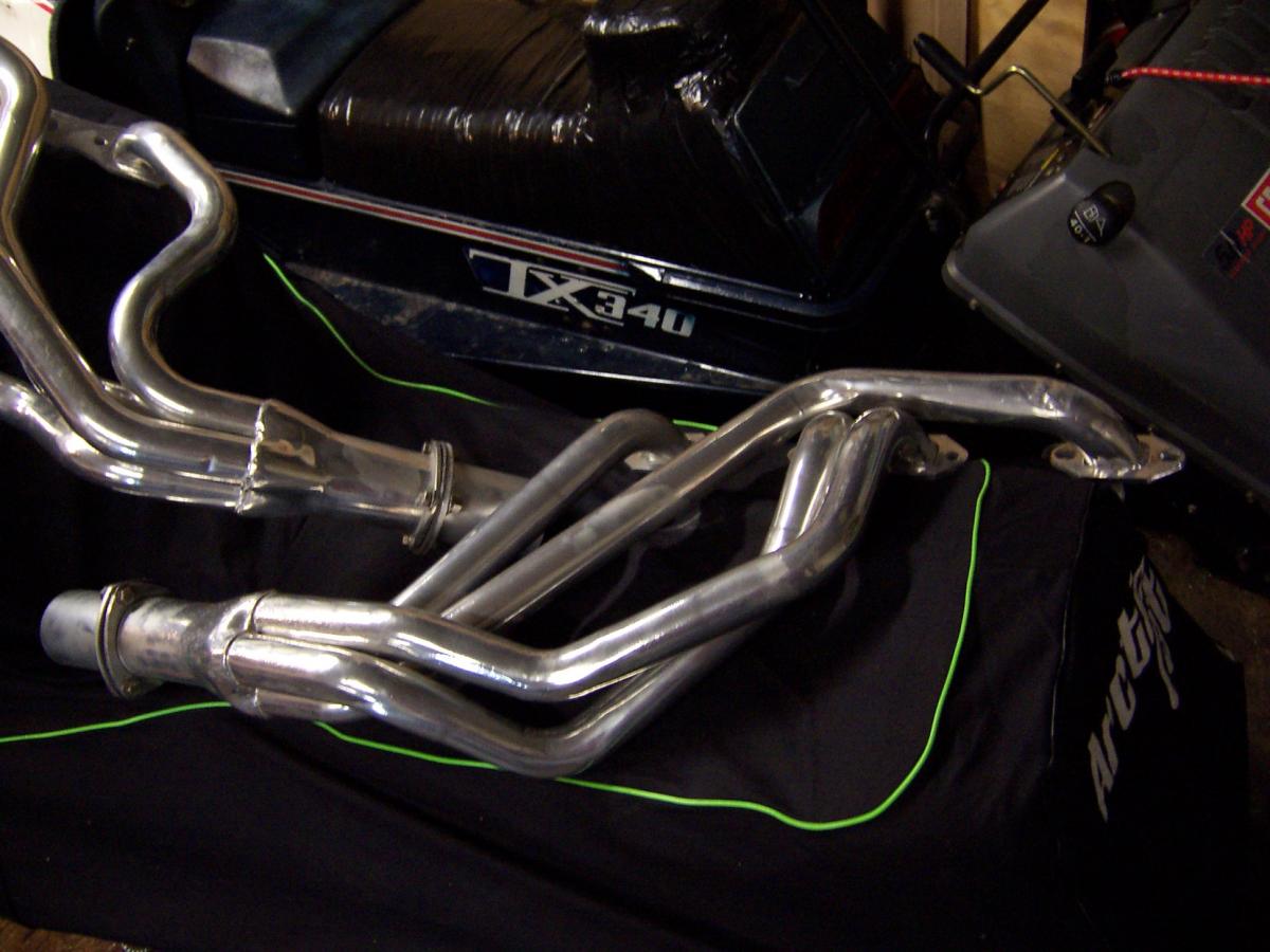

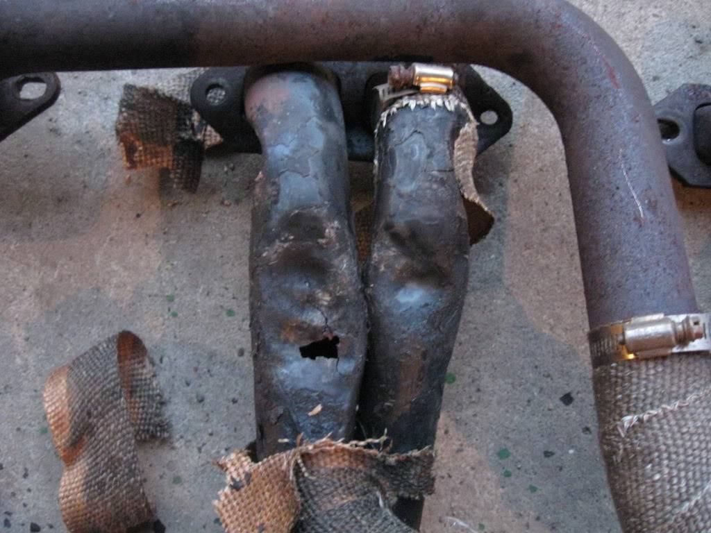

First,below are the headers I plan to install on the '64. Supposed to be Hedman's(1-3/4" o.d.);they look like their stuff. Supposed to be for 62-5 B's with a big block. OK,they look like what I've seen for that app. Are they? It's looking like I'm going to have to raise the engine,at least on the passenger side,but probably the whole mill in order to remove the old(Chrysler) manifolds. Any suggestions and tips are appreciated;this is a power steering and power brakes car as well.

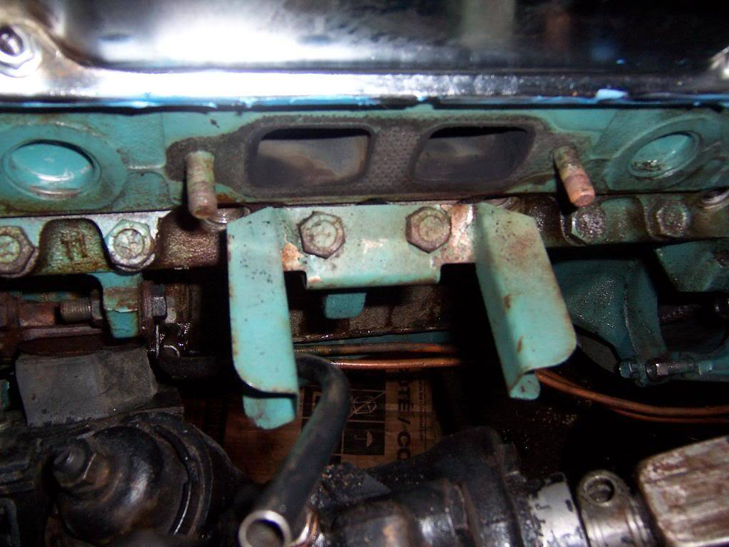

Next...Would you cats recommend getting the header flanges machined flat for a better seal? There's a bit of weld material(as can be seen) that seems would prevent a good seal. Gasket suggestions are welcome as well-thanks!

Exactly the same setup that I just removed from my '65 in favor of '68-'69 hipo manifolds. I had manual steering so I can't be sure of a power steering setup, but it will probably fit the same. It worked best in my case to remove the rocker covers because on the left side you have to work them up from the bottom with the starter at the same time, and get them over and behind the dipstick tube. No room with the rocker covers on. I also dropped the steering from the pitman and the idler arm. You have to put the starter up at the same time as it is "captured" by the headers. You can use a standard starter. Be sure to use sealant on the header bolts going in to the heads. If you have steering box work to do, do it when there is no exhaust manifolds or headers. The right side I put in from the top after removing the right engine mount bolts and jacking that side of the engine up. You may not have to do that, but it keeps things from getting scratched up. I also had to dimple the left side for the torsion bar. Take your time, be safe, and make sure that the car is in the air.
I have the BlackJack 1-3/4" headers, listed for '66-'72 B-body big block in my '65 and they fit just fine even with power steering. They go right in from the bottom. I believe they're almost identical except my flanges don't run across all four tubes.
Get the nose of the car up on jackstands as high as you can safely go.
Remove your existing manifolds and starter. Remove the nuts holding the motor mounts to the k-frame (both sides). The install is MUCH easier if you pull the steering column and it seems that my mini starter can go in after the headers are installed with the column out of the way.
Do the drivers side first. Raise that side of the engine and put in the header from the bottom up. I hung it on two bolts temporarily. Lower the engine. The passenger side goes in without raising the engine. I have a set of Remflex (thick soft graphite) gaskets that will go in afterward. Everybody I've spoken to has good things to say about them. I did true up the flanges with a large flat file just to be safe.
You DEFINITELY want to do anything you have to do with the steering box first. I don't see it coming out with the headers installed. It doesn't get in the way of the header install.
I modified my collector flanges for ball and socket type - no gaskets to blow out down there.

You also asked about the high spots on the flange,they dig into the gasket when you tighten the flange to the cylinder head:idea1:

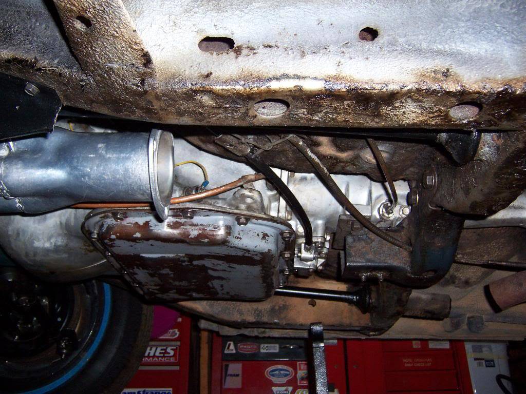

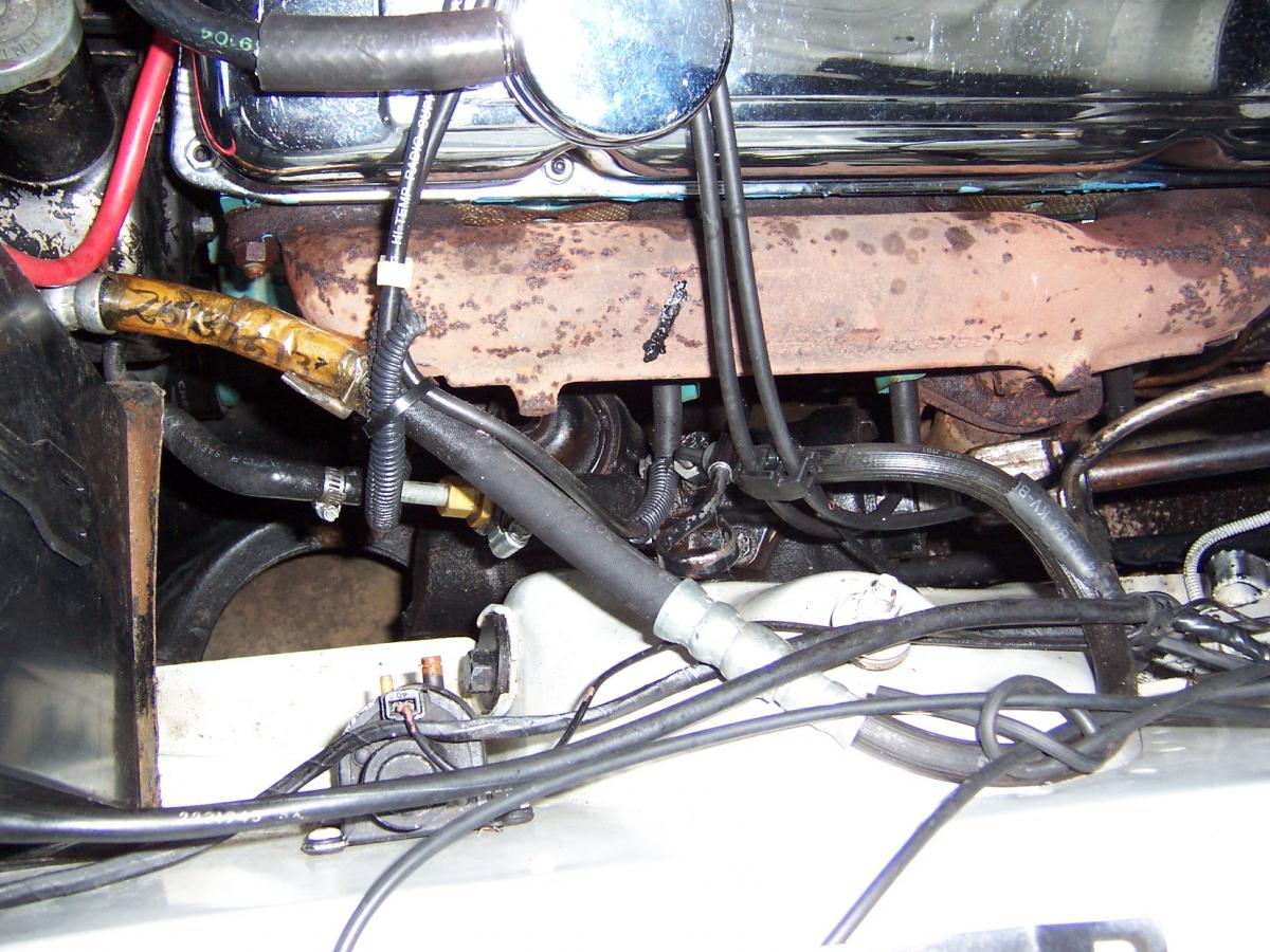

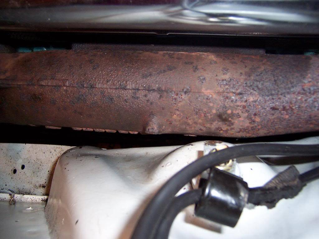

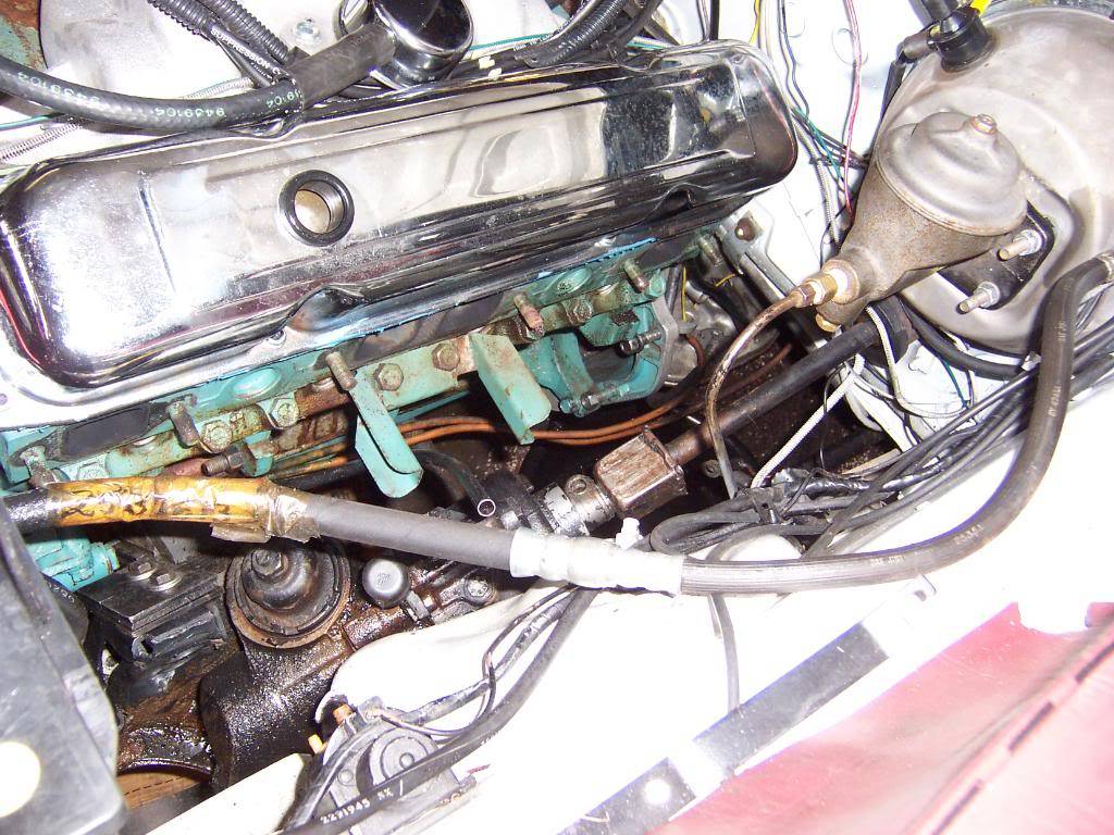

Driver's side manifold/exhaust pipe,starter removed. Because there's studs,rather than bolts holding the manifolds on,the passenger's side will require lifting the motor. Still have to disconnect the column from the box;which means removing the bracket on the firewall. No biggie? Well,I can't open the driver's door fully-seems there's this shelf full of parts-so crawling into the foot well could be an adventure. I'll call one of you guys if I get stuck,OK?
Let me get some pics(I'm taking a break now) and show you what I'm dealing with. I need a bigger garage! But,I've got one. There were many years a long time ago when all my auto work was done outside. We've all been there,so I ain't lookin' for sympathy:eusa_boohoo::eusa_boohoo::eusa_boohoo:...
We have pics! This might help in the advice(for which I'm very appreciative-THANK YOU!) department.
First: To remove the plug shields requires removing two head bolts from each head;can I just remove them,remove the shields and replace the bolts and torque back to 70lbs/ft.? If not,what do you recommend?
Second;it also looks the engine is going up to 1)remove the pass. side manifold,and 2)of course,install the header. Where is the safest place to lift the mill? I'll be using a floor jack and probably wooden blocks,and would like to use a jackstand to hold it up and get the floor jack out of my way.
It's also looking like the trans dipstick may have to come off,and maybe the engine tube as well.

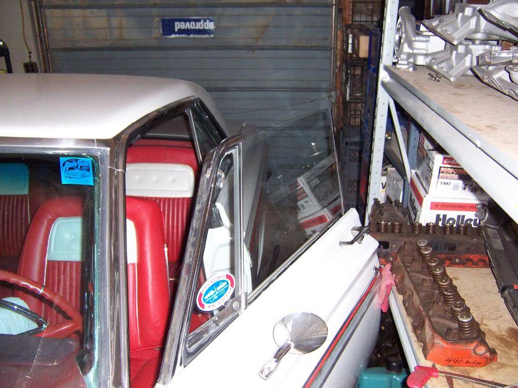

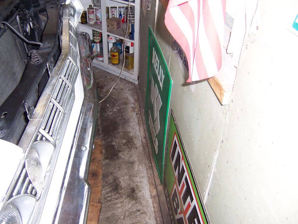

I had considered my engine hoist;no room to get it in the garage. Working space is somewhat,uh...limited:
Like I said;it could be worse. I could be outside...Oh wait;I might have room to move! Oh wait;it's supposed to rain like a bee-otch in the next couple of days. I'll stay inside,thank you.

Hey Al I'll do you a favor and take them signs in the front of your car off your hands. That should gain you some extra work space.:icon_axe:
Joe;they don't take up THAT much room! The nails that hold them there are a pain in the ***. And arms. And back. And... You should have seen the pre-divorce collection. That was nice...

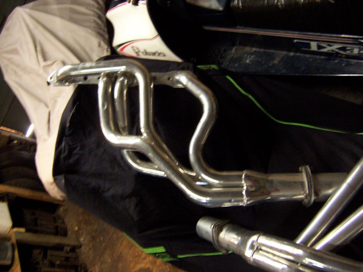

Well,the steering box is in;heavy,but went in fairly easily. Haven't raised the mill yet. Took the driver's side header and without the starter,it went in so-o-o-o easy. OK,let's try it while installing the starter. Bad word time! On top of that,the #1 and #5 pipes are,or will be touching the starter. No hammers;but it's looking like mini-starter time. If I recall(must activate brain!),the preferred unit is a Dodge Dakota/360 engine piece-is that a "mini-"starter? Is it the right one? Or is there something else? I had the starter and header knock my noggin(that effin' hurts!) falling out of position. Ain't going there again. I haven't disconnected the center-link;looks like I may have to.

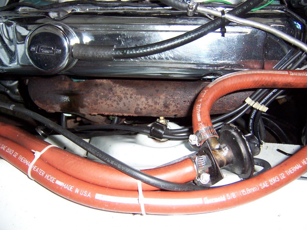

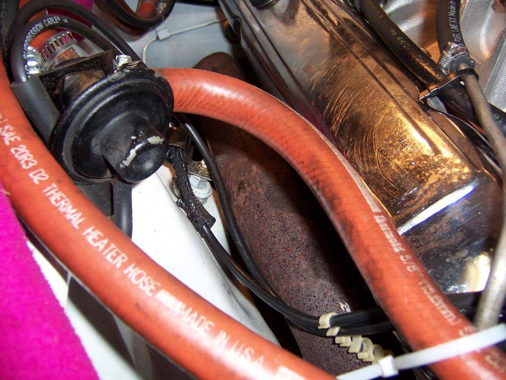

As far as the passenger's side;I will have to raise the motor,even to get the old manifold off. I'd like to keep the studs in there,but could go the bolt route on that side if necessary. The studs aren't really a problem on the driver's side,clearance-wise.

Back in the day.....I found that cutting the flanges between the pipes drasticly cut down on gasket leaks. Anyone still do that? Those shown above look like they're made that way. Cool.
YY1;I had one side with a full flange and one side with the separate flanges. I don't know why... A little hacksaw work on the driver's side,and they're identical now.

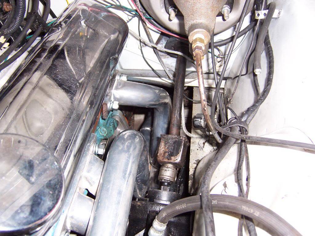

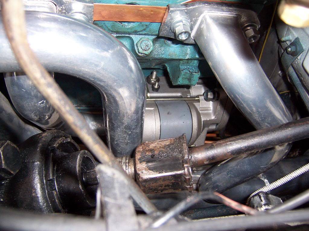

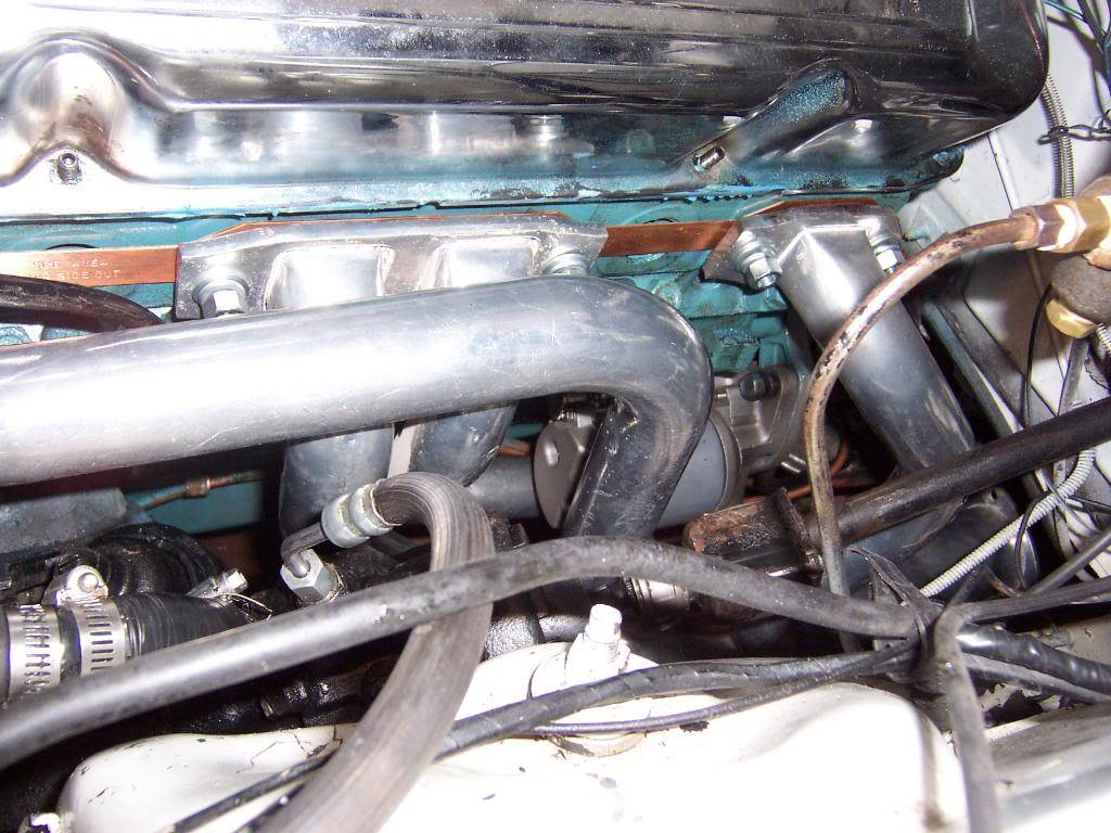

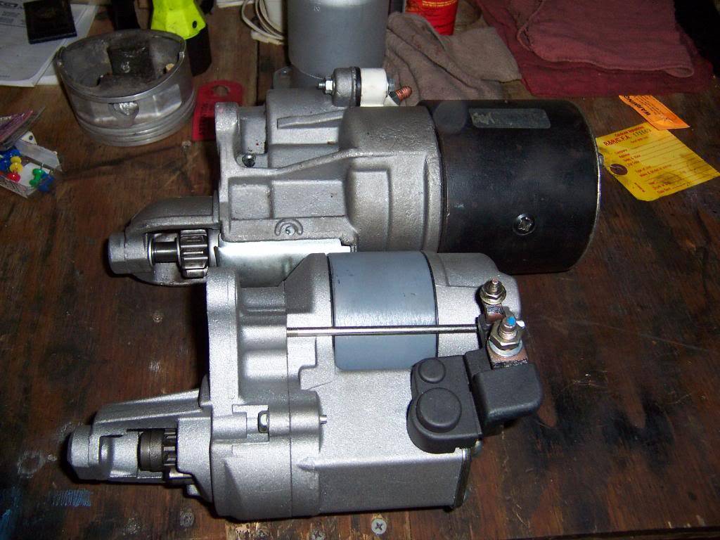

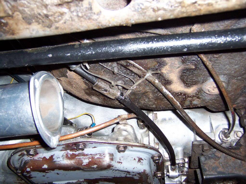

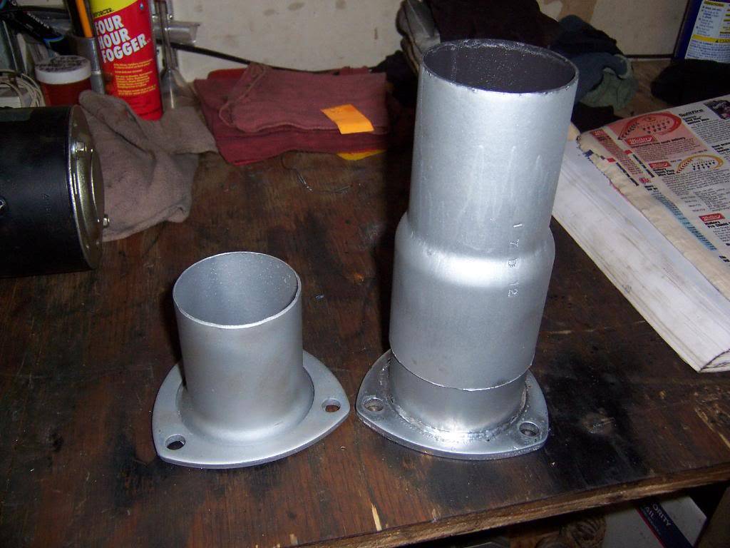

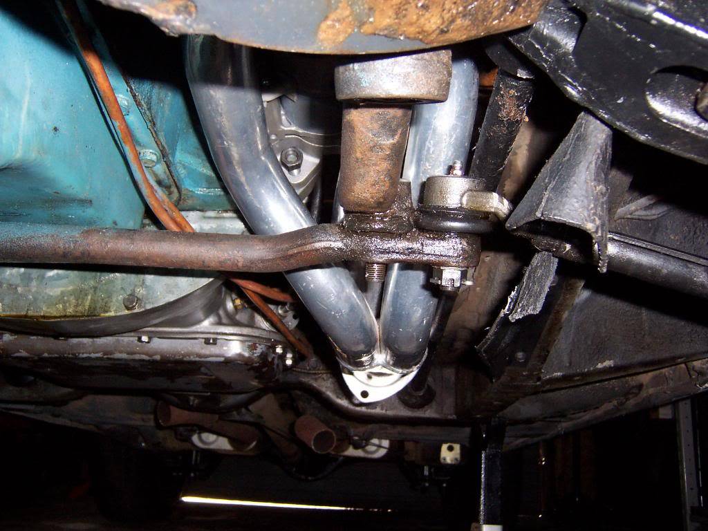

So,I get the starter,and it wouldn't go on properly. A tip from HEMI-ITIS helped tremendously,and now both the starter and header are on(the driver's side,anyway),and here's some pics and tips:
First,the starter;there's a plastic terminal that's attached to the solenoid that needs to be removed-that was my interference issue mentioned in my "Mini-starter" thread.
Remove that,and the unit falls right into place. I laid under the car,feet forward,and after getting the header and starter held together,slipped them into place. Yes,they DO have to go in together. I did not have to remove the centerlink;just placed the collector on my chest as I worked the starter into place. Once it was there and secured,the header itself was pulled into place from the top.
More than enough clearance. Though not tightened down yet,I don't foresee any other serious clearance issues.

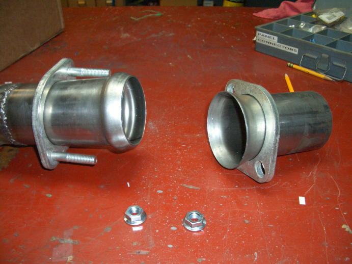

However...When it came time to put the collector adapter in place,I found out that the one I wanted to use(3" with a 3" t0 2.5" adapter slid over it) won't work.
Looks like the short one will have to be used. These pipes don't hang down(I like that),but because of the tight fit to the floor,and the placement of the crossmember notches,I'll have to place an "S" bend immediately after the short collector adapter to connect to the existing exhaust system.
Not a difficult job,and I thank ALL of you for your help and advice. Now,on to the passenger side pipes. I'm going to try and just raise that side;carefully,of course,and see if I can get the old manifold off and the new pipes on. Of course,I'll have questions,and you'll have answers and balance will be maintained in the universe...
THANKS AGAIN!!!
