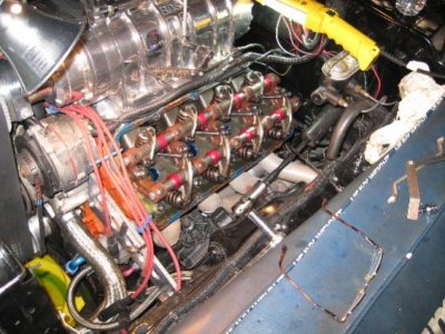

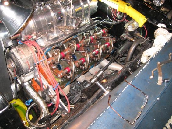

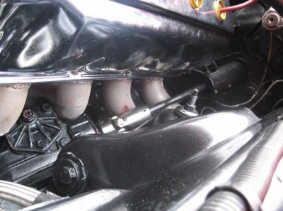

If any of you are running Flamming River Steering adapters, are you using the universal $62.00 one or the $186.00 Flamming River mopar adapter?
If you have pictures of our steering shaft can you post them?
Thanks
Kevin
Here ya go Kev:sleepy2:

Al, It looks like you're using the Flamming River mopar adapter. I can't figure out why a regular adapter is $62.00 yet the mopar adapter is $180.00. Did you just pin it or did you weld it?

Used the roll pin.It's a beefy joint.We all know I like a beefy joint:icon_syda:
