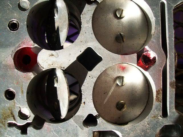

Well, since (according to you) I don't know what I am talking about, I thought I might disagree.....There are a few holes in your theory -if you will refer to the pic below you will see two red areas- these are where the front and back ports feed from
The right one is the secondary , left primary- you will note they both pull from beneath the throttle blades meaning NEITHER one is ported. They are both drilled straight thru with no mechanism to close them at any throttle setting. Also, there are at least two methods of plumbing a pcv system- one is to the carb/intake from the pcv with an open breather on the other cover, referred to as an open system, the other uses a tube to the air cleaner instead of an open breather, referred to as a closed system. At WOT there is little to no vacuum (with a properly sized carb). The PCV valve is weighted or spring loaded and designed to close in no vacuum situations ( such as engine turned off) and depending on amount of vacuum, varies the amount of blowby passed. The closed system allows the gas to back flow thru the aircleaner at low vacuum situations (such as wide open throttle)- in a high performance engine this allows for some scavenging due to the slight vacuum created by high velocity in the aircleaner ( and is better for the enviroment if that is a concern) By design and placement the valve is designed to control oil and if your valve covers are properly baffled , there should be no liquid oil flowing anyway- I also like to plumb PCV or vacuum pump systems from the front of the valve cover since under acceleration, the oil will naturally try to go to the back. Also, the front port is a fixed size and the rear one can be fitted with a variety of nipples thereby allowing it to be sized to the hose used if necessary...hope this allows you to understand my stupidity....

I have modified literally hundreds of these carbs for everything from street, to drag and circle track- there is no metering valve in the front- it is drilled sideways and down to the red space just like the rear- the accelerator pump squirter passages are directly above there- I did not say Eddy's instructions are wrong, but I don't like a bunch of hoses in the front- it looks messy.....IF there are power brakes it may be debatable to hook the brakes and PCV to the back, but otherwise the ports function exactly the same
fugly is correct it can go in the front or the rear on the large port. the pcv valve is the vac regulation not the port if you are sucking oil from the engine then your pcv valve is located improper or valve not baffled proper or the oil is being trapped in were the pcv is located. the pcv valve shuts itself off when the vac level in the manifold get below a value in the pcv. just about all brake booster line come from a runner in the manifold but they can be installed at the base of the carb.
