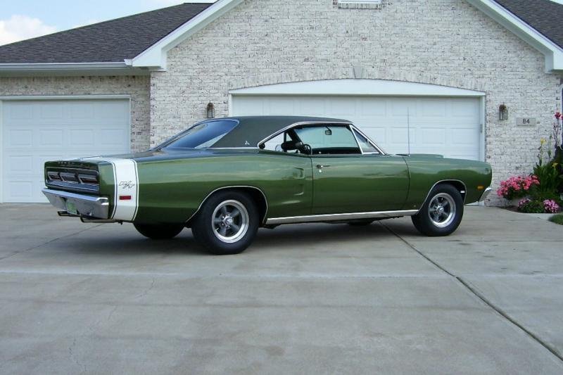

I have 225/70/15 with 7' rims on the front of a 69 Road Runner. They fit fine and are a good match to 275/60/15 on the rears.
