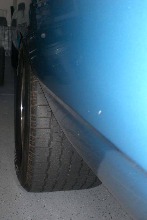

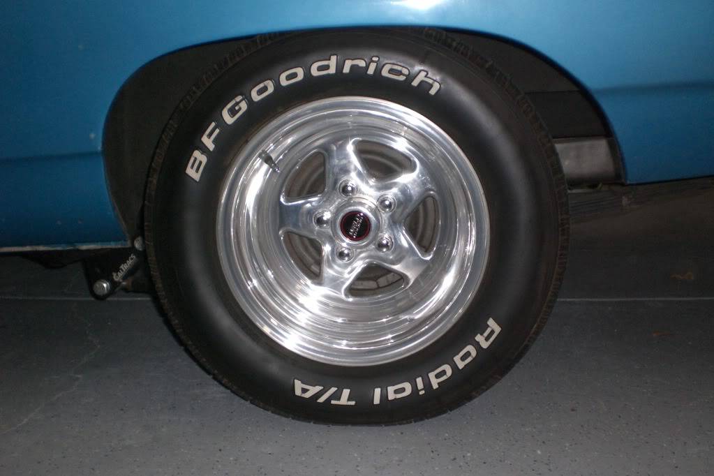

I don't think that backspacing will work. I have 10 inch rims with 275/60/15s and 5.5 backspacing and they fit perfect on my 70. I think they will stick out too far

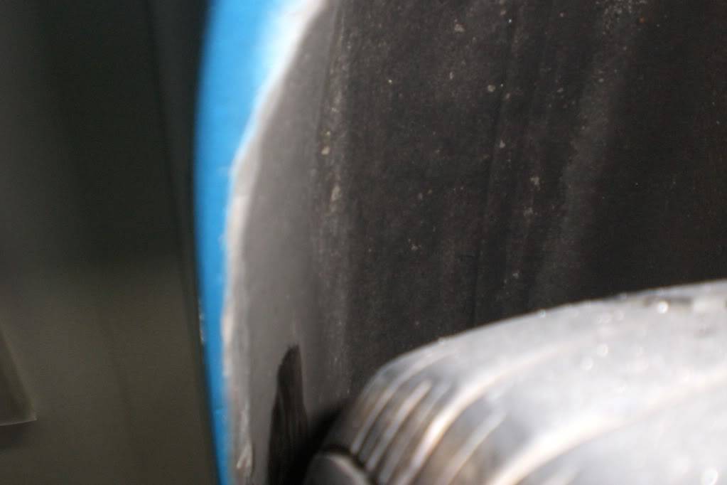

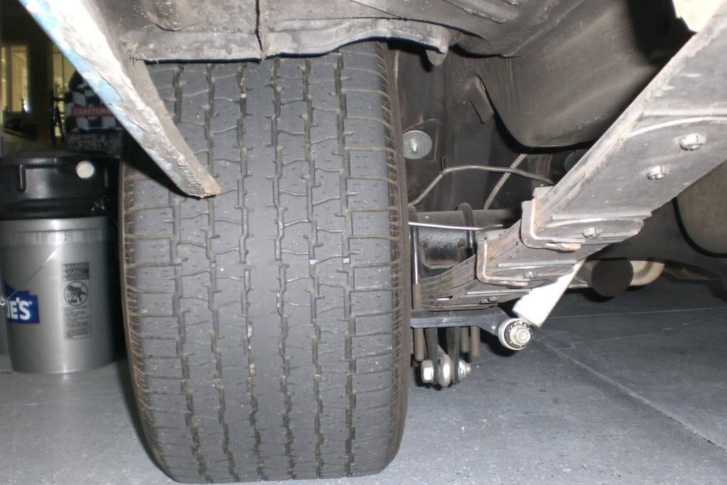

Kd I have 10" prostars with 295/50/15's on my 69 roadrunner with a 4.5 inch back space and with the inner lip rolled they fit perfect. I did have some rubbing up in the wheel well on big bumps and people in the back. But I put on some calvert traction bars and it lifted the rear a good couple of inches to get the clearence I needed. Hope this helps man.
Any improvement with those Cal-Tracs vs the old pinion snubber trick?
A world of difference man! Nothing but solid plant, and they look good too!
