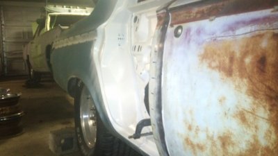

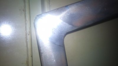

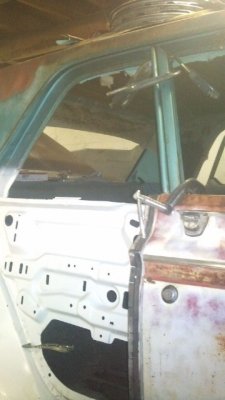

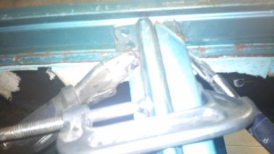

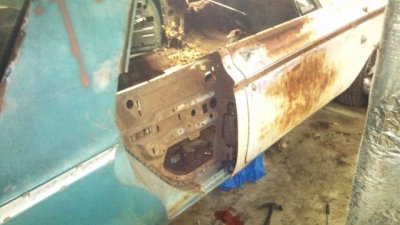

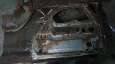

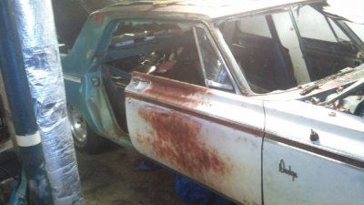

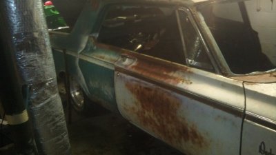

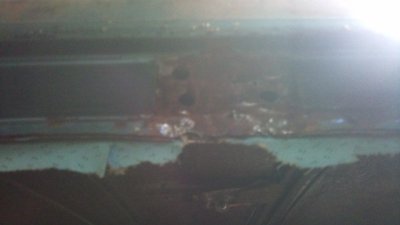

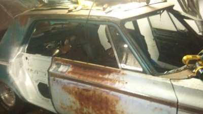

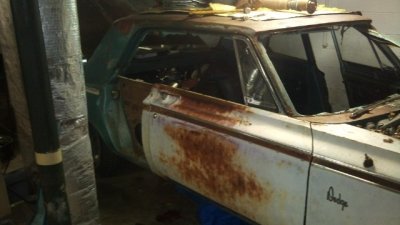

1964 dodge 2 door conversion
brandon64
11:39 PM
Apr 19, 2011
380
13
old hickory, TN

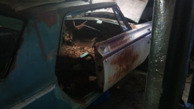

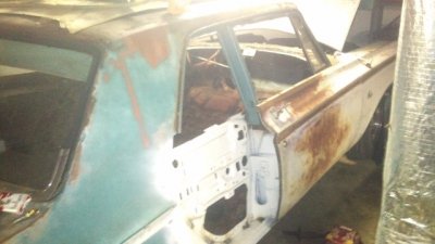

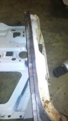

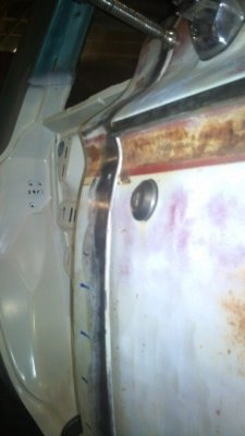

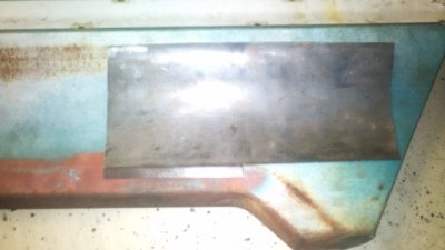

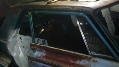

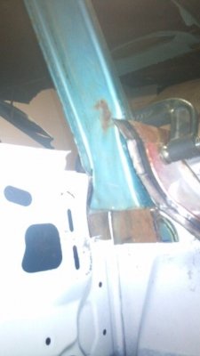

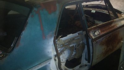

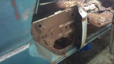

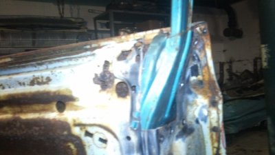

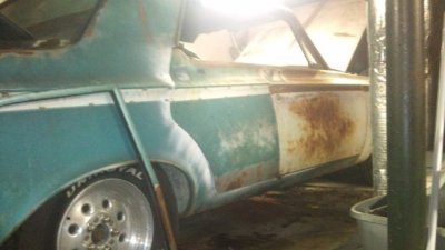

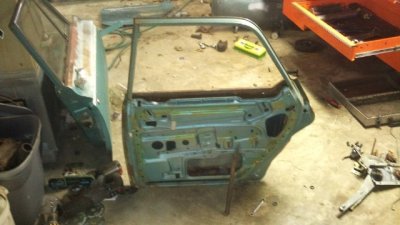

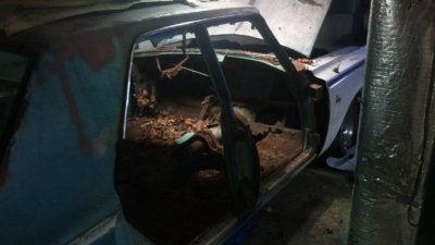

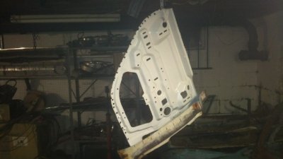

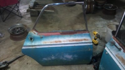

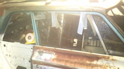

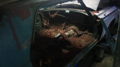

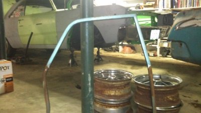

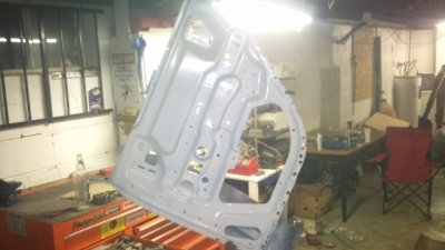

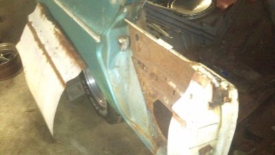

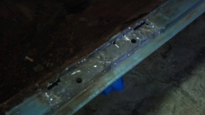

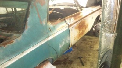

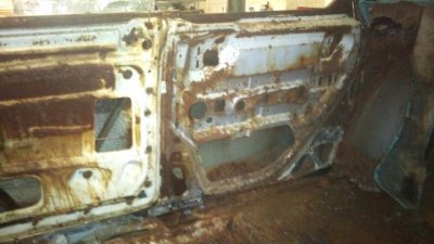

I started the conversion this morning, I got the doors pulled, the B-pillar removed and the new door hung on the passenger side. Now for the hard part lol. The progress on this project will be slow, it is my first time doing one, and I don't have alot of spare time. Tonight I plan on staying up late and trimming the 1/4 panel and fitting it to the car.

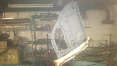

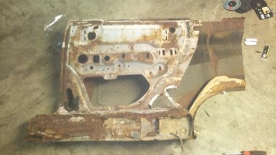

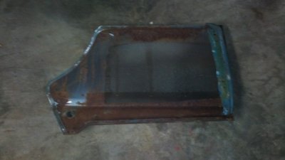

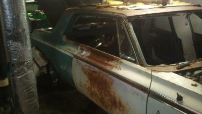

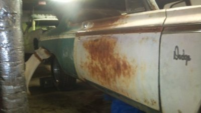

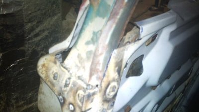

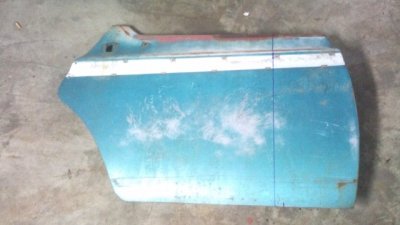

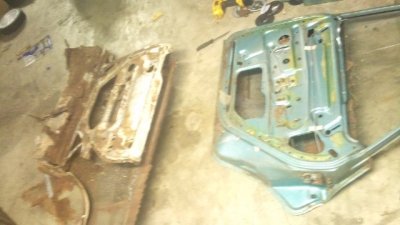

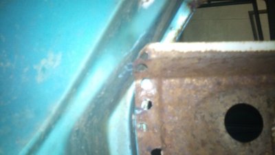

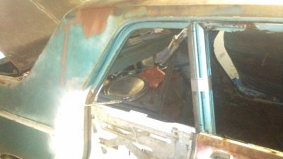

I've made a good bit of progress. I decided on using the rear door as the filler panel for the 1/4. It's much less rusty, and its already shaped to fit. Last night I drilled all the spot welds off of the piece I cut from the donor car and removed the inner panel and the door jam from it. Today I trimmed it where it would line up with the door correctly, and I gutted the rear door. Removed the window channel piece from it, and cut the skin off of it. I have it marked and ready to cut but the battery went dead on the saw. As soon as it's charged, I'll be back at it again. I hope to have everything fitted, have the inside sanded and painted and ready to weld in by the end of the day, I'll post some more pics tomorrow.

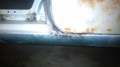

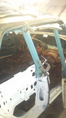

I spent some time this evening fitting/trimming and aligning everything. It looks pretty good. I also sanded and painted the rear part of the door jam on the car. And I cut the door handle raised portion on the rear door skin and cut a patch panel for it from the 2 door 1/4. I'll bring the door skin and patch panel to work tomorrow and weld it in on my lunch break. I ordered the parts I need to build a phase converter so I can hook up my welder but they have not came in yet. If they don't come in this week, I'll see if I can borrow the welder from work and get this side finished.

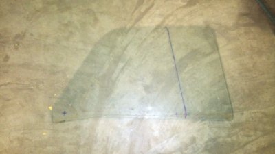

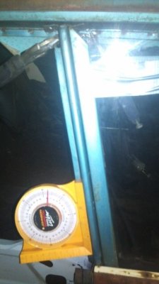

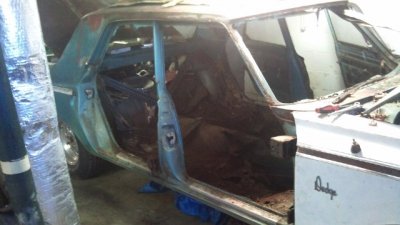

Today I cut the B pillar down and fitted it to the car. I found that the drivers door had it's glass intact, so I pulled it and stuck it in the passenger side. So I found that the window channel needs 7 1/2 inches to be added, and the B pillar sits 12 degrees rearward of vertical. I got everything tacked in place and the door still lines up well and opens/shuts beautifully. I also got the rear window channel cut down and mocked up, and I installed the rear window mechanism from the two door hard top. I think it will work but I'm not sure, I'm going to try and cut the 4 door rear glass down and see if I can bolt it in and make it roll up and down.
Total money spent = -$195
Total time spent = 32 hours

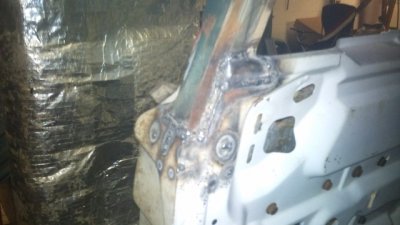

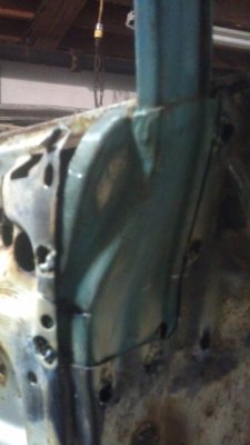

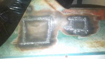

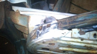

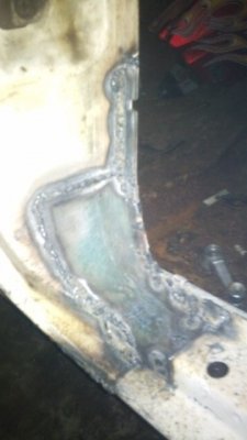

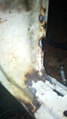

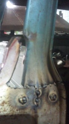

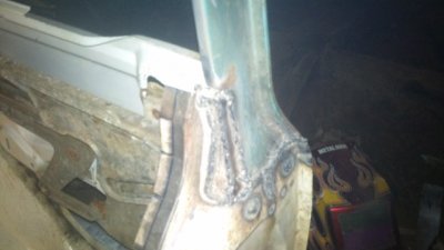

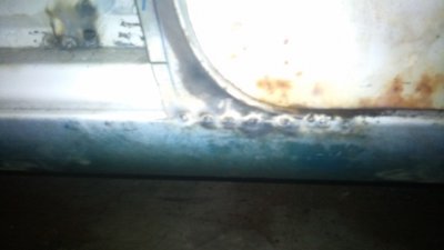

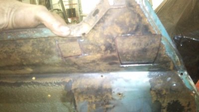

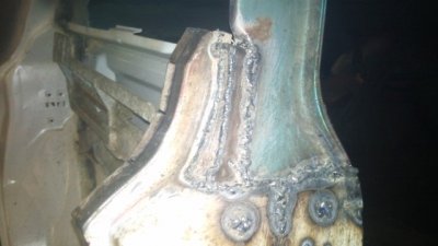

I got the 1/4 window channel fitted and welded together, and I got the B pillar all the way welded in. I had to piece together the middle part where it meets the door jam. And I patched some bad rust at the lower part where it meets the rocker.
Money spent = -$180
Time spent = 41 hours
