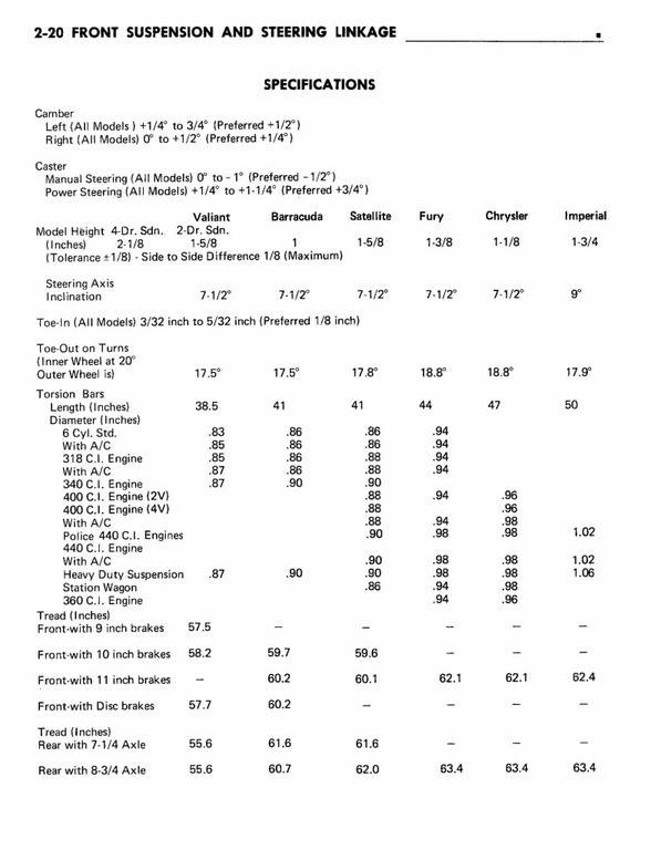

Can you elaborate on your response to this question please? The OP inquired about more up to date alignment specs for these cars running more up to date components as I understood the question. The 40 year old factory specs are far from performance oriented.
A quick check of the 71&72’ FSMs show the same factory specs for both years and “all” models. From the 72' Factory Service Manual, 71' FSM shows the same specs.
The specs I quoted were directly from a 1973 Motor's Auto Repair Manual. The chart you posted doesn't say what year. Since I was doing front suspension and alignment work from the bias ply tire through the implementation of the radial tire. I know from experience that the specs are the same no matter what tire you are running. I also know from experience that on caster and camber anywhere inside limits was good and would not cause tire wear or road wonder as long as you had the same setting on both sides. As far as toe in goes you better get it as close to 1/8 inch in as you could because very little variance will cause inner or outter tread wear. Too much in causes outter tread wear, too much out causes inner tread wear. As far as what you show here, whats your bitch. looks to me like the factory just didn't go into as much detail as what one of the best, if not the best motor manuals ever printed did. And the steering geometry of these cars didn't change just because the parts got better. As far as I know with more than 20 years in the business and performing alignments on thousands of cars the specs have never changed.

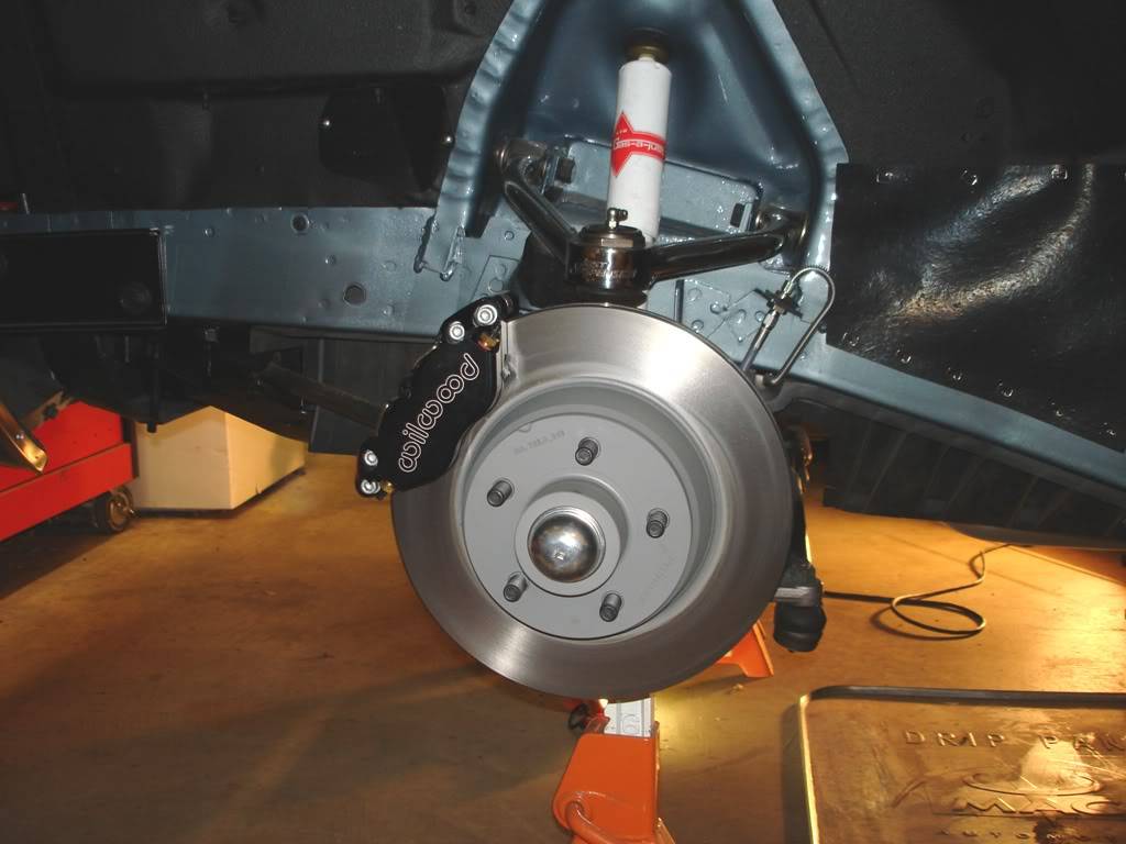

“What’s my bitch?” really? No bitch, simply requesting clarification on your advice to use the original specs on a question about more performance oriented alignment specs for these specific cars. Agreed, tire type not a really a huge factor, but there are ways to alter the non-tire wearing specs to improve handling and “road feel” without any other adverse effects. With factory suspension components however there will be limitations as to how far outside the factory specs, if at all, you can go. In my dealership experience (almost 40 years now) aligning countless numbers of these cars back then, achieving even the factory specs could be a challenge sometimes and compromises had to be made. For the less experienced, basically, get as much positive caster as you can evenly, side to side, that the desired camber will allow. Today, there are aftermarket parts like (adjustable or fixed with built in additional positive caster) upper control arms and/or adjustable LCA struts are available for this specific purpose. Offset UCA bushings are also available for use with factory UCAs.

Running about 3 degrees positive caster and ¼ degree negative camber on this one.
As I said, the geometry on the front end hasn't changed. So the specs are the same. The after market parts of which you speak are used, as you say, when for some reason you can't get your settings inside the spec limits. I have never in my experience used those parts. When a vehicle was that far out of spec. we would determine if any suspension parts were bent and if none were found, put it on a frame machine to get it back into the spec limits. Then back to the alignment rack for fine tuning. I was looking at the picture you posted. Thats just a tubular upper control arm, made to the same specs as an original. The only difference is it's not stamped out of a flat piece of steel. It even uses an original type ball joint. Why would you need any other spec. for that? By your reasoning cars with sway bars would have a different spec. than cars without a swaybar. One more time. If you don't change the steering geometry of the vehicle, you don't need to change the specification.
Clearly you are a bit out of touch with the advancements that have taken place over the years on this subject. Take another look at the Mopar Action article linked above and or the additional links at the bottom of this post. Fact is, the particular upper control arms pictured above is not tubular in construction and was not built to same specs as the original stamped UCAs. Like most other aftermarket UCAs on the market today, most of them being tubular in construction, besides the other advantages over the stamped steel factory UCAs, the upper ball joint is located slightly aft of the original specs to provide additional caster for improved stability over the 45+year old factory design. Not to correct for the inability to achieve factory specs using factory parts for whatever reason.
