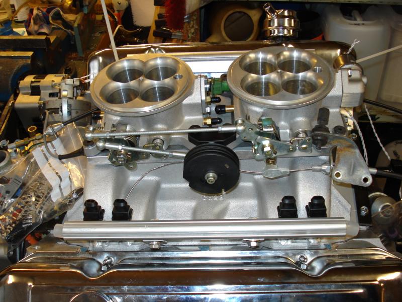

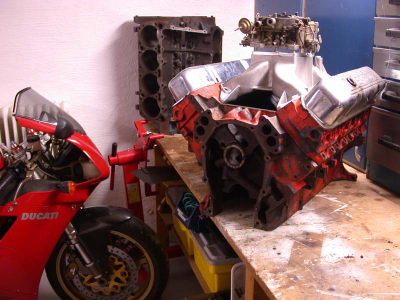

Now that is a sweet looking engine, what is it going into?
Gezz Rick I bet you want that kit in your hot little hands don't ya LOL
AL
Johan, I would say your engine will purr like a kitten at idle and roar like a lion at full throttle,more on the build?
Hey Al, I had to put on my bib to catch the drool.
Sweet.. Love to hear that, Nice EFI setup!
What do you have there?
Beautiful setup Johan, what throttle bodies and intake do you have there?
Is it a complete kit with electronics and hardware?
I'm not starting my EFI project until next winter...that's going to be fun...!
Martin i Norrland
Hi.
It is holley 1000cfm bodys and edel CH28 with homemade injectorfittings. Homemade adaptorplate. At this moment no porting in the intake.
Compcams camshaft or Hughes camshaft. Harlan sharp RR. 440 source heads with some bowl work and special valveseats. Stroker 4.250. EFI tecnologi ECU. Homemade wiringharness. Hooker 1 7/8 headers. 3" ex.
Martin. Where in norrland.
Very nice Swede! Is it batch-fire, or MPSFI? If it is MPSFI, how did you do the camshaft position sensor? I would like to something similar, but omit the dizzy, and use a LS setup. Thanks for the tip about EFI Technology, I hadn't heard of them, but I like what I just read on their site. Good-luck, and a smooth start-up to you!
Hi
Dont know what mpsfi is. I will use the dist for igniton and 8injector drivers. A smal hallsensor on the backside of the dist but dont think i will use it. I can tune each cylinder with fuel but not ignition.. The mecanical fuelpump will fill a smal can with a highpressurpump. All EFI parts can be removed and a carb and dist can go back in.:hello2:

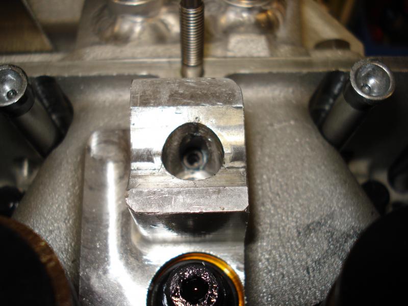

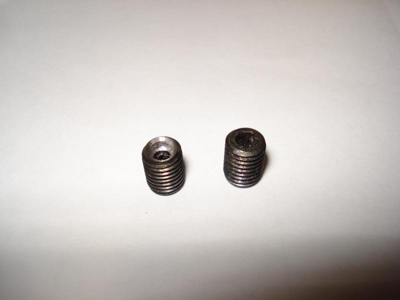

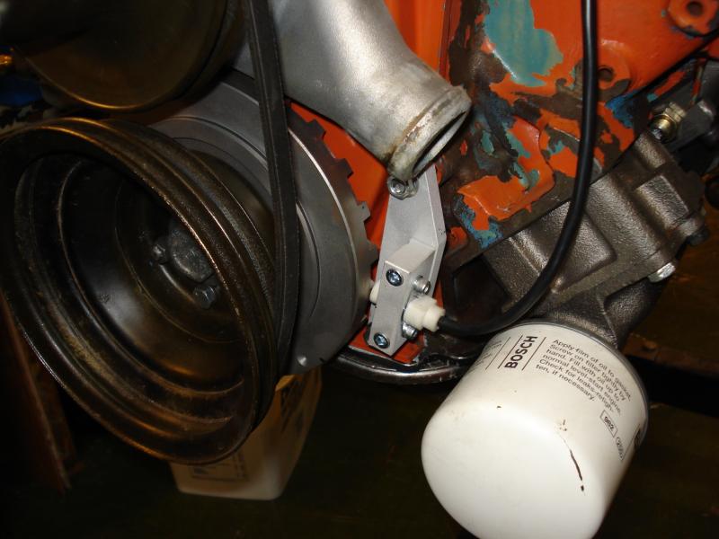

My way to reduce the oilflow to the heads. Dont know how small holes i can get away with. These ar 2.5mm or 0.098".
Johan,
Andy Finkbeiner writes in his book "How to build max-performance Mopar big-blocks" on page 35 that a 0.060 inch diam restrictor is a god starting point when using full time oiling. If you don't have full time oiling you probably may need the bigger holes...I'm guessing...
Martin
I found that in his book. Thanks anyway. In my way you only have to remove the rockershafts to change the restrictor. Also done the block of from the camshaft and the oil comes directly from the big liftersupply. Hope it will work.

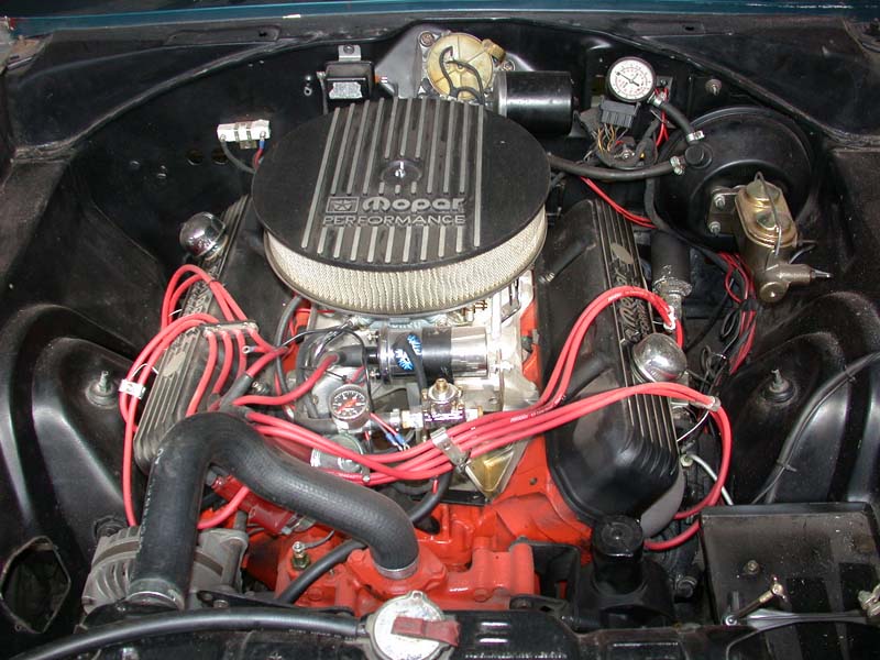

Photos...

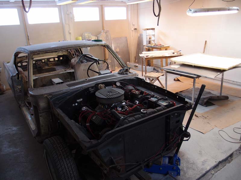

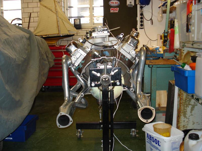

Hi Johan, I will have my car (Charger 67) ready for the road this summer...I'm almost certain...:eusa_dance:
I'm uploading a few photos, showing the original 383 4-bbl, now lightly tuned. Two pics showing my garage, and the final picture showing next winters project...a stroker with full computer control of injection/ignition/boost/fuel/launch...
Cheers,
Martin
