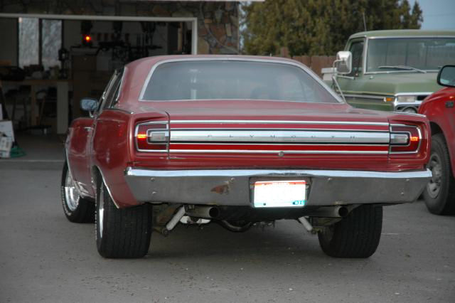

I've got 15 x 10's with zero offset on the back of my '68 Satellite with 295/50-15 BFG radial TA's. It's a pretty tight fit but it works. If memory serves they are about 1/2" from the outside fender lip and about 3/4" from the inside of the wheel well/leaf spring. It looks good pretty good but I'd like a little taller tire at some point...thinking 275/60-15's. Before you do anything you better do some careful measurements to make sure zero offset is right for your car. If you need we could compare axle dimensions.

Here are a couple pics of my Satellite. To answer the engine question, no, I built a .030 over 360 with ARP main studs with a windage tray, with recon stock rods with ARP bolts and cheapo SpeedPro pistons. I've got a Comp XE262 cam in it with bone stock '78 360 heads shaved .025. Compression is around 9:1 topped with a Professional Products Cross Wind intake, 1" 4 hole spacer and a Edelbrock 750 AFB. I've got cheapo headers, Flowmaster 40's and 2-1/2" pipes all the way back. What do you have in yours?
