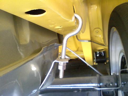

I have to agree.... The j-bolt that year one sells is the wrong one, I know I bought it and it didn't fit. I attached a pic(i hope) that shows what the correct j-bolt looks like. I was lucky and found one for sale on E-bay. Good luck.
Yep, that's the correct 66-67 piece. Thanks for the great picture, as it saves me from having to get underneath my 66 Coronet 500 to shoot a picture! :grin

Actually no, that isn't the correct J-bolt. I have one on my '66 and my dad's
'66 has the same one mine has. I am away from home till May 17th, but can and will take a picture if needed, but the picture of the "hook" is not the correct bolt.

Here is the correct j-bolt for the '66-'67 B-bodies. This is exactly what my car has.
onephat66 thats what we have on 68-70 b bodies with 2 straps on the tank. so if thats what you and your father have from the factory maybe there is more than one style for 66-67???
We actually only have one of the bolts on each car, but the picture has two in it. The '66-'67's have a single strap with the j-bolt attaching on the passenger side.
I agree with Mech440, the curved ? style is the only one that will work on the '67 single gas tank strap end. The ones that are straight with the button will not reach the end of the strap. MY original '67 GTX has the ? style ones.
