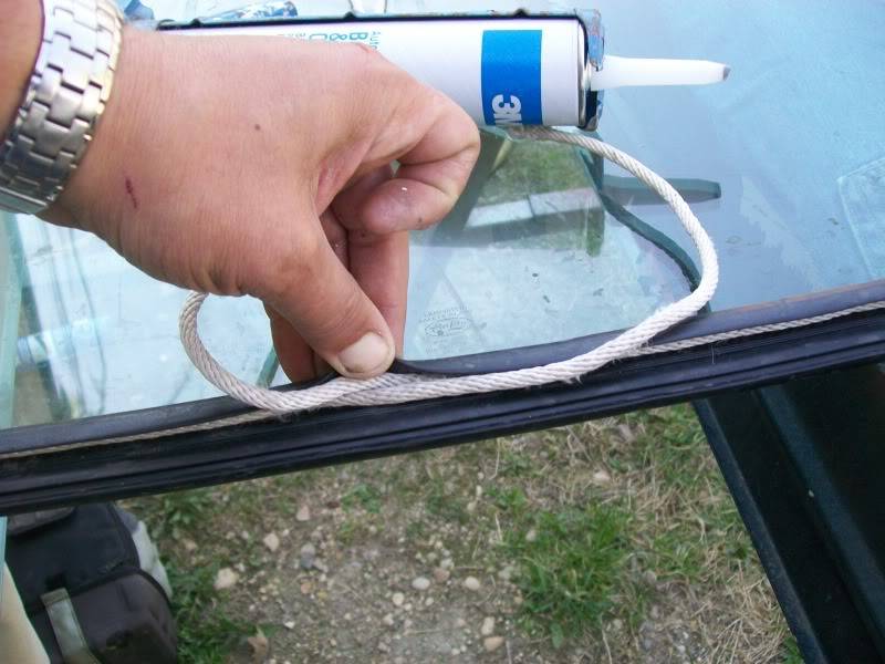

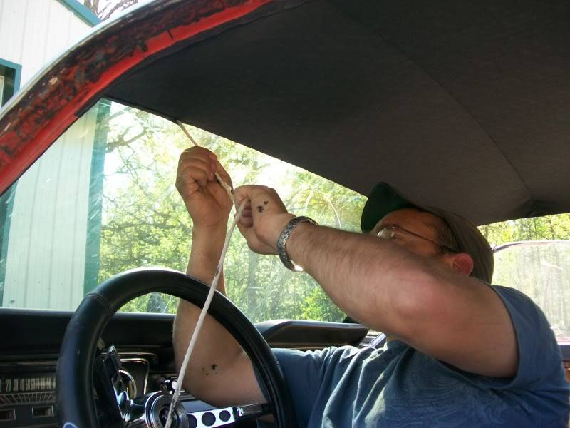

I have put a few gasket style windshields in before, easiest I ever did was on my daughter's 65 mustang.

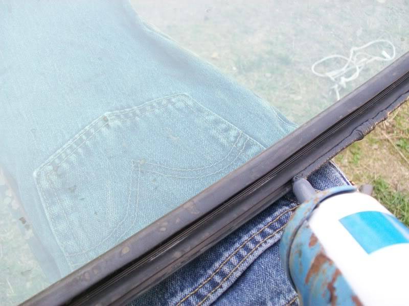

I fit the gasket to the glass first, then ran a 1/4" rope in the groove all the way around and overlapped the rope tails at thebottom center of the windshield and taped the rope tails to the inside of the glass so the rope didn't fall out while setting the glass in place.
here's my pull rope

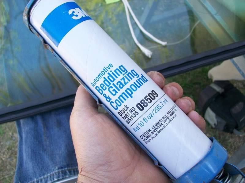

bedding compound
They had a nice groove for the initial application of bedding compound which is recomended for this particular application.

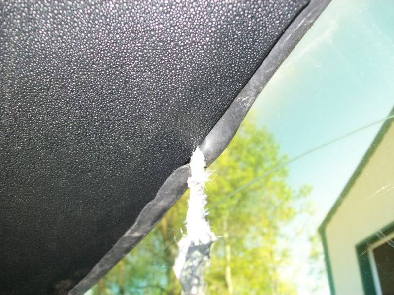

I set the bottom edge of the gasket in place first and then leaned the glass in to rest against the window tray/opening. Then I centered the glass left and right and begain pulling the inner gasket lip into the inside of the pinch welded gasket flange. Top corners are tricky, they always are. and it goes better with 2 people, one to apply a little hand pressure outside of the car and one to pull the rope inside the car.
I know our B-Bodies are a little different than this but the basic rope trick is good if it applies.
