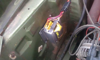

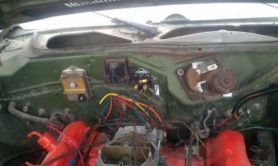

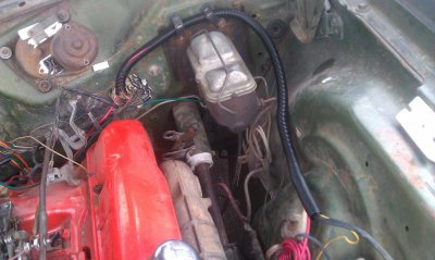

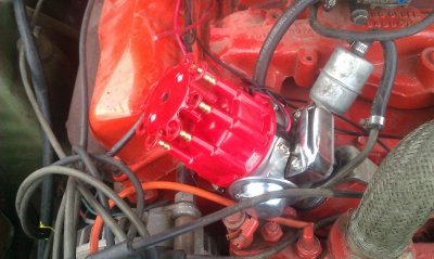

ok here are the pix of the dizzy installed and the coil. as well as a relay that i am using to feed all the components. i figured the stock wiring harness wasnt designed to run all of this stuff. hopefully i didnt disconnect the voltage regulator.

wires look good and the dist too.Sucks you can't work on your car at the barracks.
so i installed the coil today... and it went up in smoke... i used a relay to hook it straight to the battery... i thought that this was a 12v coil... so i have no idea why it burned up any ideas???
if it is a universal coil do i need to run the balast resistor since i am running an hei dizzy?
