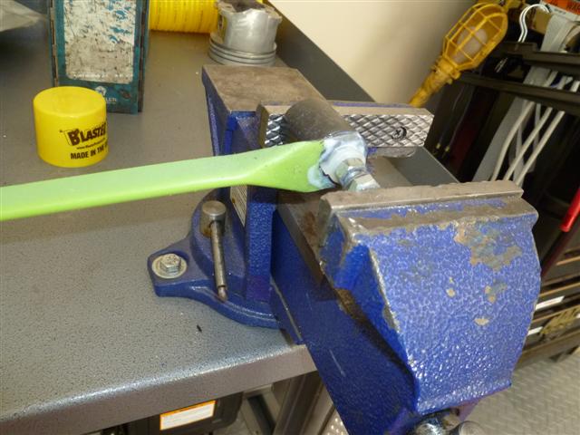

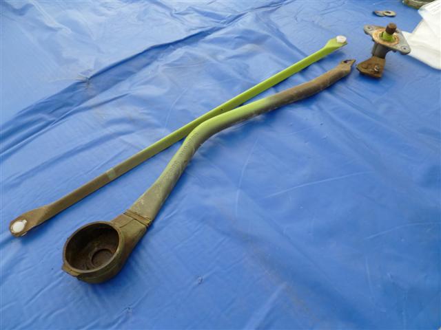

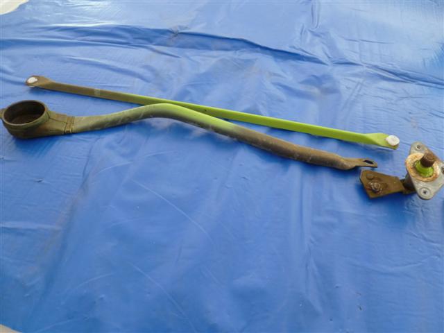

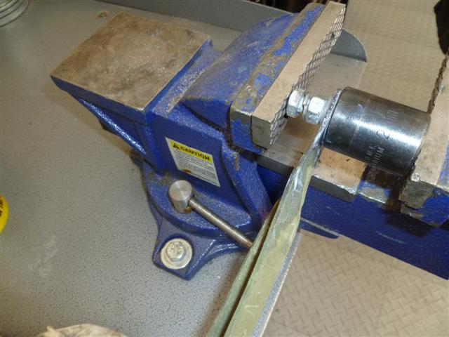

Just did this repair a couple of months ago. It was not much fun but got er done. Removed both linkage arms and the drivers side pivot only. Used a bolt that fit snug in the bushing with a nut for spacing. Used a vise to press together. Only screwed up one bushing when doing the press work at the vise. Make sure you have extra bushings just in case. The drivers pivot was a big pita to get hooked-up, some blood lost but thats cars. Heres some pix, hope it helps.
BeepIn'
I also mounted both arms to the left pivot then installed. Very big pita to get the pivot bolted back in. Hope that helps Snoman.
