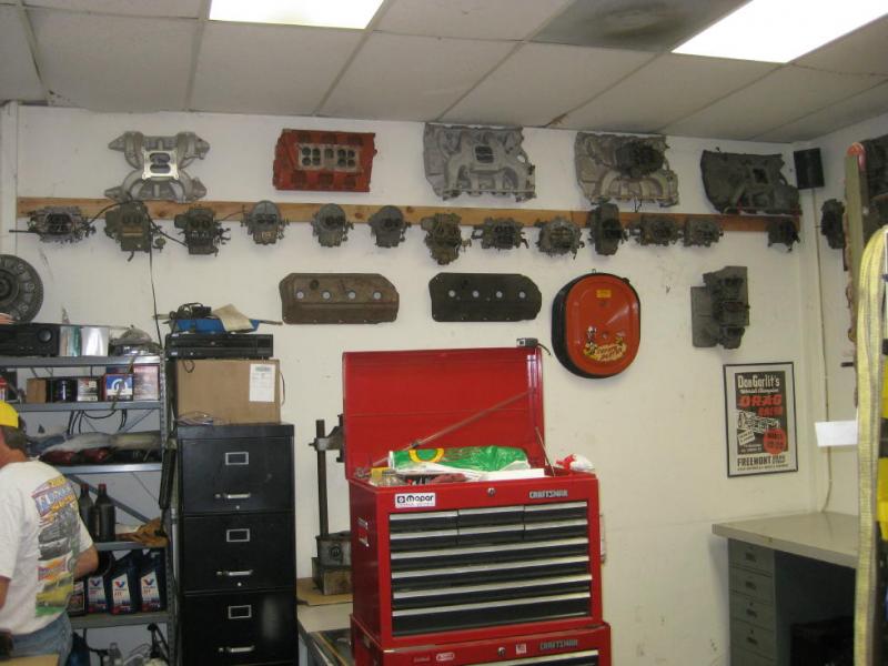

Meeps did you change accel. pumps or cams or Discharge nozzles/squirter's ?? I had a similar issue on my 383/479-6bbl combo, I went to a 50cc pump, a pink cam & a #31 squirter w/hollow screw & a Quickfuel adjustable metering block with 2 x #66 jets, 4.5 power valve, Promax rear adjustable metering plate with 2 x #84 & 2 x #80 jets staggered on the outboard carbs, with stock vacuum diaphragm springs, w/K&N 3" 6bbl filter, no stumble at all now, I needed to fatten her up even, it had a very slight lean surge at higher speeds in 3rd gear {I think anyway, it might have been plug wires or coil too, cars sold a while back, I kept the 6bbl hood & manifold/carbs for my current 68 RR HT}, I do use a Aeromotive S/S 170gpm electric pump {not any mechanical fuel pump} mounted down low by the frame rear rails, with #6 line feeding the carbs, a large 16oz Aeromotive canister filter before the electric pump, feed by a Mancini Racing 3/8" pick-up/fuel sending unit, in the new Mancini Racing stock style 19gal fuel tank, then a Holley Bypass style fuel regulator & gauge, about a foot, from the front fitting for the stock type 6bbl fuel-inlet lines, set at 7psi flowing with a #4 return line, all the way back to the tank, thru the original 1/4" evap canister nipple on the sending unit @ the tank, this same set up fat on my little 383ci @ 0.040" over 276*/284* with 0.520"/0.545" hyd. roller & 1.6:1 Crane Super Gold Roller Rockers, 10:1 near zero deck w/valve relieved, with original 68 block & "mildly ported", mostly just pocket work, on Edelbrock RPM 84cc Aluminum heads, it runs great, pulls freaken' hard thru all gears, even up-to about 6000-6200rpm, haven't tried to go past that in 1st & second, doesn't need to, for my little engine combo haven't got the little engine combo to the track yet... I don't know if this will help your combo at all, I've had a ton of 6BBL's this is by-far the best running combo I've done to date, {I wish I had an 383/400 STR-w/6bbl top, to try it on}, this combo went 9.77et @ 135mph in my old RR 3520#'s plus my 250#'s, at Sacramento Raceway test & tune, a while ago now, 100* day with a corrected alt. of something like 1500-1800ft, with more "solid roller" camshaft & a similar 383/479ci 11.0:1 flat top, w/Ported Eddy RPM's 80cc/320+cfm combo, 1-7/8 TTI #383178c headers w/custom merge 4-2-1 x 3" collectors, thru 3" mandrel bent tubing w/H-pipe installed 20" from the collectors & Flowmaster "Delta Flow 50" exhaust out the rear, 727 w/3800rpm stall, 3.91:1 gears, CalTracs & old crappy M/T P315/50 drag Radials, 4pt cage/roll Bar was my limiting factor, outdated harness, as soon as they saw I only had a 4pt cage/roll Bar, they said "enough, no more faster than 11.50's" or I had to leave....
