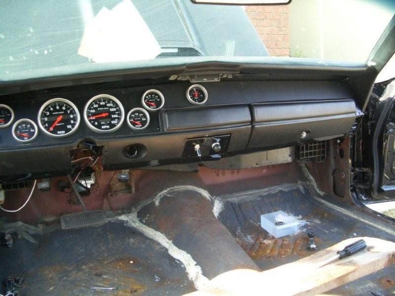

Hey, made a little more progress on the GTX. Here are a few pics of the new instrument panel. I've been busy working on the wiring a lot, so I don't have too many interesting pics. They're also hard to capture at 20mph...stupid autometer.
While I've got that pic up...what is that round opening in the vinyl pad for, the one just below and to the right of my speedo?
That hole on the pad is for the Ignition Switch, 1968 and 1969 models had the switch there, In 1970 they moved it to the steering column so the wheels could be locked, You will need a 68,69 column, if you use a 70 column you will have a switch in the dash and the column unless you do something different.
Gauges look good. A little creativity is a good thing!
