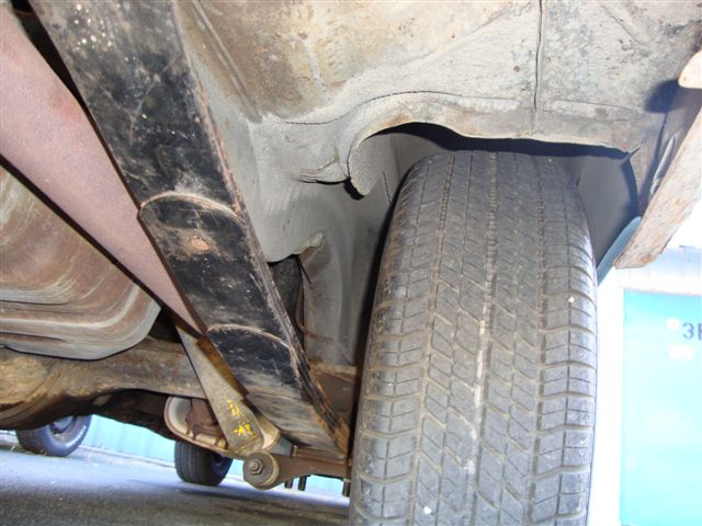

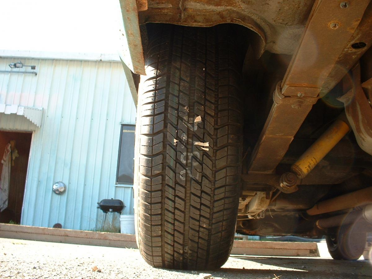

Welcome to the 66/67 B bodies. Here's my 66 with a 7" tire on a 4.5"? BS wheel - whatever the factory steelies are. LT side shows the original sagging spring and the RT side is with new 3700 lb SS springs. Tires are 235 - 70 - 15. I could not fit standard 15 x 7" Centerlines or an old set of slot mags with the common 3.75" BS.

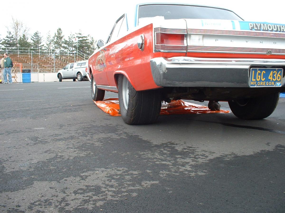

Here is a 67 I saw in Portland last year with 315 - 60 - 15's. Springs were moved in and almost rubbing on the gas tank lip but I think the body was unaltered or minimally altered. Anyway, whatever part was in the way was moved and the other was not. Note the wheels. They are all backspace with the drum totally inside the rim!
