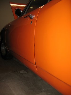

gap
help
These ARE real fun.
Just to give another 2 cents, I've seen many, including mine, whre, even though the door is centered and operates perfectly, one body line may line up but two or more do not. I'm faily certain this is due to poor tolerances between the dies for the quarters and the door skins. For istance the line on the lower part of my door is perfect, but the top line is 1/8 off and the top of the door is 3/16 too high. Closes like new, though!

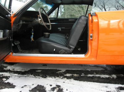

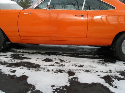

gap
These ARE real fun.
any ideas for correction?

Those gaps actually don't look too bad. Could come forward just a hair, Might let you push the bottom in and not hit the lower rear corner. Any work done to that jamb area? Lots of times too much filler makes it real tight. I've never had to do too much to the top hinge, but my brother just moved his forward about 1/8 and said it was a bear. Might go up just a hair as well.
I definately agree with using a floor jack in conjunction with a wood block. Be careful as the sweet spot for balance can move depending on how far the door is open. I also agree about leaving one each of the hinge bolts just tight enough to slide under force. Easy to go too far, though, and sometimes hard to get back.
Lots of patience required.
Oh, nice lookin car. Love orange on 1st gen RRs.
First hot Mopar I ever saw was very smartly and tastefully built butterscotch 69 RR.

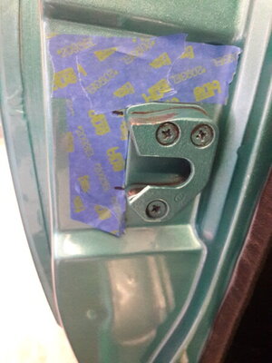

Resurrecting an old thread that I refereed to before I tackled swapping the hinges on my Road Runner last Friday (29 May 2020). I measured two reference spots to the floor in cm; one at the latch start wheel and the other the lip of the door bottom about halfway. Used the idiot proof tool and got really close on my first attempt. Decided to 'overshoot' the reference measurements 1 cm and got almost spot on. Tweaked the striker down 1mm and all is well.
https://www.forbbodiesonly.com/moparforum/threads/idiot-proof-door-hinge-tool.194831/
Oh so slight striker tweak.
