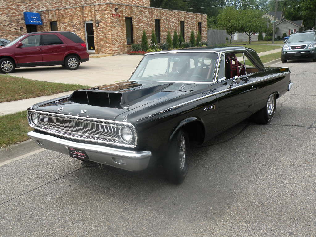

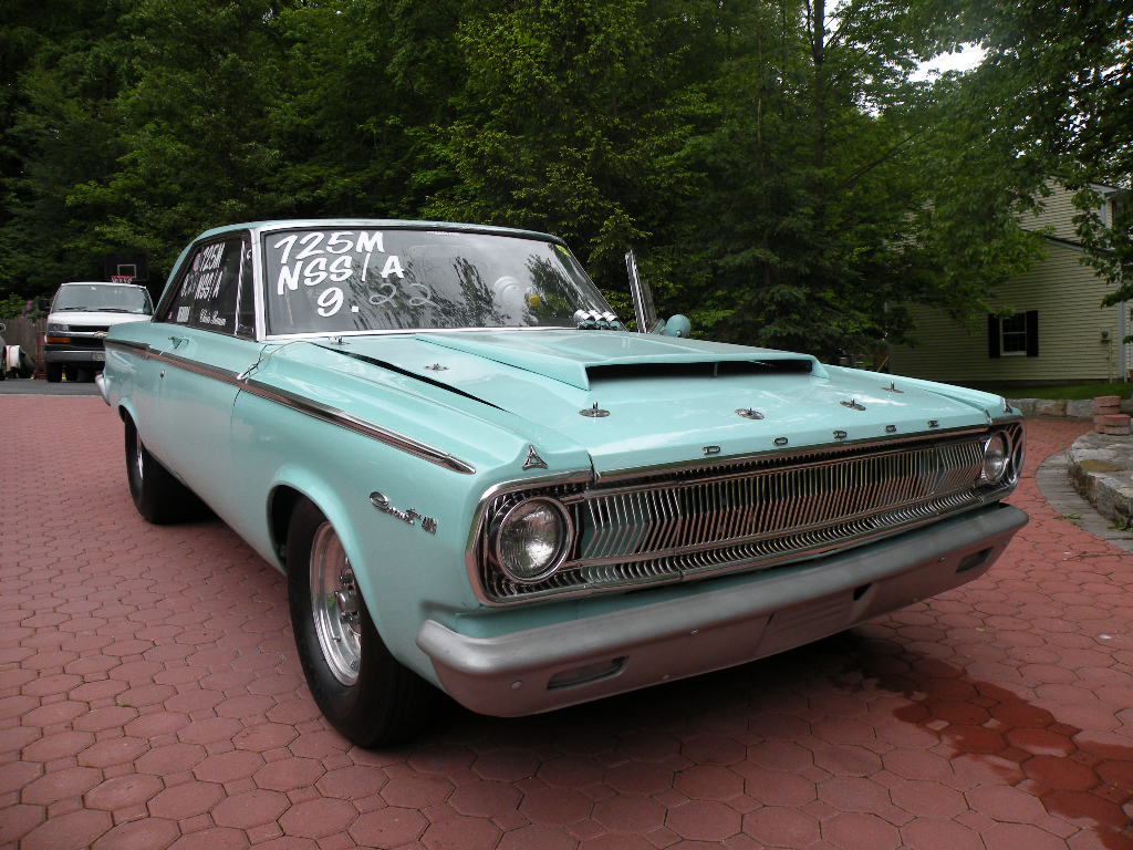

heres mine with 5" afx scoop. also my 65 dodge with regular hemi hood scoop.
i think you'll need the tallerr one for the dominator.

Thanks DANTRAP, I bought it as a roller and redid the chassis to a 25.5, added a B1 TS Motor and a Protrans.727 torqueflite.
I had to reconfigure the hoodscoop 3/4" taller to give my SV1's some breathing room.
The hood scoop are getting repainted now and being refiberglassed.
