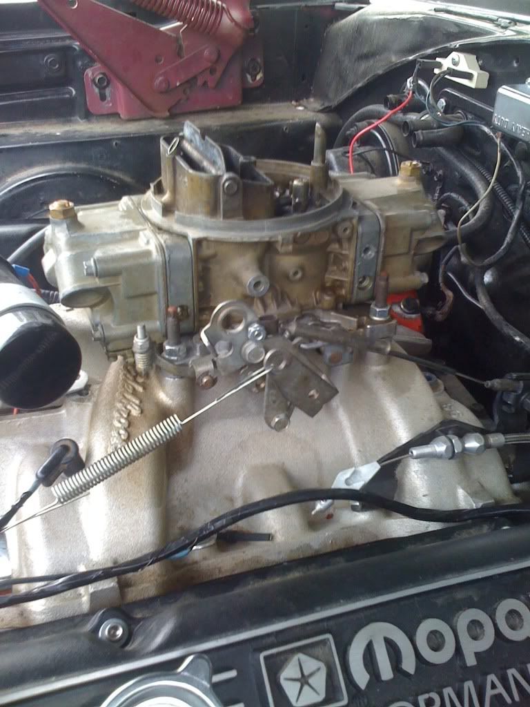

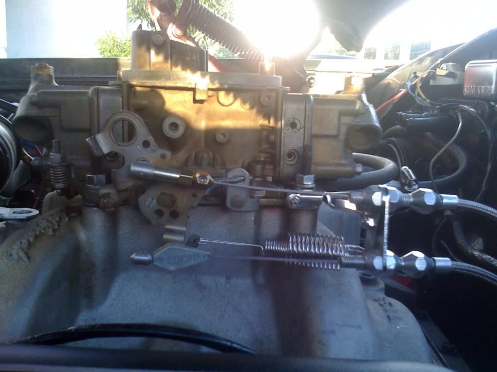

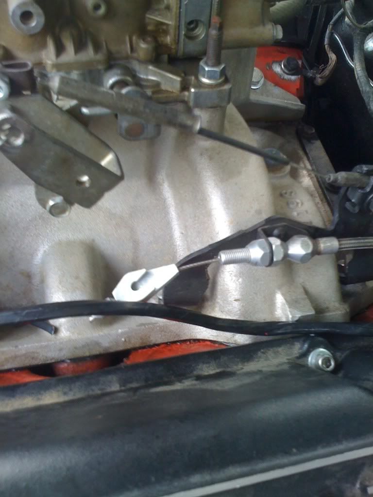

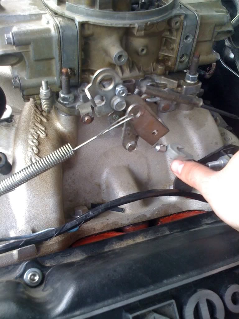

Ok i have a 67 belvedere II and it had a 383 and has now a 440, previous owner installed a lokar transmission drop down cable but never hooked it up to the carb. I notice the cable is set to far back to reach the carb and also doesnt have any good location to provide enough swing to pull the cable out when i accelerate. any help of solving this issue would be tits. Thanks in advance guys.
FYI i have most of the 383 linkage in the trunk.
here are 3 pictures of what im dealing with now.
I have the stud that clips the plastic end of the cable to the carb but there isnt a location on the carb to place it.

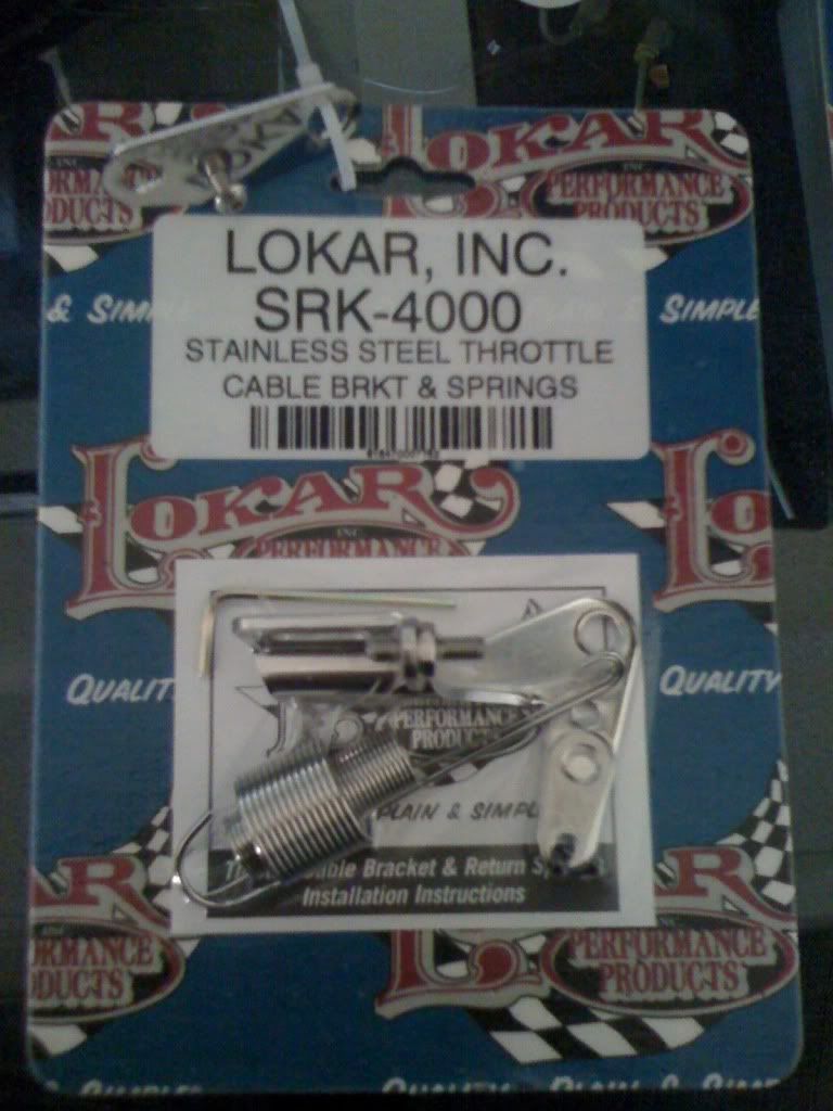

Looks like you may need the same bracket that I used that bolts on the rear carb nut. This bracket came from Lokar with the cable.
Joe do you or could you provide me with a picture of the bracket on your car? cause if i cant solve this, Im selling the whole car and buying something thats turn key and ready to go cause all this damn work i've paid for this thing is killing me!
I've never used the Lokar thing but from the pic it looks like all you need to do is get a ball stud at the parts house. Go to the hardware store and get some 1/8" steel and start fabricating.
The other thing you need to do is get the factory stud that goes in the bolt on MoPar throttle adapter. The stud goes in the hole where your spring is now and the spring goes right where the cable hooks on.
What he said. Your throttle cable is in the wrong place, and should "float" on the small side of the factory stud

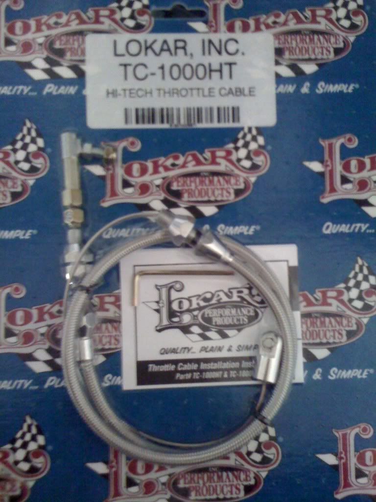

Ok i got a small 2 parts large list of things i need to have this all hooked up... the bracket that Joe mentioned and pictured in this post plus a lokar throttle cable to work with the lokar bracket. total cost $84.51. thank god i thought i'd have to pay up the wazoo for this.

Thats all it does. The pedal just rides against the rod that connects to the cable. The Lokar cable will have what you need to connect to the gas pedal, connection.:yes:

Woo WHOO! Parts came! Purchase from Coppa Automotive in San Pedro, the guy that works there through in a free mounting place with lock nut and bolt that i was missing from my lokar trans cable parts.

Got the cables and bracket installed yesterday, my cars a freaken monster now when the trans kicksdown... I didnt expect my 440 to sound like a top fuel dragster at WOT. I LIKE!
