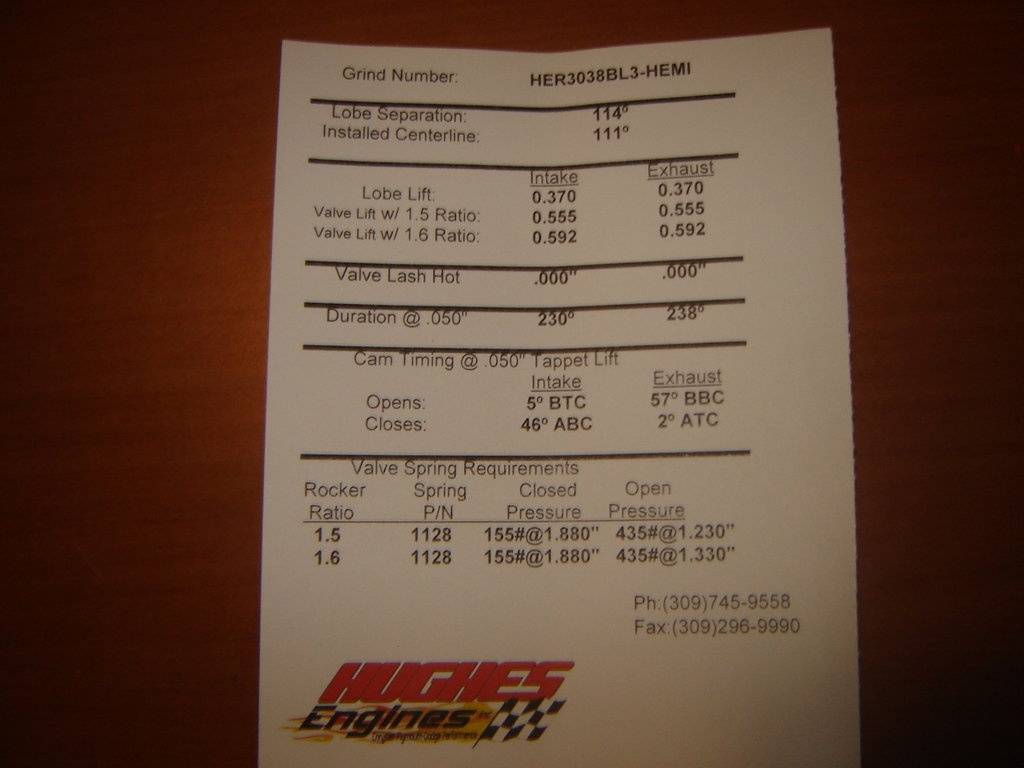

The engine is a 496 stroker. I had a 493 stroker RB kit in the car from 440 source. Then decided I was going to do a Hemi conversion with my 440 block but its hard to get those heads from Stage V. So having the custom Diamond pistons already. I bought a World aluminum Block and had it bored to 4.360 to work with the pistons I already had. No mods necessary to the world block other than machining, its ready for big power out of the crate.
9.1 Diamond Pistons
440 source I-beam rods.
4.150 440 source crankshaft.
The cam was a Superchargerstore special cam for the Hemi conversion. Bob and Terry have a low deck hemi they built with those heads.
I'll add a pic of the cam card.
