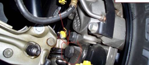

What is for 1966-69 B-Body Stock factory disc brake spindle lower ball joint bolt length?
Does anyone know length of thebolt
Thanks
I know this is 4 years old, but did you ever find out? I'm having fitment issues on my end. I ordered bolts from Dr. Diff and they were too long and partially threaded vs. the originals which were shorter and fully threaded.
I brought this bolts from Bill Rolik
Lower Ball Joint Attachment Pkg. - Disc Brakes, 2 SUSPENSION-FRONT, 217 - N.O.S., Reproduction, and Replacement Chrysler Parts
They still too long they were 2 1/2 inch length and cut 3/4” off to make it work and did not the nuts
spindle to lower ball joint bolts size​
The bolts are Grade 8
DRUM Brake 5/8 x 18 x 2 1/2 inch length
DISC brake 5/8 x 18 x 1 3/4 length for Bendix Disc Brake System
