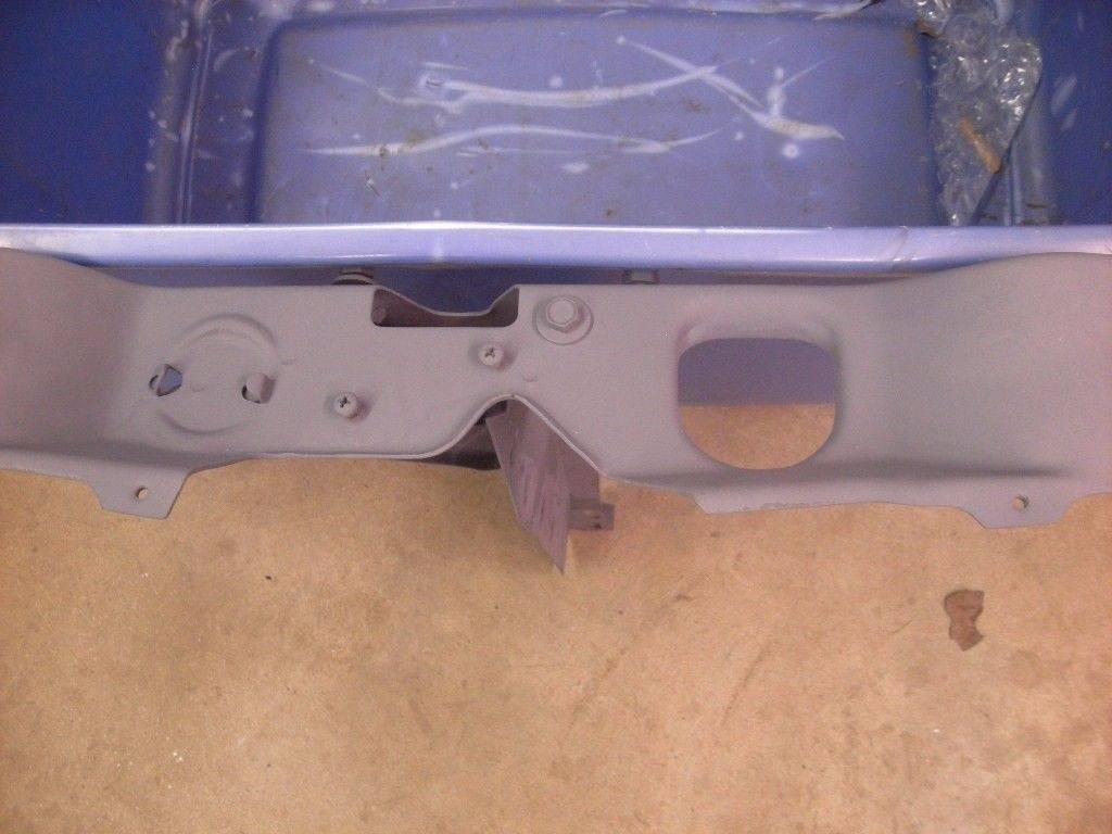

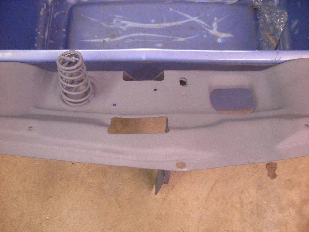

Not only are the grills different, the upper grill tie bar that they mount to is different 68 to 69.
I am POed. I bought some cherry 69 RR headlight bezels cause I thought they would go good with my 68 RR grill.....won't fit.........................MO
I don't know if the headlight bezels interchange or not, just that the grill won't, or won't without modification.
68 and 69 head light bezels will not interchange. It is possible to put a complete 68 set up in a 69 but as stated you do have to change the upper frame. But everything does just bolt in.
