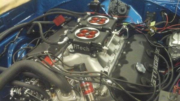

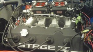

I had the same thought with the 68 Charger I am working on. After 27 car projects over the last 33 years I decided to go all out with the last one. I couldn't find a cast iron block so I sprung for the Indy Maxx aluminum block and went Hemi! I came up on the list for the Passon Perf. 5 speed OD transmission and went for it. The engine and trans are in. The drive line is being made, once in, we can fire it up and see how the FiTech dual quad set up works. Go Hemi and good luck.

Hashmaker that is a beautiful engine right there. What do those blocks go for and I've heard Indy has a fairly long wait period for them.

The aluminum block was 5900 by the time Indy did their machine work and the engine builder did the final prep. Bore is 4.375, stroke is 4.150. It did take about 7 weeks for the engine shop to get the block after ordering it.
