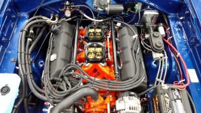

Great car. Looks like what i had to start with. My floor and trunk were gone. Had to change everything you are changing.
Take a look at what i got going. My is in paint and started assembly. :eek:ccasion14:
