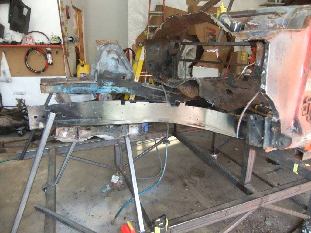

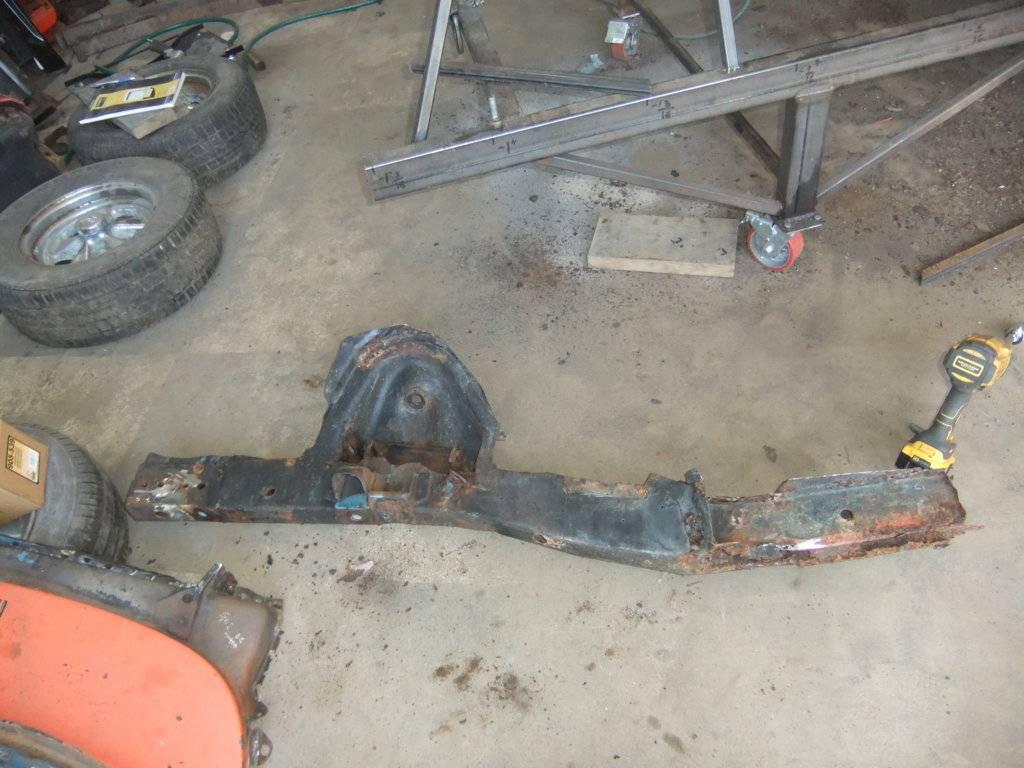

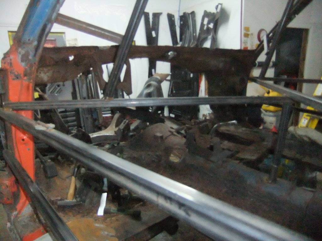

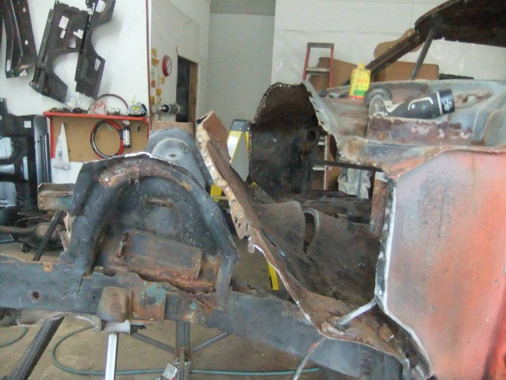

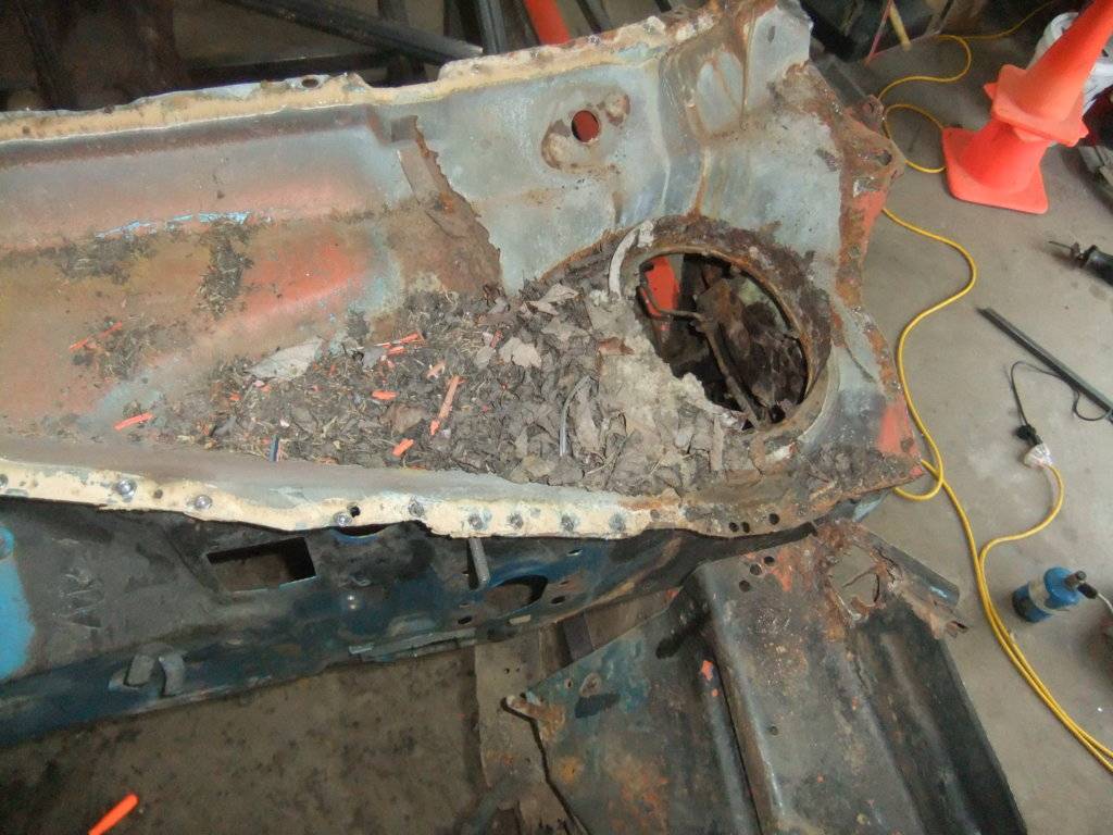

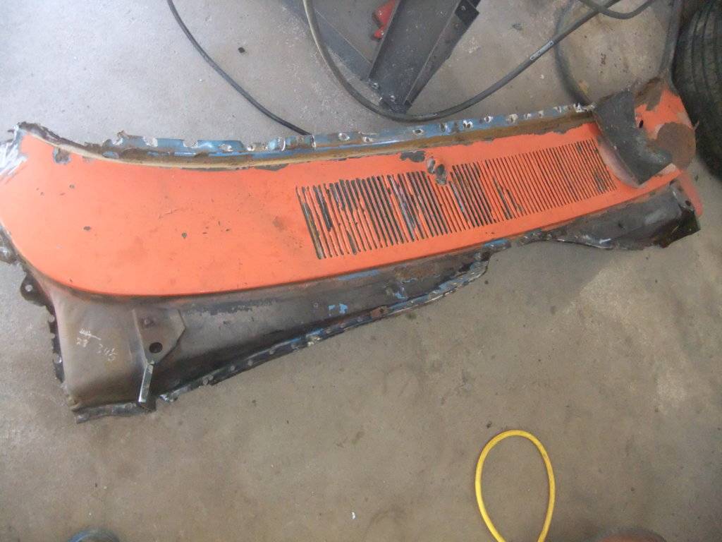

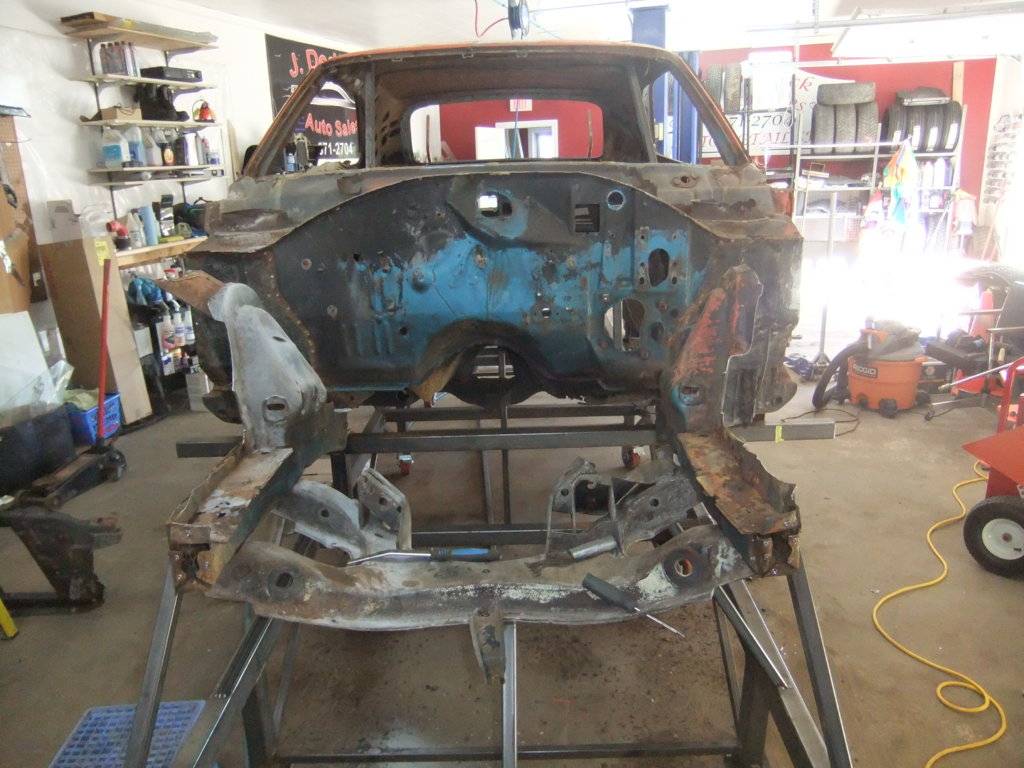

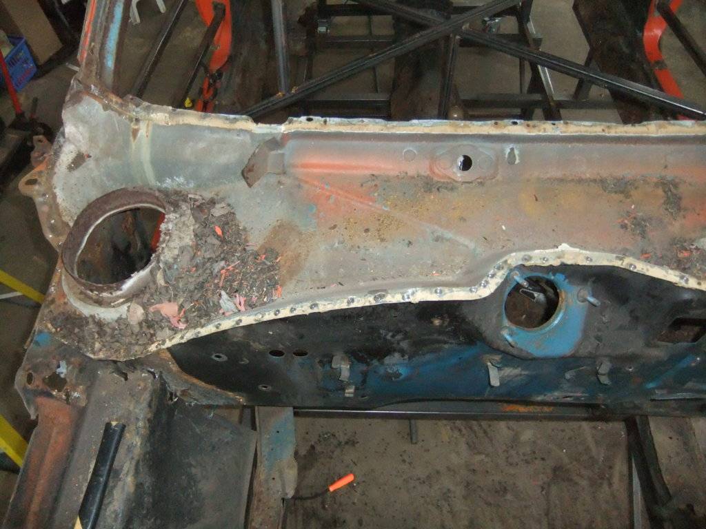

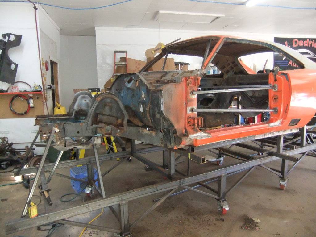

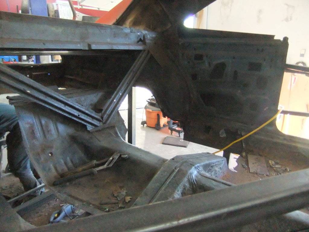

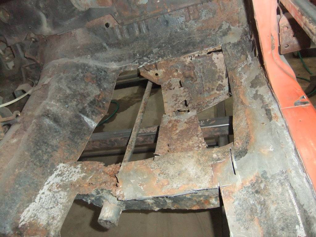

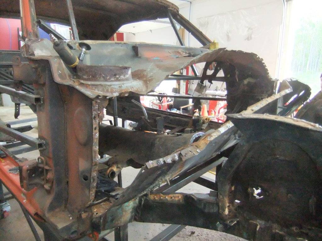

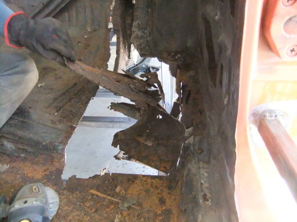

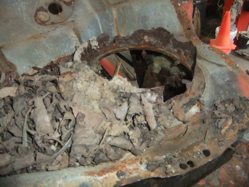

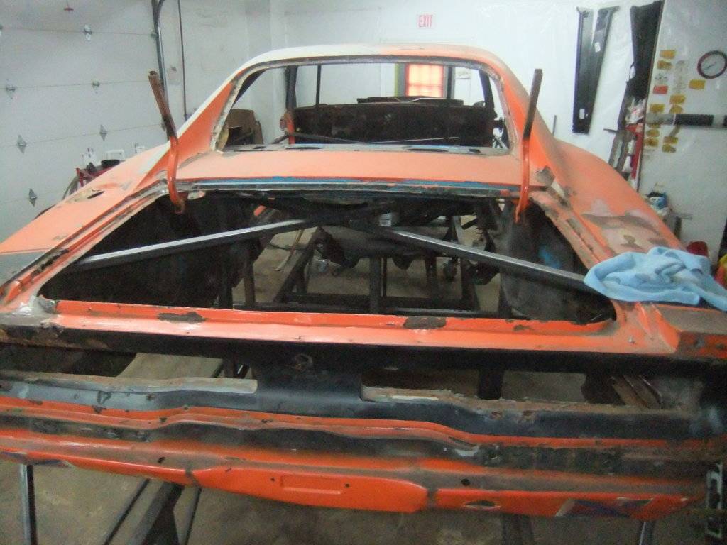

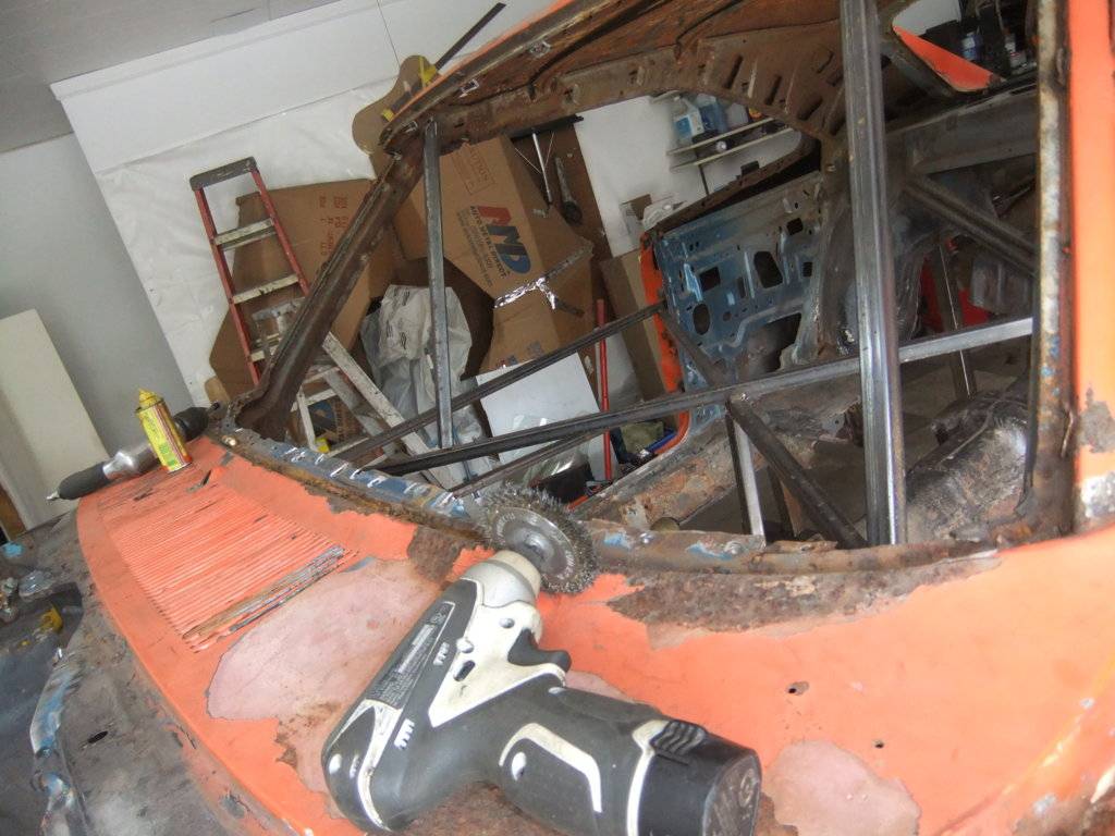

We haven't been very ambitious in the last 6 months. But we have had some free time to spend on the charger the last week and have been able to tear most of the front end apart, cut the majority of the floors out and start to mock up some new parts.

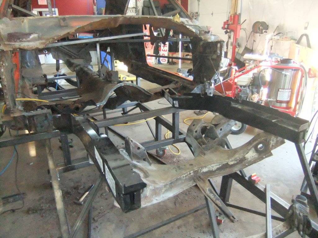

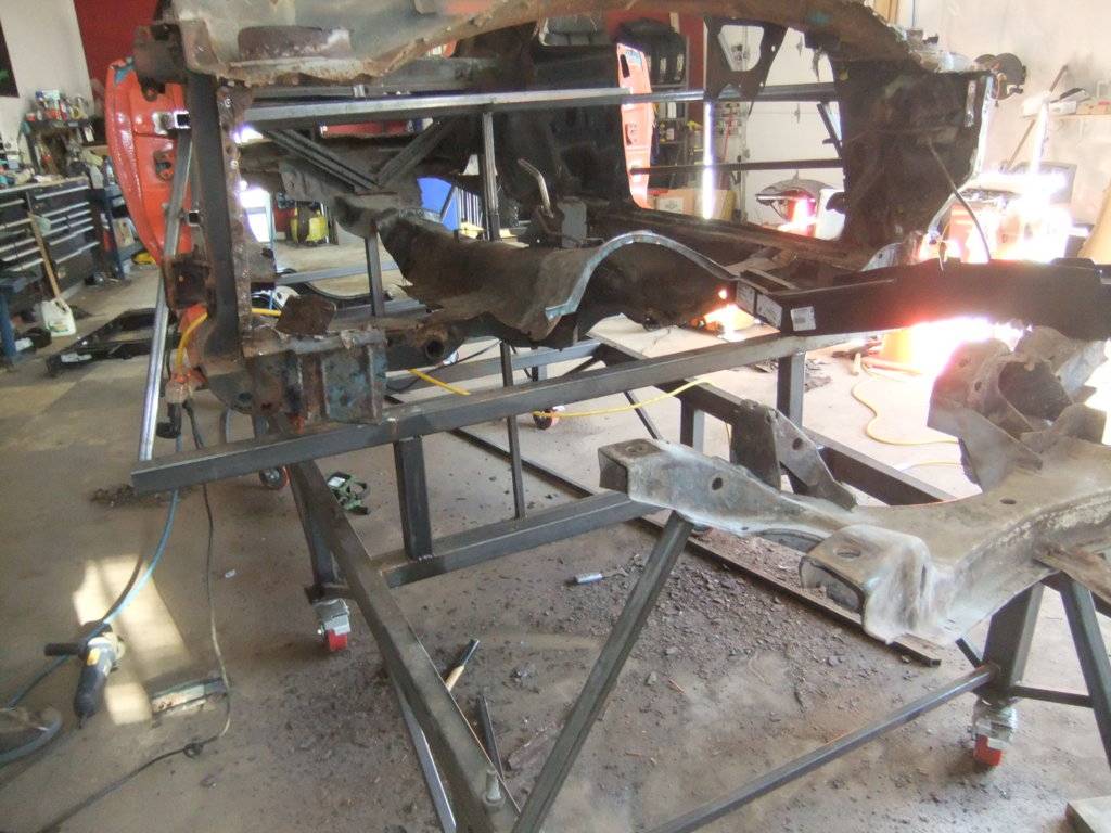

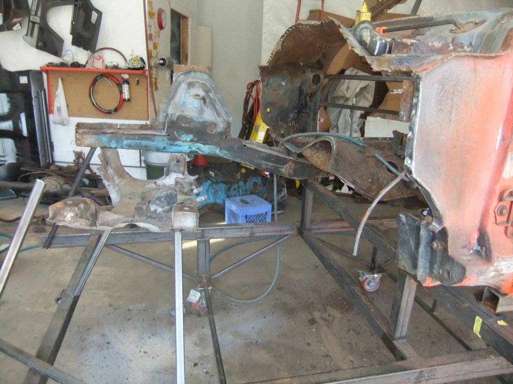

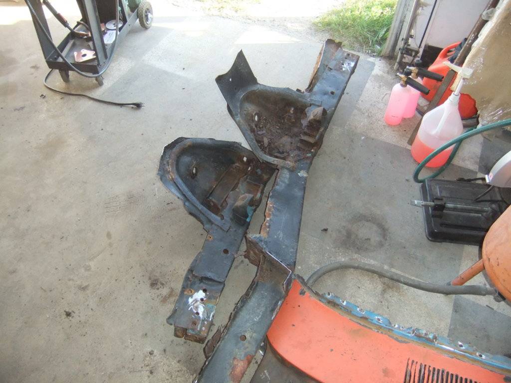

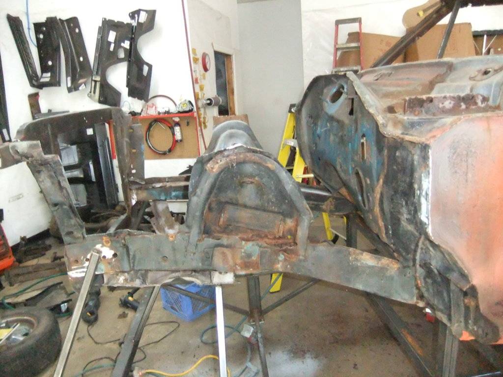

Frame rails getting cut out and new ones mocked up. Its such a great feeling to see an actual solid piece of shiny black steel in this car..its such a rare sighting lol

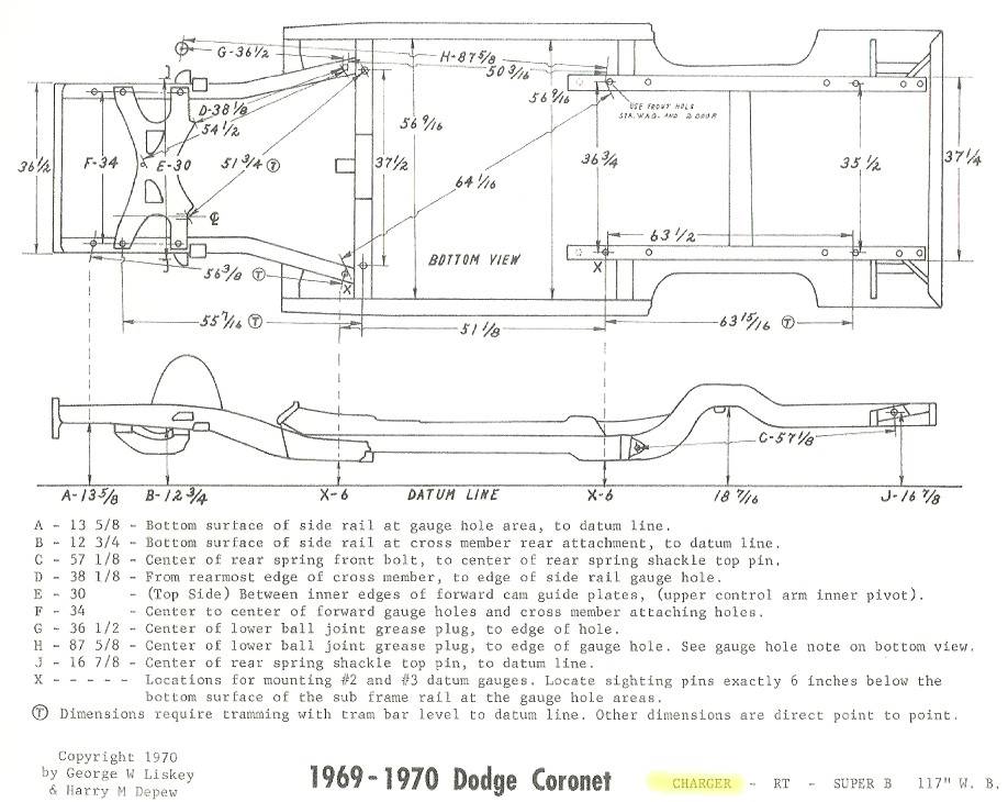

ANY INPUT WELCOME: we've been playing around with the alignment of the front rails. this car was in a bad accident in its life time, the left rail was bent up real bad, so the measurements were way out of wack. I braced the k-member in place to were i know everything fit..however when i bolt the rails to the k-member and snug the bolts my outside measurement is about 36 1/8". and it is evenly square down the rails at that measurement until the curve in the rail obviously. However that measurent is off from the frame specs of 36 1/2". wondering if that would be considered "acceptable tolerance", because there seems to be no way to space the rails to spec and have the k-member bolt up. Im waiting to recieve my AMD rad support to test fit that.
