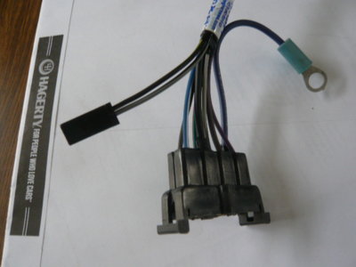

Hi , I am replacing the engine wiring harness i got from Year one
The new one has the leads to plug into a 4 post ballast resistor,
should or can I replace the 2 post one with the 4 post one?
What will happen any Ideas?
Thanks
yes you can ,are you changing to electronic ignition?
it was converted already with the Mopar setup with the orange box
Thanks
You sure they didn't send you the wrong harness.. My '69 harness for my Bee came correct with connectors for single ballast.
Its possible I am going to call them Monday, But I heard the 4 post ballast is better form someone
I wanted to do this today its a rainy day here in NY perfect for wrenching
Just bought one for my 70 Bee and thats what they sent me 4 prong ballast, parts number 38361. is this 2 wire plug on your harness ?
70 and above is the 4 prong......69 and below is the 2 prong....
Stock '70 is a single ballast.. one in.. one out.. at least cars built Dec '69 anyhow... :)
