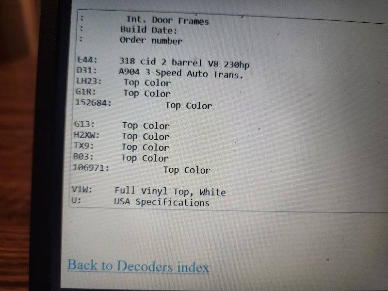

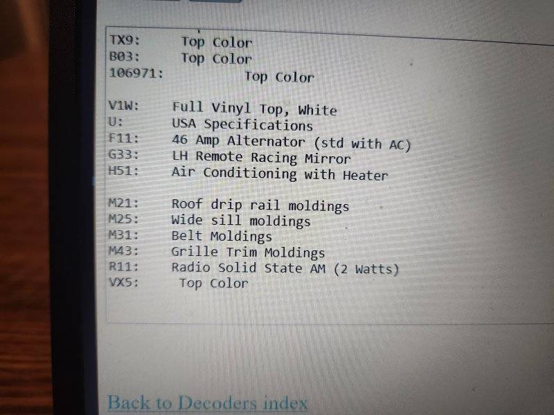

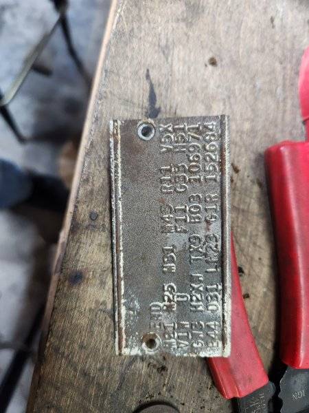

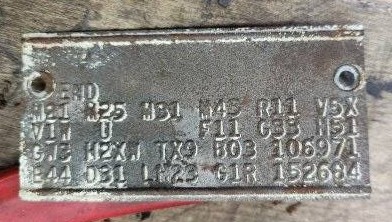

Thanks for any help

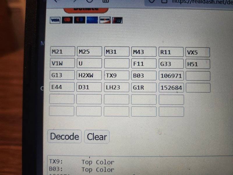

this is what I have, what color interior? What color is the car?
You have G13 for the body color. Look at that code closely on the tag, I don't think that is correct. H2XW is the interior. TX9 is black upper door panels.
You have G13 for the body color. Look at that code closely on the tag, I don't think that is correct. H2XW is the interior, white. TX9 is black upper door panels.
the owner says the car is white,what code number is that?
Does that tag say GW3 instead of G13 as you wrote? I don't have my white book in front of me, but that would make more sense. I do know that in 1969, W1 is the code for white, not sure if that changed for 1970.
GW3 bright white
V1W white vinyl top
H2XW black vinyl bench seat
TX9 black upper door frame paint
V5X body side moulding black

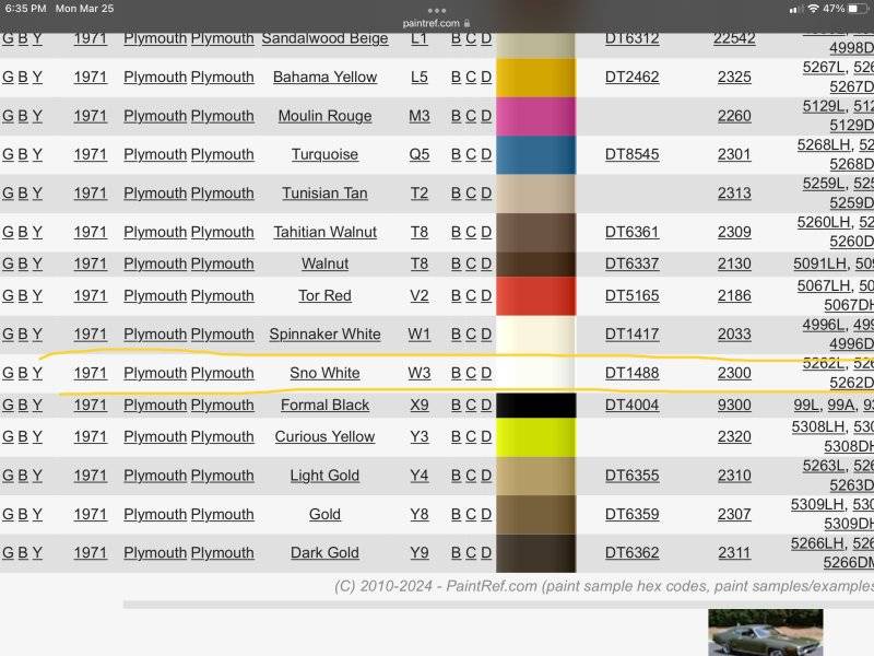

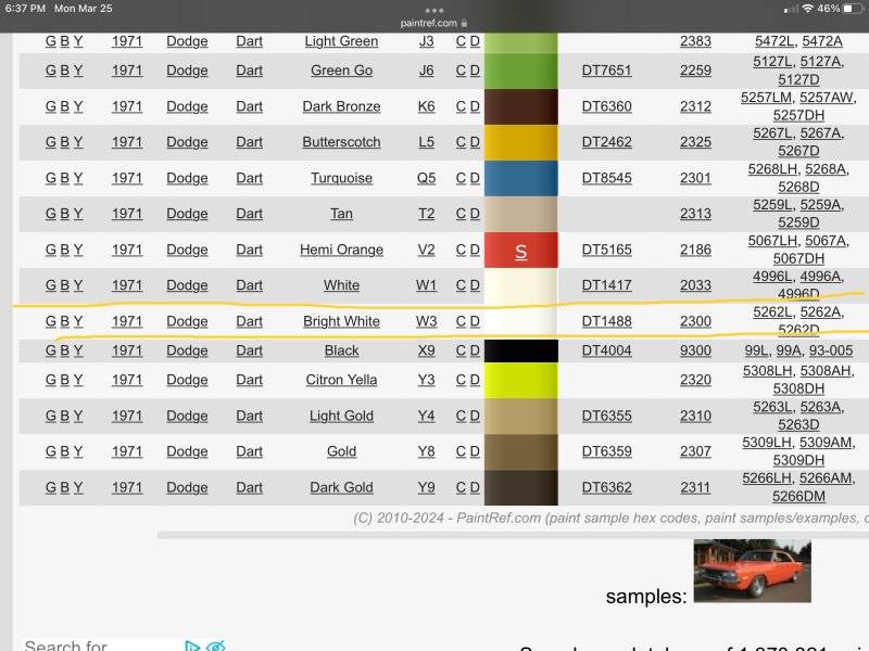

1971 Dart 318 auto
Dodge is bright white
Plymouth is sno-white
Same color code Dodge Plymout, Chrysler commonly have different names for the same color.
For that interior code H2XW in 71 shows high trim, vinyl bench, white and black.
rare color combo 3 x white, bet not to many of those cars
