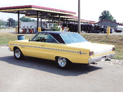

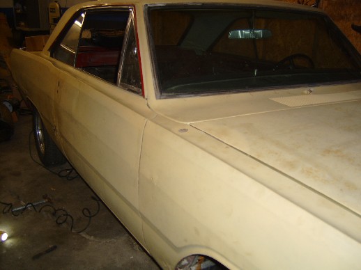

Thanks! Here are a few pictures of my past and present Mopars.
I want to see the 1970 Road Runner. Love that year.
All the parts are hard to find, as it's a one year only body.

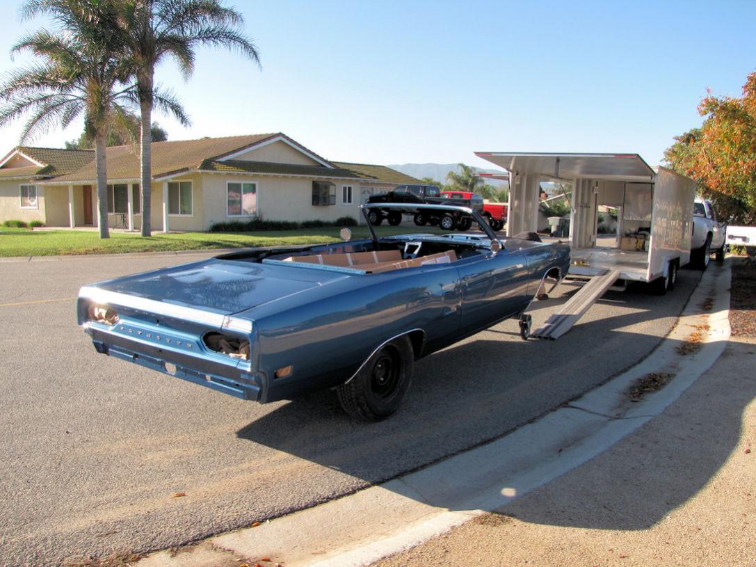

A bunch of parts are now reproduced, but many aren't. 68-70B hardtops have a lot of common parts - glass, door hardware, console stuff, suspension, steering linkage, axle, brakes, some sheetmetal, and such. Grilles, emblems, decals are generally unique to year/model. The 70 quarter panels are unique, with the scoop. AMD is reproducing nearly all the hardtop sheetmetal. I got one of their 70RR fresh air hoods - VERY accurate repro and actually fit better than the orig. Most all of the fresh air stuff is being reproduced.
I'm on my 3rd 70RR restoration, this one being a convertible. Fortunately I collected a lot of parts in the 80s when these cars were plentiful in boneyards. I like all the mopars, but the 70RR is my favorite.
