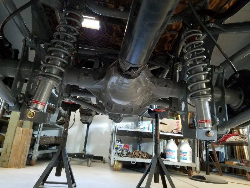

These are some of the shocks I have on my cars:
Seems the price of shocks has really gotten expensive, but I bought the KYBs 30 years ago for about $100 for set of all 4 shocks, and the Bilstein shocks maybe 10 years ago for about $400 set of 4. I just bought the Viking shocks recently, so just under $1600 / set of 4 (they are still in the box.)
The KYBs are a stiff shock, and one of the lower cost options. About $300 set of 4
The RCD Bilstein shocks are good, but pricy. About $600 set of 4
Not sure if the have a listing for Mopar B-bodies, but have Spax double adjustable shocks on the Jensen Interceptor. About the only shock "listed" for the car, but I could have measured the original shocks and found a close replacement. Anyhow, those were about $200 each.
The Viking Triple Adjustable Shocks are "Adjustable" and really pricy at about $400 each.
