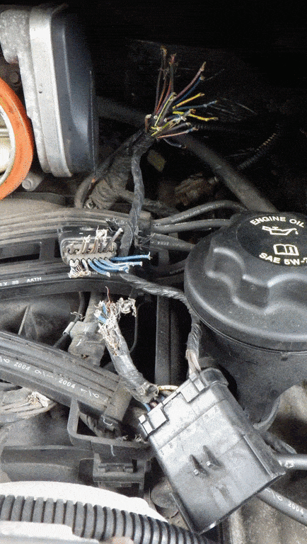

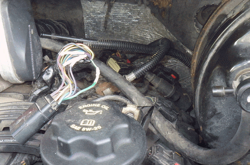

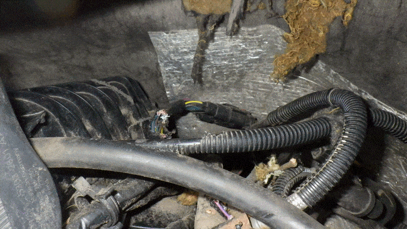

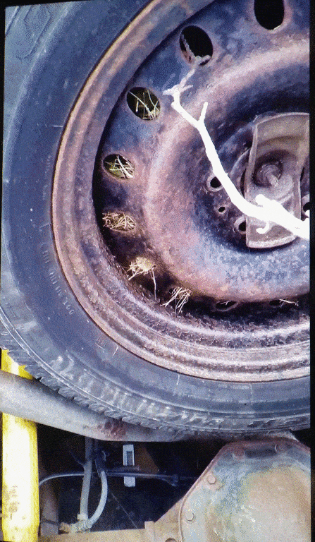

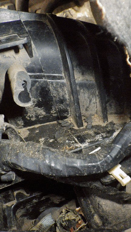

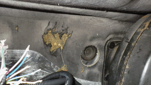

I had to be NUTS to buy my '05 Ram 5.7. :realcrazy: Damn thing draws squirrels like flies draw..........well you know. Need to clean out a nest on top of the spare next.:BangHead:

I had to be NUTS to buy my '05 Ram 5.7. :realcrazy: Damn thing draws squirrels like flies draw..........well you know. Need to clean out a nest on top of the spare next.:BangHead:View attachment 491930 View attachment 491931 View attachment 491932 View attachment 491933 View attachment 491934 View attachment 491936
Well I would almost have traded with you. Mine is in great shape..if you can get past the fact that the kid that had rolled it was drunk and when he rolled it he puked all over everything inside! IT WAS NASTY!
