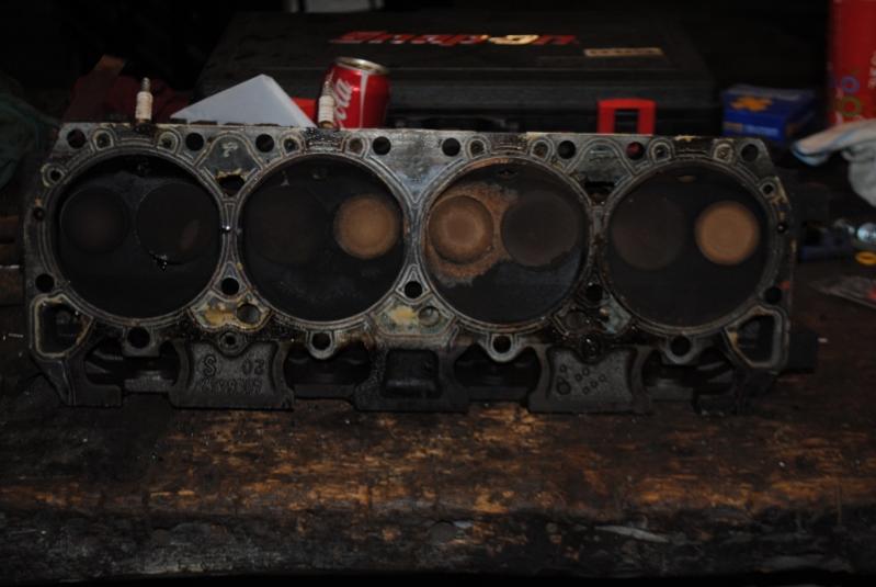

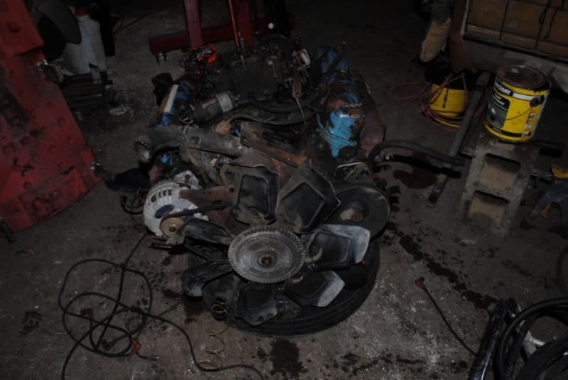

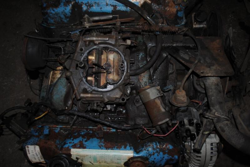

could be worse. this is why i tell people not to just throw in junk yard motors. looks like im adding all new valves to the list. o well. Im not just throwing money at it im having fun with it. spent hours sand blasting all the random external parts that are going back on but im not sure what color scheme im going with. so the block is going to be cleaned and magged. balance everything. heads will be ported and once i decide on my intake setup and what not i will have everything matched. im also looking at roller everything.

if you plan on porting the stock cast iron heads, you may want to fork out a little extra and just get aluminum heads that will flow better OTB, save weight, and allow for a higher compression piston while still using pump gas. just a thought.

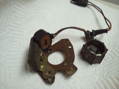

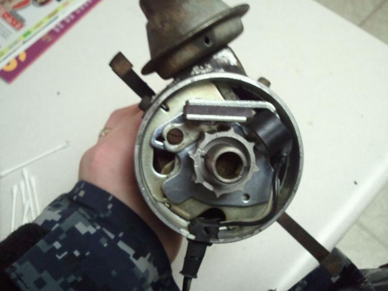

The old ones were probably original that said they were rusty dirty and had metal shavings on them from where over the years the rotor and distributer caps had been replaced and the pickup was probably not even looked at and the reluctor seemed fine so it was left. i have had hot starting/warm starting problems since i got the car. so i did what most of us on here would do. replace plugs, wires dist cap, coil, and rotor. still had issues. ive got 3 ballast resistors that once they get hot and im cranking forever id swap them out so they wouldnt get ruined from abuse. then i had charging issues that were a breeze to fix after peeling away a pound of tape. i still had hot start problems though. so i rebuilt the carb. tuned it and still had hot start issues. when it was running we set the timing. so i knew it was the right timing and i could visually see that it was getting fuel. i had already replaced everyghing...except the pickup coil and reluctor.
so when i took it apart this is what i got.
After installing the new coil pickup and reluctor and setting the gap with a brass feeler to the recommended setting. I could feel the difference in how it spins compared to the free spin of the old one.
I learned a lesson on these myself, i had the front of the engine tore down checking the timing, because someone said it jumped time, bought a new carb (needed it anyway), and it was these two devices all the time. At first i just put the module in and hit the key and away it went, then it wouldn't, thats when i took the distributor out and replaced the reluctor to, been working ever since.. A lot of folks don't think the reluctor gos bad, i learned they do and have talked to others, if they loose there magnetic property's, they may work one time and not the next, Got a good education though! I just wanted to mention the ballast resister, will get hot.. Glad your up and running again..
