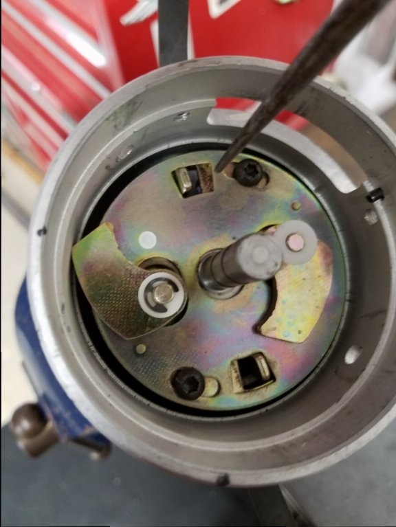

Speaking of Distributors, I don't think you mentioned what type was in your engine? Some of them, including the Mopar performance replacement distributors, have an adjustable plate already in them so it's really not hard to make adjustments if needed... here's a picture of a gutted MP unit, you can adjust the amount of advance by loosening those two Torx head screws, they are connected to a plate underneath that will slide and close the holes up some then just retighten them... by the way you don't need to gut the whole distributor to do this,
this is an old one I was using for parts at one time
