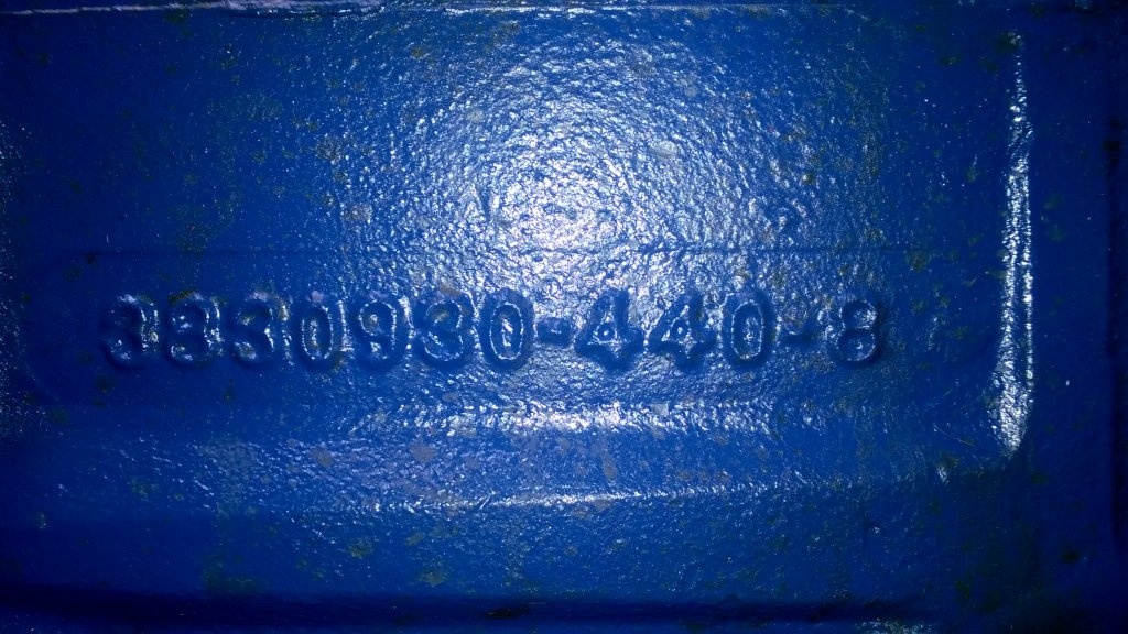

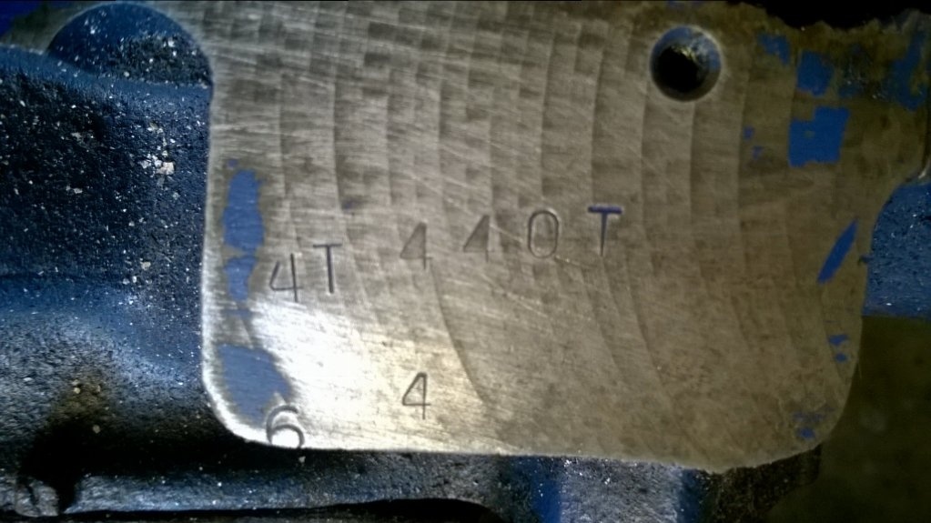

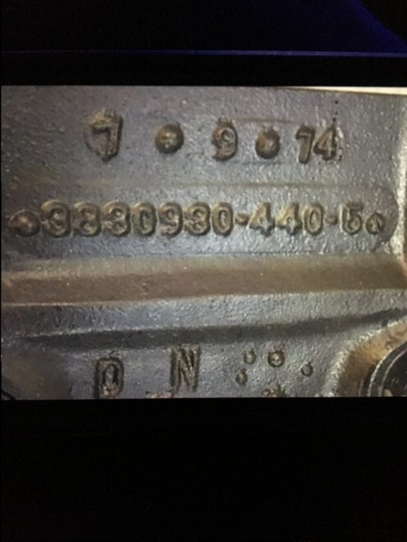

Ok I have a guy selling a 440 and a 727 "core" I can go pick it up down the street for 200 bucks. 440 is a bare block no crank or heads. Anyway casting number is 3830930 440 5. Can't seem to find much on that number and I don't have the info from the data pad in front of the motor yet. My question is, if it turns up to be a rv motor is it worth having? Or is there any difference. Don't have any plans for the motor as I have a running 440 and a 383 on the stand in the garage. But I figured for 200 bucks it might be a good buy. Any help is appreciated as always, thanks

1968-1978 steel crank 440. Looks like a build date of July 9th 1974. Could be a motorhome engine but they are strong blocks with great build potential.
RV Block
You are better off without the crank and heads for that motor. If the block is standard bore that is a great deal......

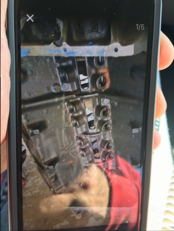

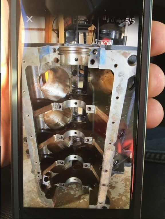

"Most" later RV blocks had stiffening ribs

Pics will tell if it has ribs, buy it! Can you verify the machine work already done?

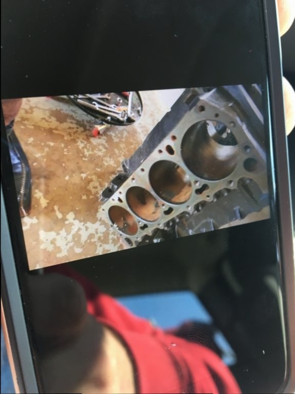

Here's some other photos he has of the block on the listing, don't know anything about the trans but I have a local guy that will take a core and give me a rebuilt 727 with a shift kit for 900 Bucks. I wrecked the first trans I got from him when I blew the driveshaft through the floor, he took the old one and gave me a new one for free.

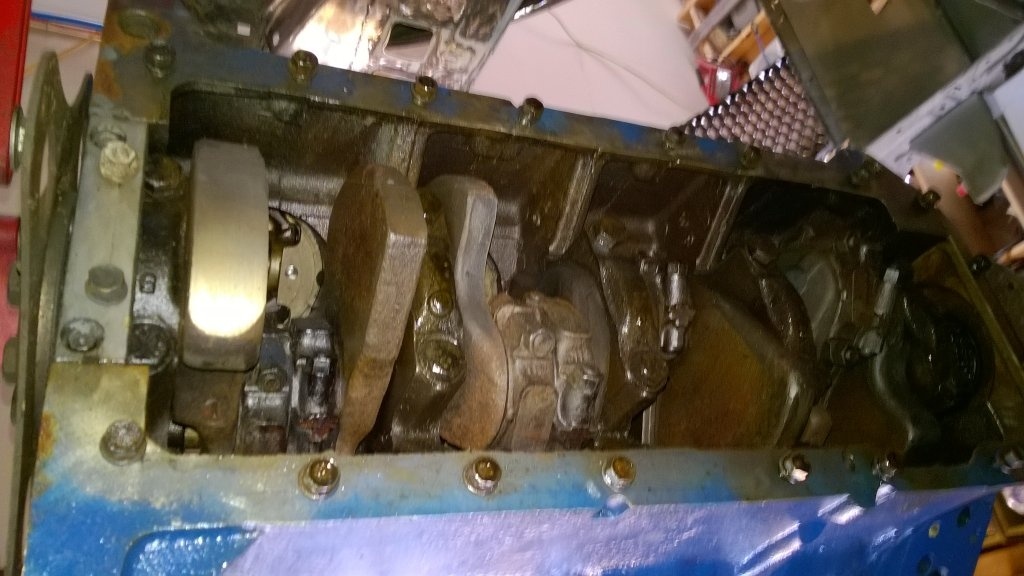

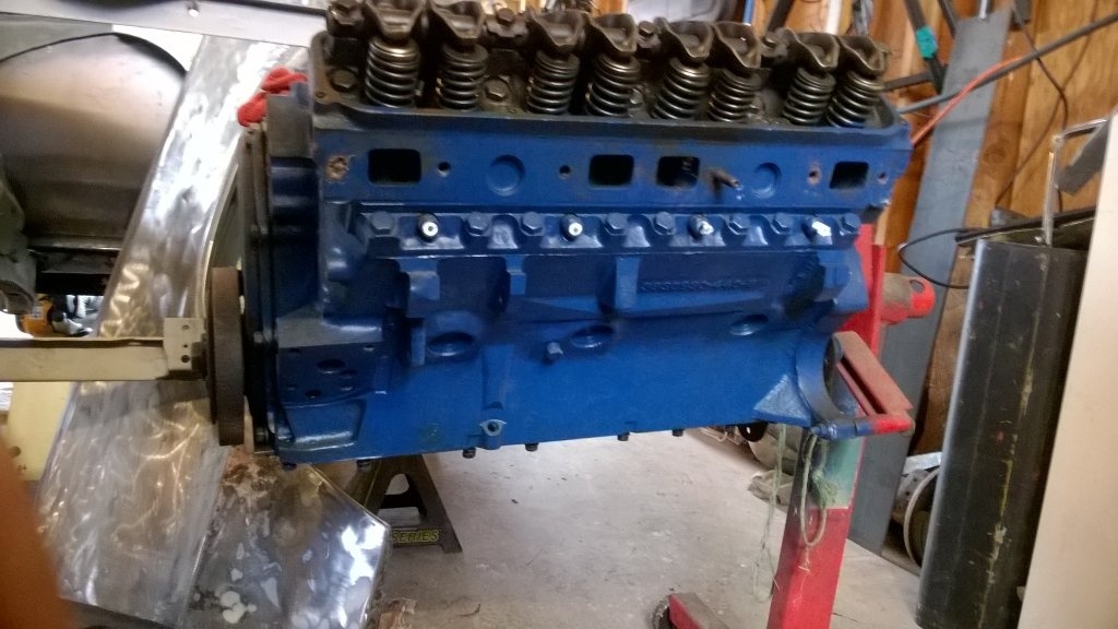

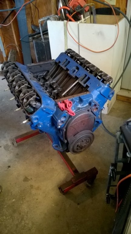

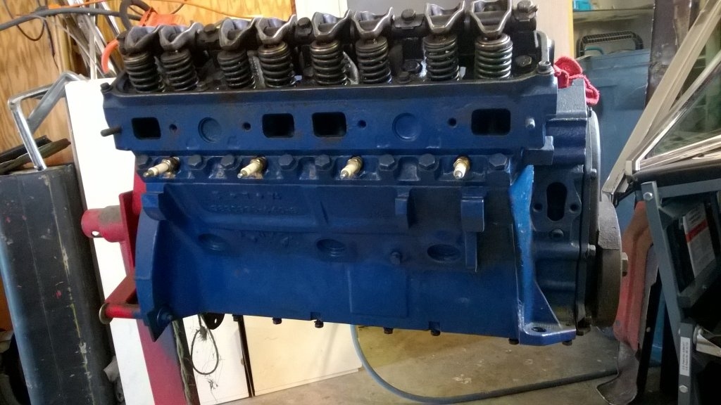

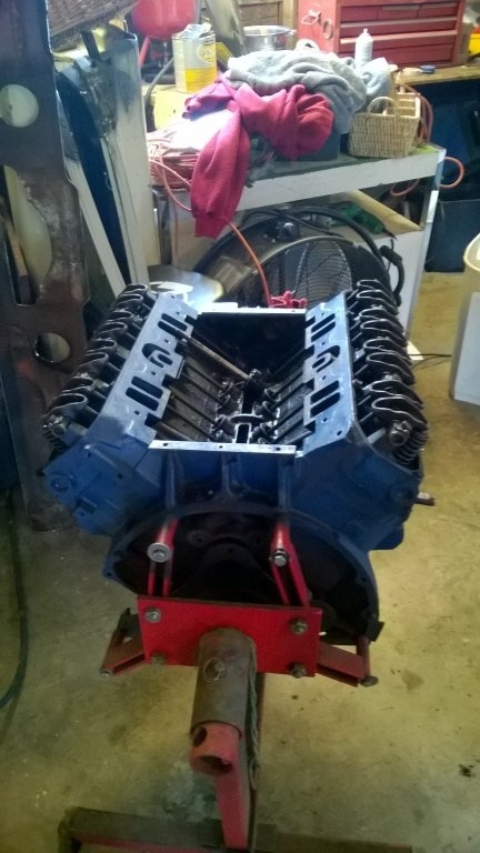

It's a completely stock motor. Here's some pictures, I just got back with it. Cylinder heads are # 3769902-8, block is # 3830930 made 5/7/74
WP_20161227_13_55_07_Pro.jpg WP_20161227_13_55_16_Pro.jpg WP_20161227_13_55_37_Pro.jpg WP_20161227_13_56_13_Pro.jpg WP_20161227_13_56_36_Pro.jpg WP_20161227_13_56_59_Pro.jpg WP_20161227_14_04_12_Pro.jpg
Ok...lol...I have been out learning stuff since earlier. Turns out this engine is an "RB" block, cast crank, "902" heads,8.9:1 compression,
4.32 bore/ 3.75 stroke, built in Trenton 6/4/1974. From what I have gathered so far, the open chambered "902" heads flow as good or better than the "906" heads. This motor has the raised rib along the sides of the block just above the freeze plugs, thicker ears, 10% more cast iron in the block, good thick cylinder walls so I can bore it .60 over if I like, raised deck, increased sized cooling passages, and is classed as a truck engine. The scoop says the cast crank is fine up to 600HP as are the pistons and the block. So I guess my path forward will be to have the block and bare heads hot tanked, sonic checked, honed/bored .30 over, parallel decked, and hardened seats installed on the exhaust side. A 30 degree angle cut on the valves is also a good bet. Porting and smoothing, Gold Race rockers, new springs, small cam, 850 Demon, M1 intake, 2" carb spacer, high volume oil pump, 3/8 fuel line, new rings, performance gasket set, performance ignition. With those things installed it should put out 502 LB-FT @ 3700RPM, 512 LB-FT @ 4900RPM and 519 HP@ 5400 RPM. or thereabouts..lol.
Whew, u been reading a lot. You've got a sound plan for a good pump gas torque motor. 440 Source has good pics on their site with the "ribs" mentioned earlier. Looks like yours is a standard cast 74 truck block- figure 8 cooling passages, nice builder!
