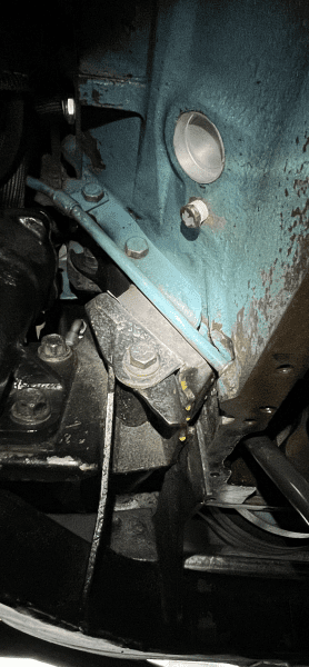

doing some prep work for the future owner of this 66
got a leaky freeze plug behind this motor on the 440cu
looks like a removal of the power steering unit and motor mount
anyone experience replacing this hidden one successfully without removing the engine from the bay?

It "can" be done, but the trick is getting the new plug back in correctly at that odd angle with the engine in the car - not a lot of space. And that's why those typically leak.
Honestly, you have to pull the mount on that side anyway... so you might as well remove the bolt from the other mount and lift the engine as far up and forward as possible, which may eliminate the need to pull the steering. From there... you can replace all of them, which is advisable, assuming you're comfortable with replacing plugs.

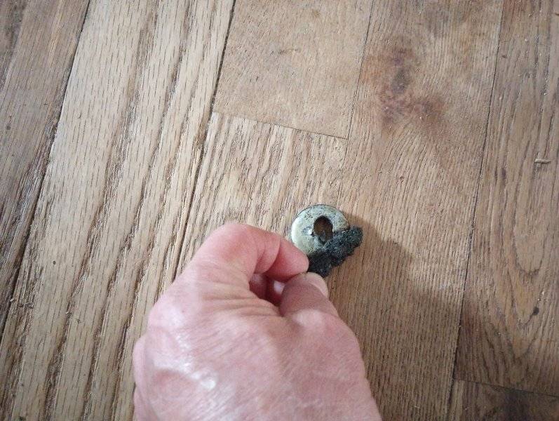

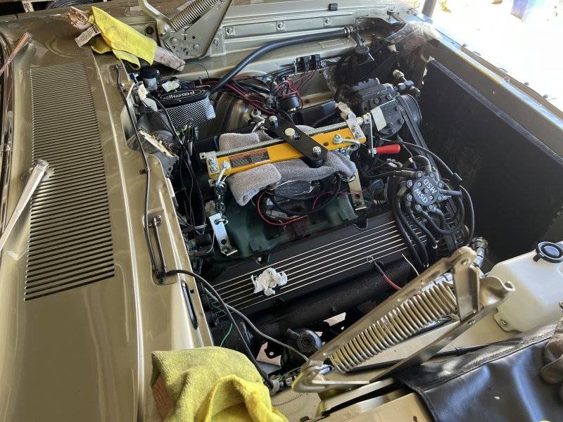

all plugs replaced. and do use a 2-ton for engine removal, the 1-ton didn’t have the reach.
need to find a slot of time to plug it all back in
watermelon
engine back in.
