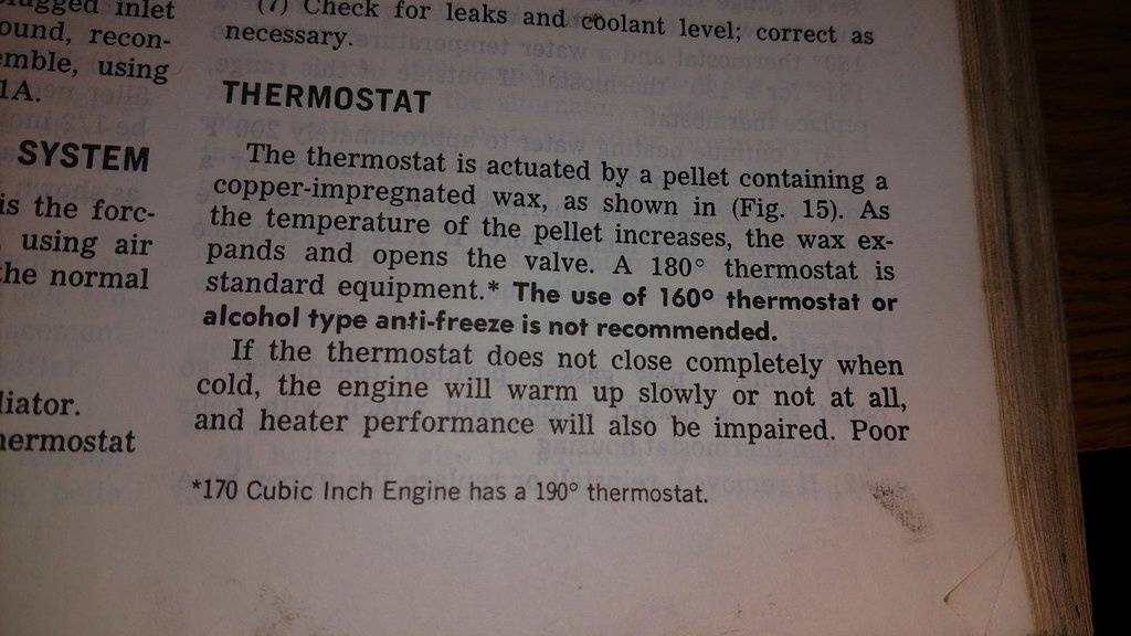

Isn't normal operating temp 210 ? Why is 200 so "hot" ?
I've read that posted on here a lot of times, seems like. I remember back in those days that a 180 thermostat was standard issue equipment but to make sure I'm not having memory lapses, I consulted my '68 factory service manual.
Yep, it confirmed a 180F thermostat was standard issue in all but the 170ci slant six, which got a 190F one for some reason.

Bottom line though? Unless you're running an engine made with this modern metallurgy both in castings and internal components, it still makes sense to run them at the temperatures they were "born" with, designed for, manufactured to operate at - and that, once again speaking of the engines of the 60's up through the mid-70's at the least, typically meant 180 degrees.
Don't really care what anyone "says", the factory manuals are the authority on this subject - and the ones I own say 180F.

Chevy guys run 160 stats. Car guys run 180s. Factory came with 190 I believe.
*sigh*
Nope:
Straight from the FSM for '68 models, Cooling section 7-9.
As a matter of fact, I don't recall even being able to get a higher degree thermostat for these back in those days; those came later, like mid 70's?
The stat ain't the problem, at idle it opens and keeps the engine regulated.
Correct, sort of. Once the engine gets to the temperature rating of the thermostat, it opens. It doesn't know if you're sitting still or hauling down the freeway, it's temperature sensitive, as explained in the FSM above.

Well, my car is a 1970, so I suppose the 190 degree thermostat is what I'm supposed to have?
