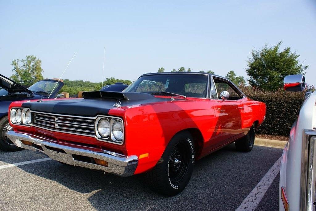

So if I still have my 69 Satellite around Jan/Feb I plan on pulling the tired 383 and was planning on dropping in a 440.
The more I read these threads the more I'm tempted to do the 5.7 or 6.4 swap.
Cost seem to be somewhat close. Crate 440 vs 5.7 or 6.4 used/reman seem to be close in cost....5.7 seems to be the cheaper of the three.
5.7 and 6.4 I'll need wire harness, fuel setup, other random parts and the kit to mate it to the 727 trans.
440 should be pretty straightforward since I have a big block already in there.

I'm scratching my head, how can the costs be close ? You have an A 12 clone, the biggest drawback is that it's a 383, not a 440 6 barrel.

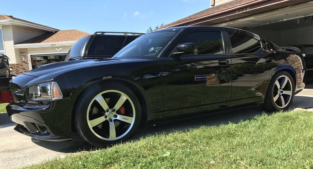

I have a 06 Srt I've been debating trading or selling... but if you keep the car go 440, gen 3 swap is cool but not as cool as a big block 440 IMO
