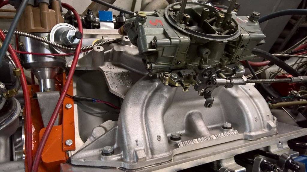

i know this isn't what your looking for but, this is the nicest driving/over all performance intake system i've ever used. this is on a stock stroke 440, mild mech cam, rpm heads, tti exhaust, auto trans (no loose converter), 3.23 gear. if it was a stroker i have no idea what i'd do with the extra torque. power is very smooth; easy to tune. big cubes want air.View attachment 499132

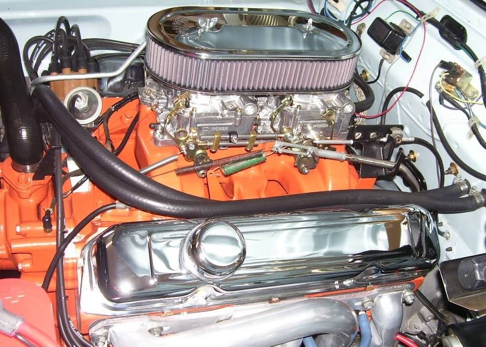

Looks good man! Yea I have the tunnel ram twin carb deal now. I am looking for a stock look with a big cfm single holley. Just preference, but yours looks awesome as well! Thats why I am going to go with the single plane for the airflow....Big cubes need big air.
Well as stock as it gets with a 500ci and all the other stuff that goes with it....( TTI, electric fans, electric water pump, aluminum radiator, etc...)

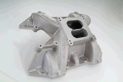

the indy dual plane has a lot of volume and will move some air. a friend had one on a 508 with a 950 holley and was pretty successful with it.
Yea I'll look into that. Doesn't the Indy intake require the Indy head bolt pattern or does it use standard Mopar bolt patterns? Read somewhere that Indy does wierd crap like that with their head and intakes. I still feel that with this big of a motor and street tires anything I pick will have enough low end response where it will have traction issues until 40 mph....

it has a stock bolt pattern and port window. car went 121mph/mid-elevens; 4150lb '67 charger, 3.23 gears, and stock cast iron exhaust manifolds.
