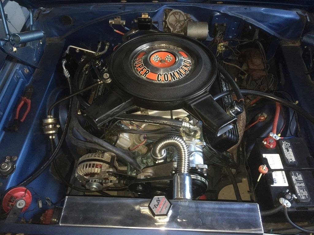

Installed a switch under the dash to turn the fan on and off. Drove over to my dad's today with the intent of charging the AC with his equipment; however, I'm still running hot, and decided not to finish up the AC until that is solved. I'm going to order up a 3-row aluminum radiator from JEGs, I think.

Cooling system day. Did not get nearly as much done as I had hoped because, despite JEGS saying this radiator is for my car, it really isn't. So hours were spent fashioning brackets. Looks like I won't be finishing up till the holiday weekend.
STILL working on this. Bottom hose would not clear the oil filter, so I repositioned the rad to the driver's side more to gain some clearance. Then found the electric fan no longer fit. Out came the grille again and I reversed the condensor brackets to recess that more and I could now just squeeze in the fan in front and reversed the polarity to make it a pusher. I then had the idea that maybe I could put the stock fan back on as well. It is tighter than I trust, so I heated up each blade and flattened them out a tad.

I see guys commenting on the car being very nice etc... Where are you guys seeing this??? I haven't seen one picture of the car in this post except for a steering wheel and one engine shot????

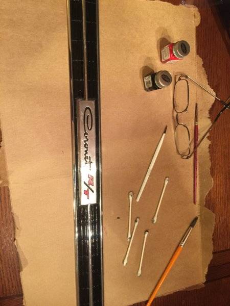

Been messing with interior a little. Posted this elsewhere but repeating here: I painted the interior emblems and will do the outsides soon. I'm fairly pleased with the outcome.

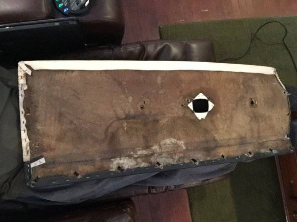

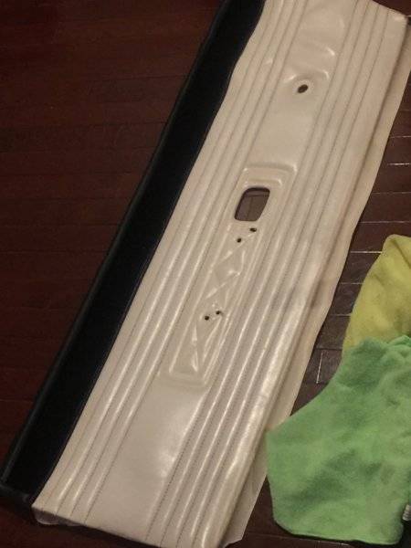

Today, I tackled taking apart one of the door cards, cleaning the material, and cutting a new card.
