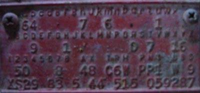

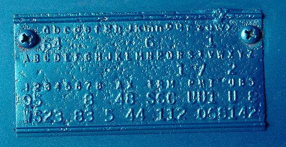

I do know all air conditioning cars left the factory with the 26" radiator max cooling option. Look at your fender tag second line from the top. under the capital letter A, there will be a 1 under it if the car was optioned with the 26" radiator. Not all 440's or big blocks in general had the 26" option. I've seen plenty of Charger R/T's with the 440 and no 26" radiator and a few Coronets myself. Here's a coronet from 68 without it. Second pic is a Charger R/T without it as well.
Here is an example of a Charger with the 26" coded on the tag. Under the Capital A there is a 1.

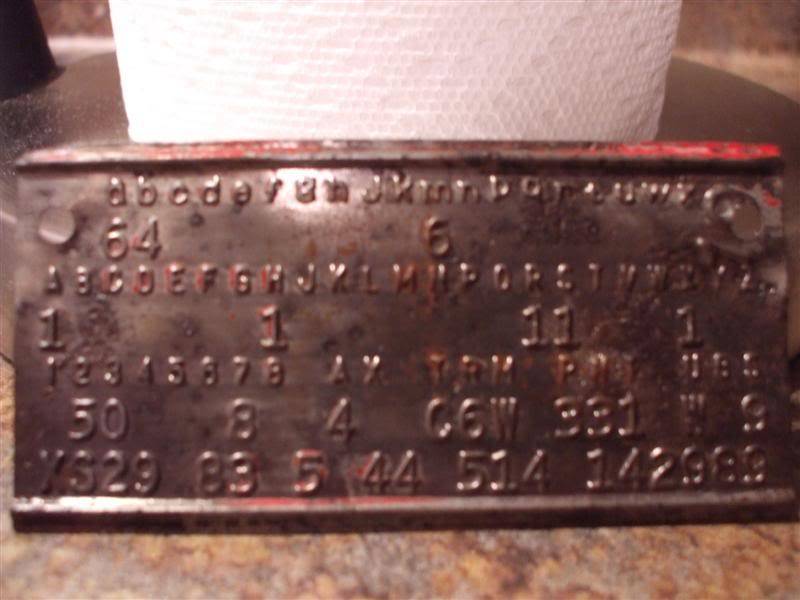

Looks like you have a qq1 blue R/T with blue bucket seat interior. 8 3/4 rear with 3.23 gears. Stripe delete car?
Look around for a build sheet. Check under the rear seat between the springs and seat foam. If not there, maybe take off the bucket seat backs and look there. That will give you more info on your options.
Cool car!!
Thanks for the info. It actually has a white interior, with--for some reason-- bench front seats. And column shift auto and 150 mph speedo. Again, I wonder why this RT doesn't have buckets and console. Son looked underneath chassis for bucket seat bolt holes but inconclusive... not sure if he knew where to look. ???
You are correct on the blue and white interior. Bucket seat,column shift would have been standard equipment. Your fender tag indicates bucket seats came with the car.

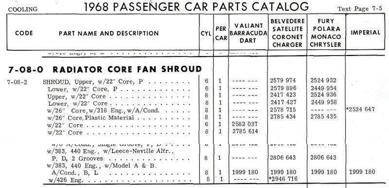

Not sure there is a debate. Here's what the parts book has to say....
Thanks. So you saying that you think that our car came with the column shift, bucket seats ....and maybe the fold-up arm-rest instead of a console? I had previously assumed that the Dodge bucket seat option always included a console with floor console shift. Ma Mopar must have allowed alot of exceptions to the rule, I'm wondering now. :)
Bucket seats with column automatic was standard. The buddy seat was optional. The console was optional. When the console was selected, the shifter moved from the column to the console.
The tag posted shows bucket seats, no buddy seat, no console.
The Super Bee in 68 came with bench seat only. The R/T in 68 came with buckets only. No option available to go the other way so if you have a bench seat in there now it was changed.
AWESOME! Thank you so much!
Awesome! A switch of seats was my hunch, you guys confirmed it. Its great to be on a forum with such knowledgeable people. :)
So 69coronetrt, the top section gives you the part numbers and the bottom the engines it came on?? Having a hard time figuring out other than it gives you part numbers on what shroud went where if equipped.....
440 with a 22" radiator should have a shroud i believe.
Nah...it's a bad copy and paste. Ignore the lower part.
The point was to show the 68 22" radiator got a two piece shroud.
