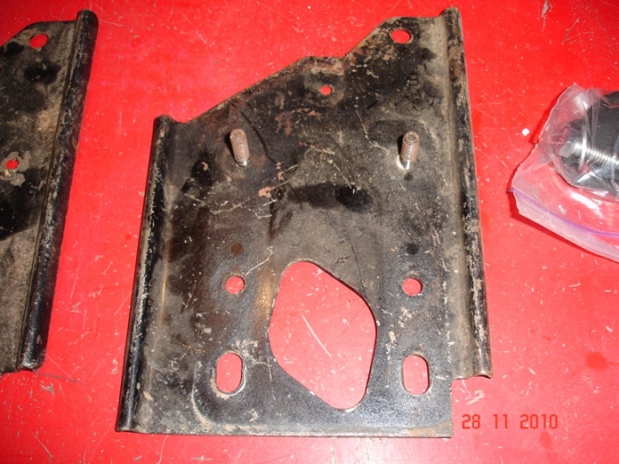

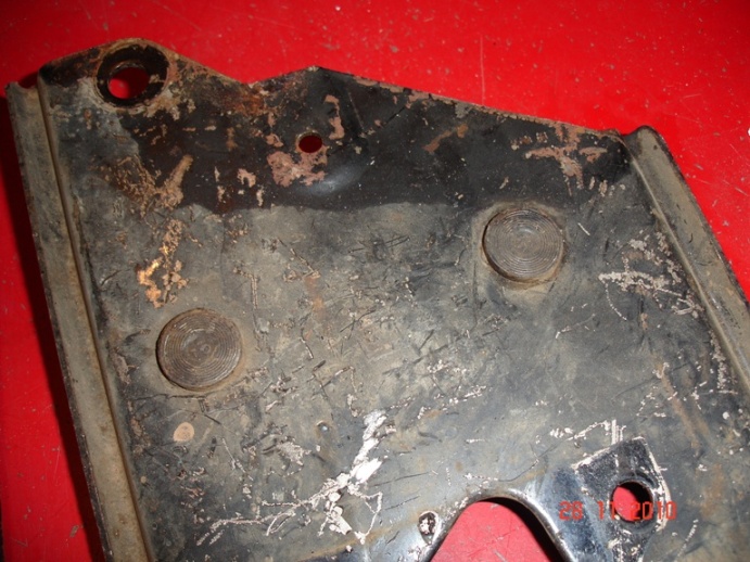

I am doing a 4 Speed conversion on my 68 Coronet, there is a stud plate that comes through the firewall to bolt on the pedal bracket. Does anyone know if this part can be bought somewhere. I have been unable to find it anywhere.
Thanks

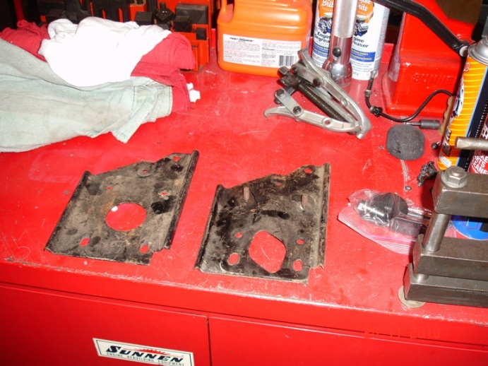

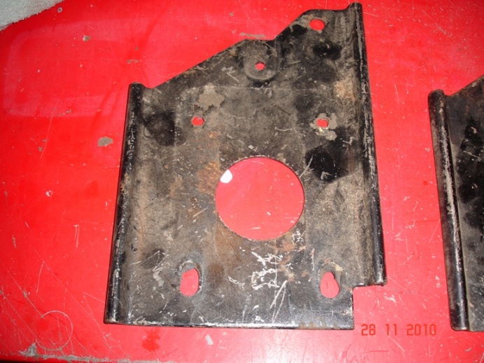

If memory serves, the plate on the left is for a powerbrake setup, and the one on the right is for a manual brake setup. I would look in boneyards for the one you need.

I bought it and after I looked at it you can make it alot cheaper with 2 boltsand a pc of flat steel . just a thought
I made one for a car i had out of the studs off of a brake booster bracket and a piece of flat metal, looked stock but its easier to buy one.
