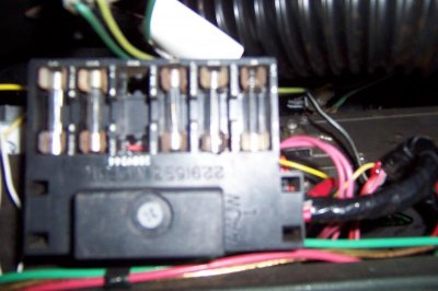

I'm trying to figure out what each fuse is connected to, but only a few of the slots are readable... Anyone have any pics of a newer fuse box? I have the owner's manual but it doesn't give any info on it...
I cant get a good picture but will let you know what this says. This is a 68 fuse box but plymouth gtx, far left FUSE IS RADIO/BACKUP. SECOND IN ON LEFT IS HEATER/AC. THIRD FROM LEFT IS BLANK BUT SAYS ACC/RR ( DONT KNOW WHAT THAT MEANS ). FOURTH FROM LEFT IS TAIL/STOP AND FAR RIGHT IS INSTRUMENT/ LPS ( NOT SURE WHAT LPS MEANS. Hope this helps.
ACC is accessory....like when you turn the backwards towards you
LPS is lamps...inst lamps....dash lights
RR might be rear window defogger...im not sure about that one

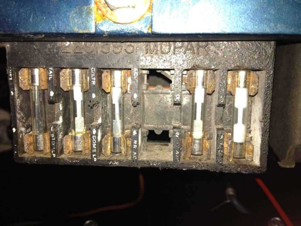

thanks, figured out how to post a pic, this is what i have:
Your far right is RADIO/BACKUP, 2ND in is HEATER/AC. The rest of yours is labeled.
