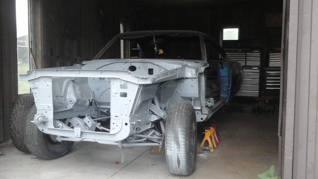

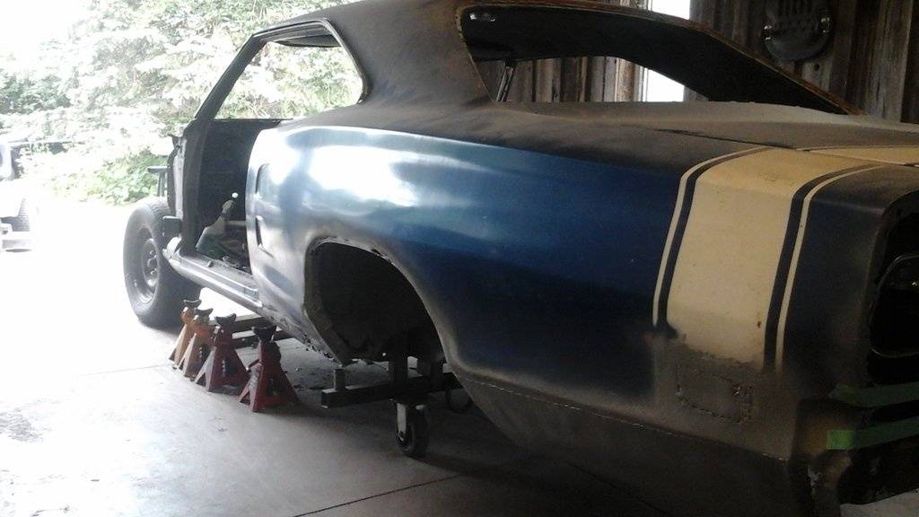

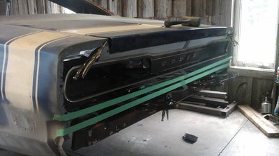

Just for kicks, i did a mockup of my back end without the tail light panel I need to save up for, just so i could squint my eyes and pretend it was intact lol

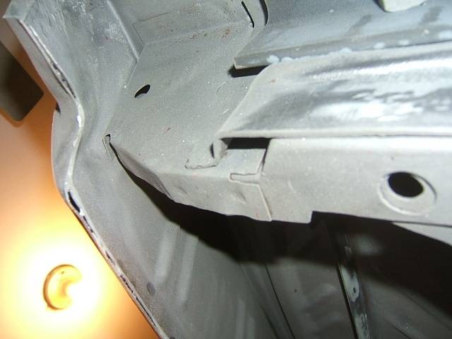

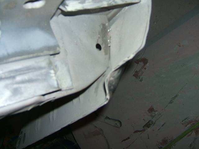

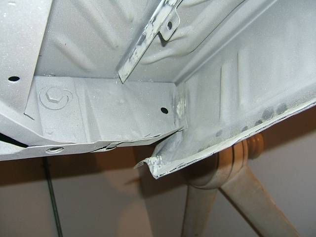

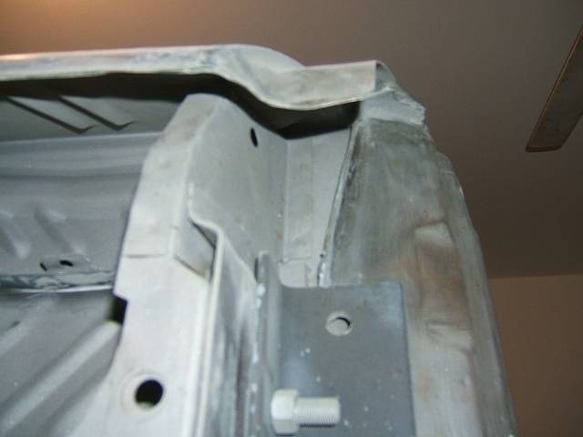

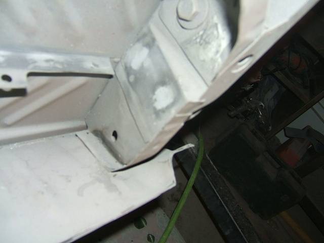

trying to weld the trunk pan in, is there any tricks to getting it to sit flush to the frame rails in order to get a tight weld?
I used clecos on the floor pan but my own weight was enough on the trunk. some guys just use self drilling screws.
I've used self drilling screws with great results.
