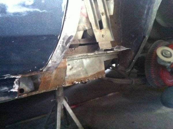

Back to the topic of sheetmetal patches, I really don't like making homeade patches. Using stamped factoy or re-pop parts ends up with a better outcome, imo. Thanks for the info on the drain holes I never noticed that before.
Honestly... if the area to patch is just right below the body line, I wouldn't buy a molded piece, but simply a home made patch will make perfectly the job. No molded areas there more that just the curved on wheel opening, easy to make. Check the thread I posted from dodgecharger.com making exactly the same section it seems you'll be needing.
I can be agreed on get a molded piece going up to half of the quarter skin, but not below the lower body line. But of course that's just a personal opinion.
The inner rocker area pics from my car still needed to be polished on some areas. The primer on it was just to protect the area, but of course the welding seam wasn't finished yet

Found the pic of all the rocker inner area cut.
Must to say this area was already “salvaged” by a previous body job by another guy who didn’t care about correctness. So we were rebuilding over a badly made previous area. So the sheetmetal made was based on the pics I posted previouslly and not on the actual piece on car.
My car has being a victim job after job of a bad bodymen who never take care of correctness and allways was needing a new fix on that area. Never took care of drains so the rust appeared once and again every 3 years or so. Every time, cuting a larger piece. Up to now, get allmost a full skin. When I bought it, maybe needed a patch quite similar ( bit larger maybe ) than actually your car
It is posible and not really hard to do. Mostly sure you won’t need to get that far, bu just showing that going THAT far is posible, on an easier job even more
