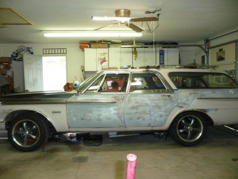

A 1962 Fury wagon, 318 Polysphere engine ,3.23 gears, and 27" tall tires.. just a weekend cruiser..no plans to race. Those days are behind me :)
I would use the higher stall 10 3/4" converter, but likely hard to find for early 19 spline input shaft. Stall speed is a variable thing, based on engine power. I think a 318 would stall at the lower end of the converter rating. With a heavier car like your wagon, the engine could use some help to get it moving, like letting it rev up a little more on launch. With 3.23 gears, you would be running around 2400-2500 rpm. at 60 mph. cruise. The converter stall would be all in at that speed, so little effect on gas mileage.
From what I've found, the car should weigh 3600-3650, as for the 19 spline thing. I have the parts to update to 24 spline system. So if I update the splines in the trans, I would need to get a converter (reason for asking my question)
