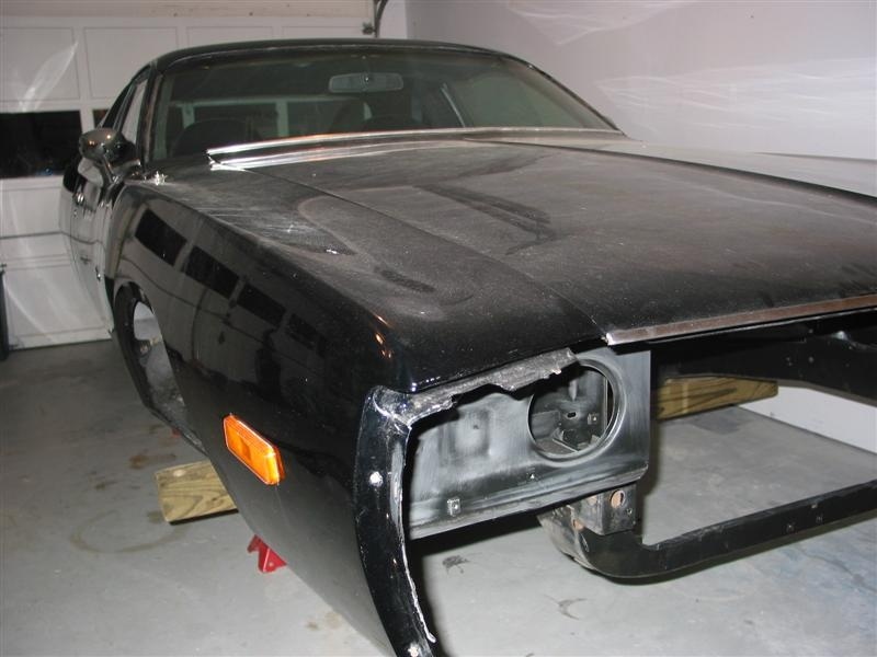

We had the car on the road in April 1997. I then drove the car for about three months before losing my driving license for speeding. Then I kept driving it for another three months. You can say I wasn't a very smart kid for doing that. Then on a random day in October of 1997, I decided I wanted to lower the rear with lowering blocks. However, the car had ISO clamps. One thing lead to another and before we knew it the car was completely torn apart.

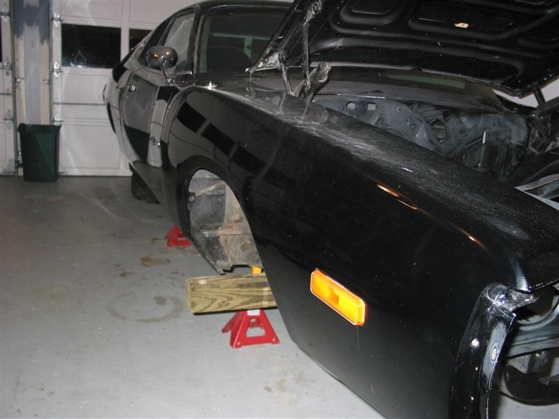

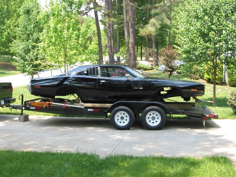

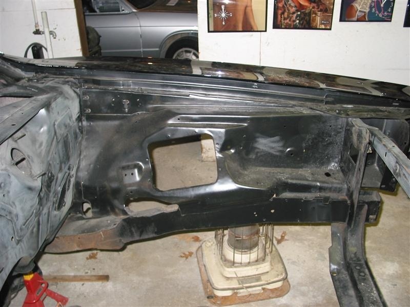

Here's the car sitting in the my dad's basement. It sat here from October 1997 until October 2003

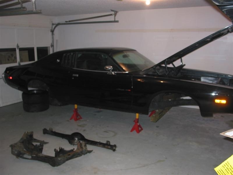

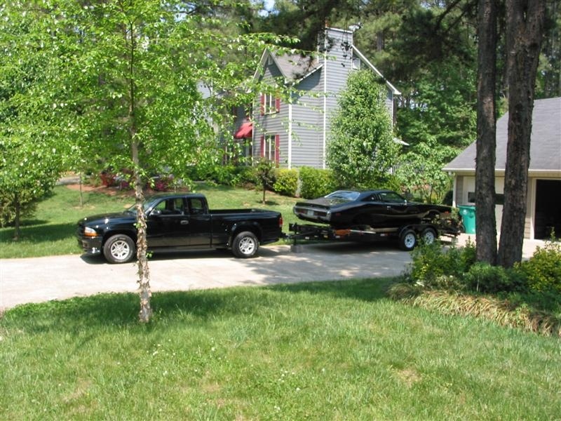

Moving to Kennesaw, GA October 2003

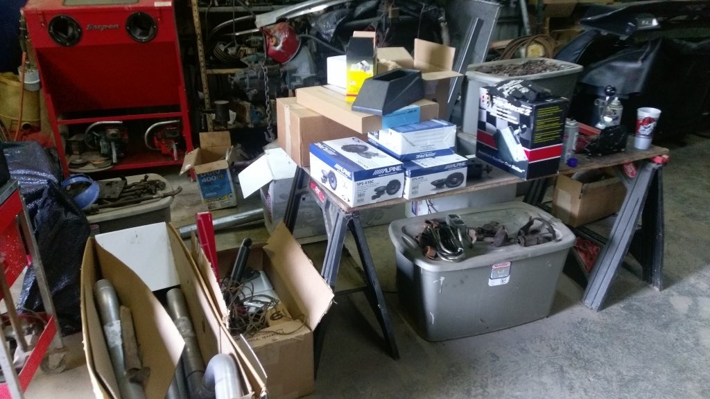

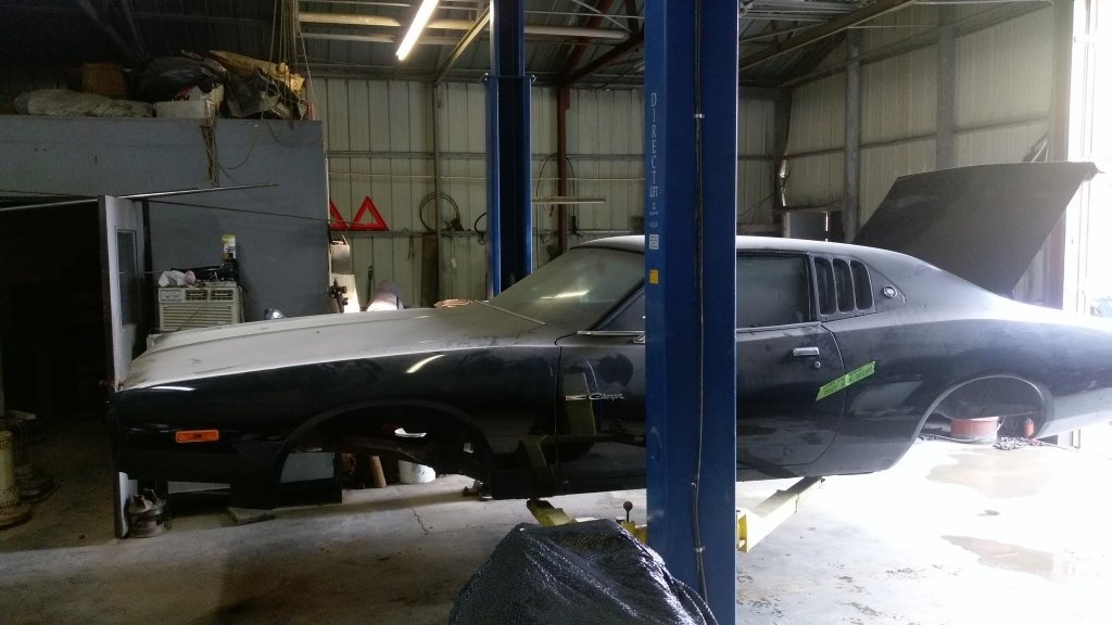

  • Location: On a two post lift in Alabama
  • Front Suspension: Bushings, ball joints installed; all parts blasted and paint. Ready to be installed.
  • Rear Axle: Needs painting.
  • Under body: Tar based undercoating to be scraped off then refinish the metal
  • Exhaust: 3" Summit kit with Hedman Headers; needs new hangers welded to body
  • Engine: 383 bored 60 over. Ready to be built. Stock rebuild.
  • 727 Transmission: Rebuilt and ready to be installed
  • Interior: Front seat covers needs recovering, rear seat needs to be repaired with new foam
  • Brake: Stock disc and drums. All parts order and ready to be installed. Old lines to reused.
  • Fuel: New pump, old tank, old lines, might need new sending unit
  • Stereo: Head unit: Alpine CDE-153BT; Front: Alpine Type S 6.5 component; Rear: Type S 6x9; No amp or sub.
  • Steering: New tie rod ends; power steering box rebuilt, need painting. Steering column needs replacing. Who has one?

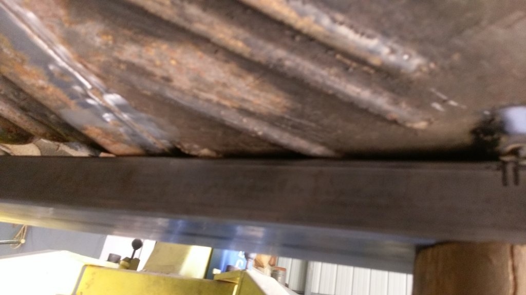

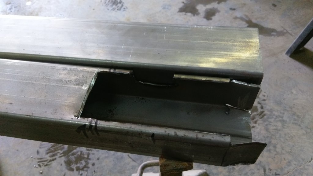

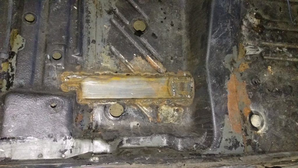

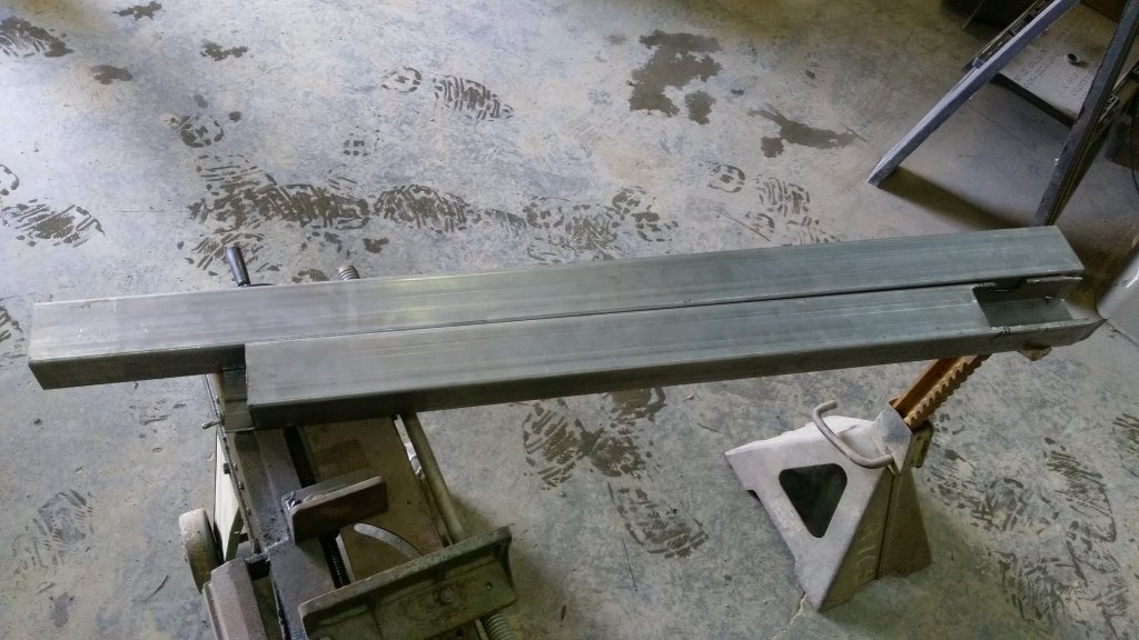

I went to Summit racing today to buy engine mounts, valley pan gasket, and two 2x3 square tube stock. It was an important trip because I forgot to order those parts weeks ago. We left North Atlanta at 5 o'clock and got back at 10pm. Gotta love Atlanta traffic. The square stock will be used for subframe connectors. Basically, I'm going to notch the rear, cut through the floor, weld the floor to the square tube, then weld the front to a plate welded to the transmission cross brace. The steel is rated at 4500 to deflect 1mm. NASCAR style tire changes anyone?

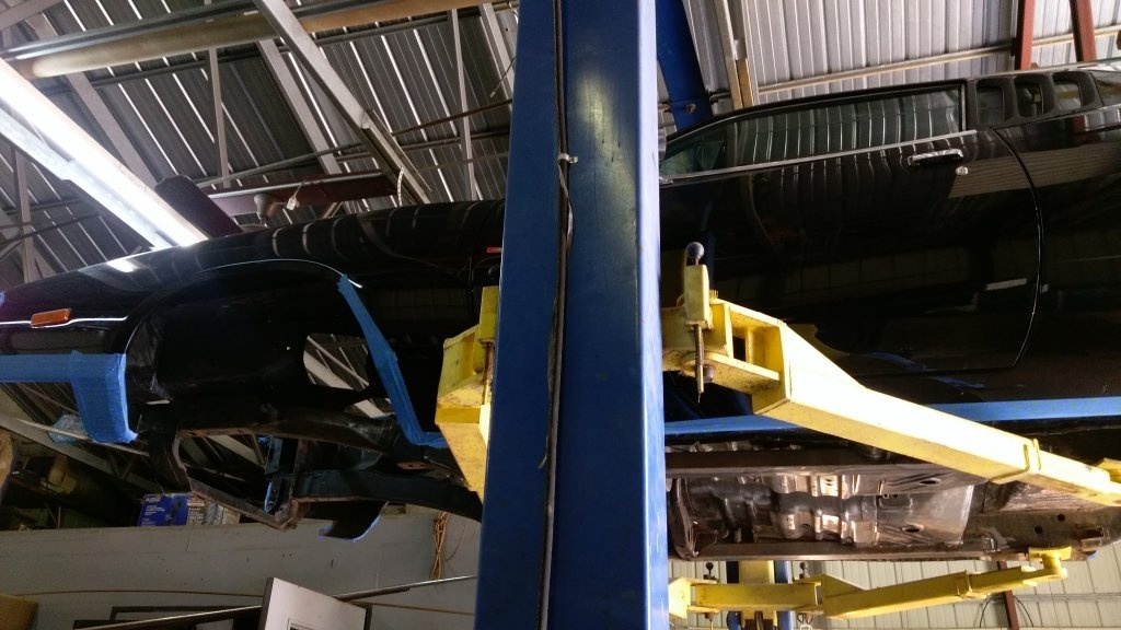

There she is. Yes, the shop is very dirty ND unorganized but it has very tool imagined. Even a lathe and milling machine.

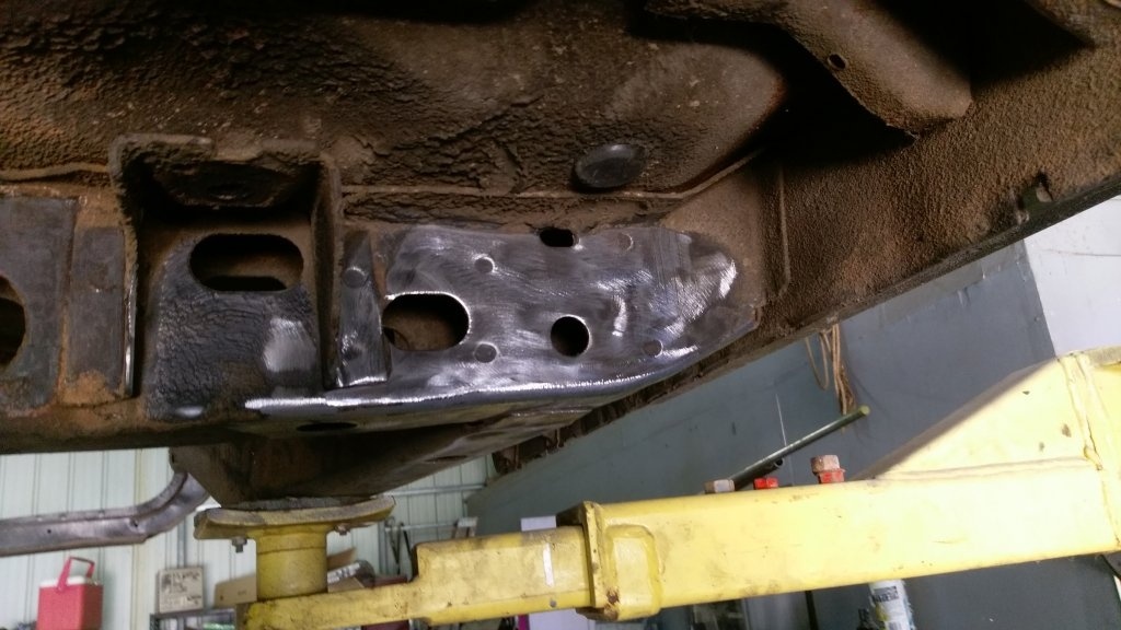

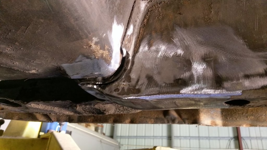

  • Sub-frame connectors fabricated and welded in. I used 3x2 inch .083 walled cold formed box stock. I had to notch around the rail on the outside but we boxed it from the top at the rear. The rail isn't welded on the top at the front but I think it will be fine.

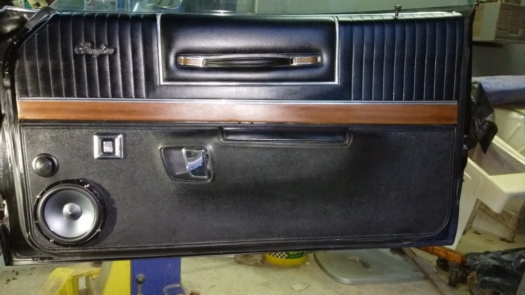

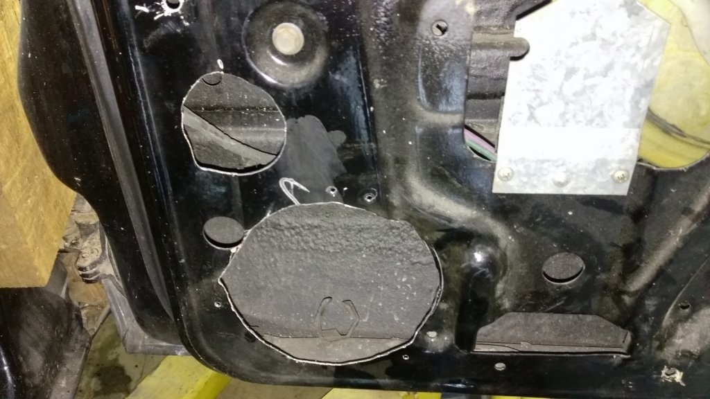

  • Speakers hole cut. I know... it's a classic Mopar, why you hack the doors? Well, it's my car. I had it for nearly 21 years and I plan to keep it forever. This isn't a factory restore which I can do what I want with it! Plus, I think I did a dang good job. My next project, a '71 Roadrunner, will be a factory restore. I won't even think about hacking the doors like that.

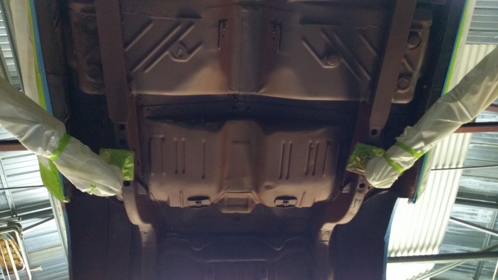

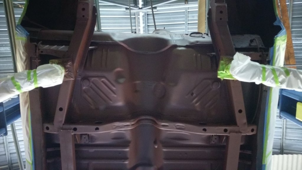

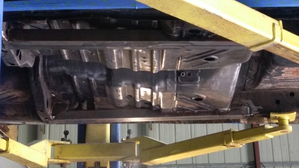

  • The floor pan clean. Yippy! I had enough over head torch and scraping, grinding, wheel wheel, sander, wire brush, torch, tooth pick, sanding, wire wheel, wire brush, and five minutes to put on dust mask, eyes, ears, and gloves. Next, time I'm having the car acid dipped and zinc plated!

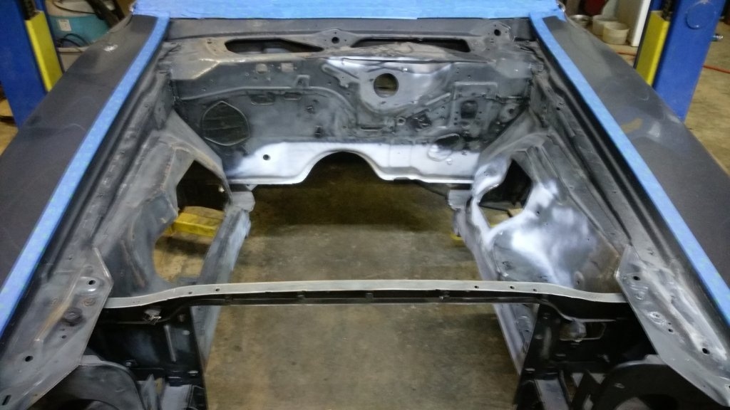

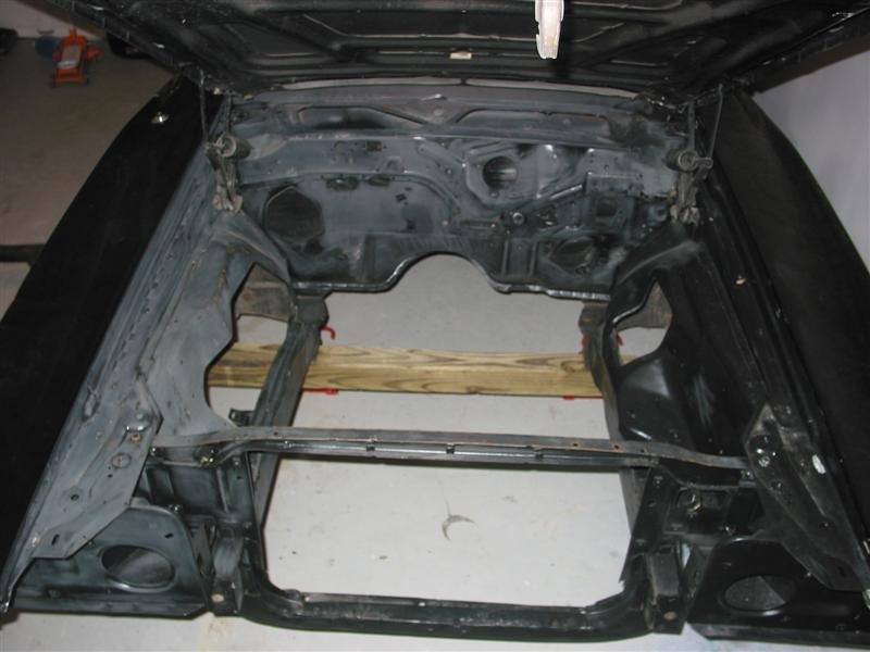

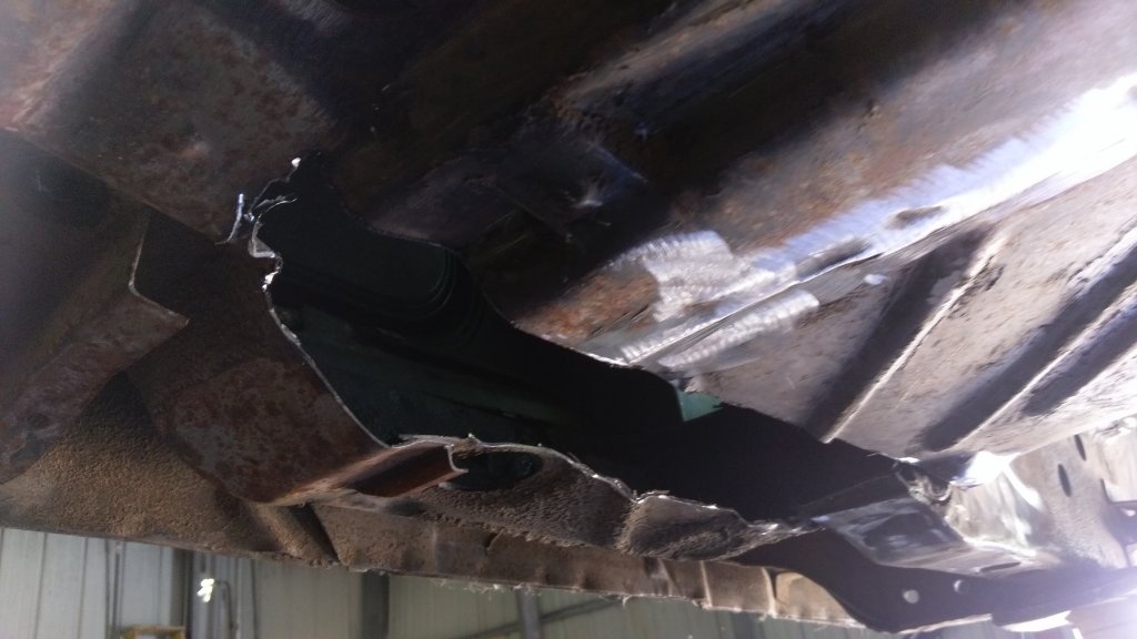

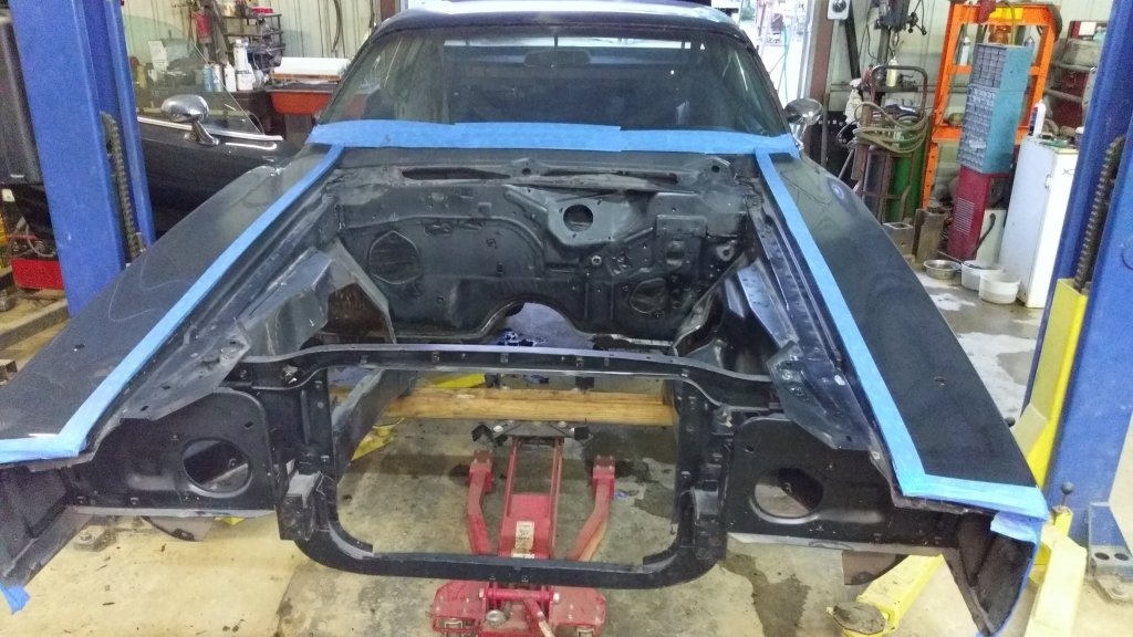

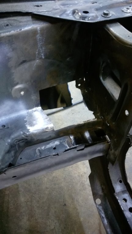

  • Working on the engine bay. The left fender needs a lot of help at the top. The inner fender had a hole under the battery tray. My dad plans to fab up a replacement panel tomorrow.
  • Painting should happen on Saturday. I was hoping to get the car on the ground but the sub-frame rails took two days. Oh, well/

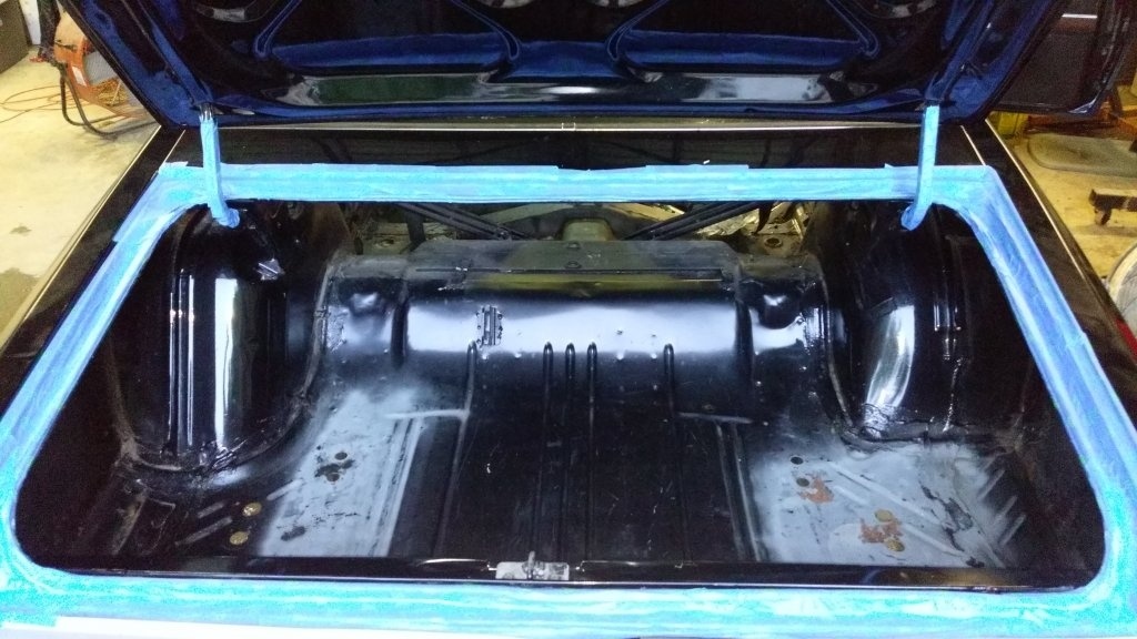

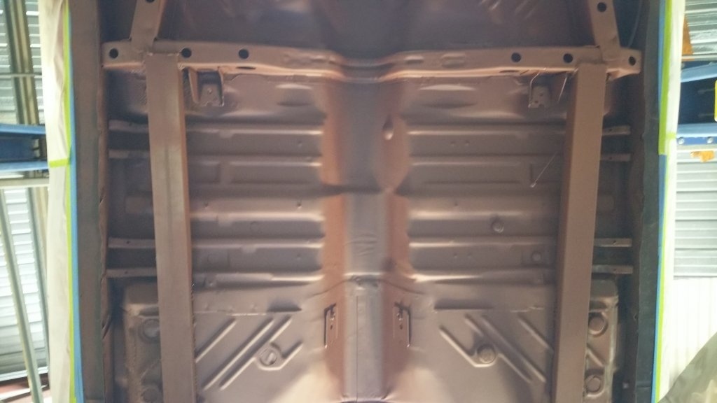

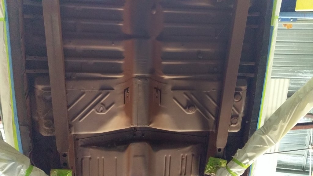

The under body is primed. Next steps: touch up some spot, seam seal, then paint. After that, it's build the engine, run brake line, gas line, and the rear end.
